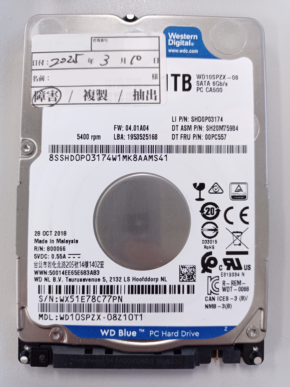

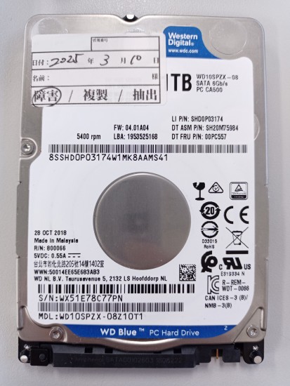

hello guys does anyone have the firmware for this HDD???
i got this case witht he drive spins but get ID and Capacity
i guess is firmware related problem so i blocked the SA access and tried to load another loader of but the donor is not 100% identical
i could backup all modules.... 190 seems ok
tried to rebuild rom modules
tried to edid HDD ID but after turn off is the same status...no ID and NO capacity...
on kernel mode i got Module 02 uploading..................... : Statc Mdl writing error Device Error Detected: "VSC ERR STATIC FILE INVALID" error
in normal mode i got SA Access check in RAM.................. : Static module reading error Device Error Detected: "VSC ERR INV FUNC CODE REQ"
Zone allocation table................... : HDDs RAM reading error Device Error Detected: "VSCE PERM OVL NOT LOADED. LDR Upload is recomended"
does someone got a similar case?
any help will be very apreciated

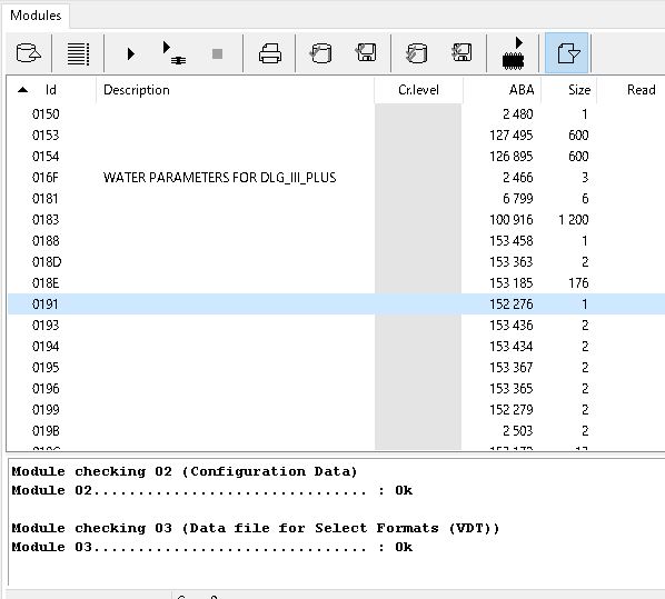

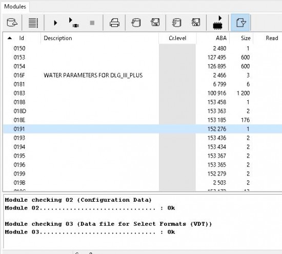

Data-Salvage wrote:
what did you experience with LBA access?
hello what did you mean Sir?
Incremental read error.................. : Module 190 not found
there no module 190.... when i uploar dir on he ram... first time i got this kind of issue.....
 Post subject: Re: WD10SPZX-08Z10T1 firmware needed
PostPosted: March 19th, 2025, 11:32
Posts: 4816
PostPosted: March 19th, 2025, 11:46
Joined: November 28th, 2021, 22:35
Posts: 162
Location: japan
if i upload the original dir the modulel 189 and 190 doesnt show up
if i upload dir of donor ,modules 189 and 190 show up but freeze when i try to backup
