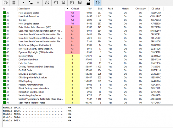

Hi everyone. I have a drive that came in knocking. I have changed the heads and the drive comes in RDY however when got BSY when ID
I then proceeded to do Slow Responding Fix. Which did Upload LDR and module 02 normally. I backed up All SA modules. And tested which all gave green
However as soon as i Allow SA access and restart the drive. The drive hangs on BSY upon ID again
Can anyone help me out with this issue?? Many Thanks!!!
 Post subject: Re: WD10JPVX Still got BSY after Slow Responding Fix
PostPosted: March 26th, 2025, 1:36
Posts: 4854
NN | Step | Time | Flags | Info | Description
19 | 105 | 12.31 s | 3F | 5104370F | EXEC_POWERUP_LOAD_DIR_DATA(FM ERR HEADER II SIGNATURE INVALID)
46 | 105 | 12.68 s | 13F | 5104370F | EXEC_POWERUP_LOAD_DIR_DATA(FM ERR HEADER II SIGNATURE INVALID)
check:
-if dir module is ok (probably coz pc3k inited itself from it, did it?)
-if dir address is ok in the active flash dir
-if active flash dir is ok

well the problem was the heads after all. Even after swapping new pair of heads. The platter still killed those heads for no reason. Not sure how all Modules checked are green and the drive got ready normally
