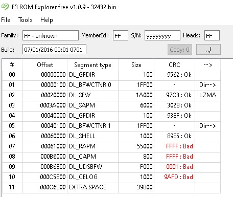

i got this disk ST4000DM000 2AE166-300 WF 0001 with damaged rom
terminal report always bad CRC Seg:0x06
no way to regen new F3 rom right ? anyone here can check rom and if is possible to patch with a donor rom
i try with donor rom attached but result in crc error
32432-donor.zip [542.32 KiB]
Downloaded 482 times
32432.zip [554.97 KiB]
Downloaded 476 times

Hello, the problem is that some pages are erased from B3000-B6FFF, CAP is completely busted, and the end of RAP too. CAP is not an issue, but RAP is, that block contains some data but i'm not sure if that's something critical, i should check...

I have attached the repaired RAP. It was recovered from Extra Space.
I can try to build a new ROM with parts from your donor, unless anyone has a better idea.

yeah, i didn't notice that part is also present at higher addr.

I have repaired and patched the ROM.

All I did was repair the RAP using the partial copy in the Extra Space, and then replace the CAP, UDSBFW and CELOG with the donor's. The latter two segments were clear in the donor ROM, but the patient's segments contained data. You could dump the ROM again and reexamine the UDSBFW and CELOG segments.

In the corrupt ROM, the UDSBFW segment has been shifted downward by 0x800 bytes, and its last 0x800 bytes have overwritten the CELOG segment. I have extracted and attached the correct (?) version of this segment.
There are a couple of areas containing 0xBEEF. I don't know what this means.

It would be interesting to see whether the latest ROM dump has the same corruption.
