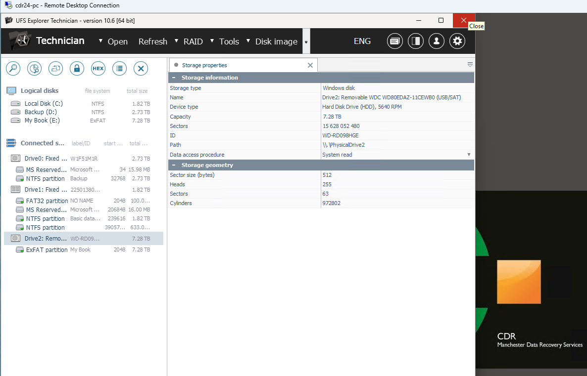

I've worked on a few WD80EDAZ, but I've just received in a WD80EDBZ with failed heads. These disks look largely similar to each other, but the EDBZ has a higher spindle motor speed.
Has anyone tried changing the heads between them to see if there is cross-compatibility?

Yes, they work
But they are both 7200rpm
You might want to add numbers and letters after the dash in the model name for a better identification.

Many of WD's "5400 RPM class" HDDs are just crippled versions of their 7200 RPM models.

The reason I thought the WD80EDAZ has a lower spindle speed was because UFS Explorer was reporting it at 5640 RPM, see screenshot with a EDAZ via USB. However, thanks to your and Fzabkar's information and a quick Google search I can see that WD have had some issues where the EDAZ drives reported spindle speed is not necessarily what it appears.

There are different WD80EDAZ models
WD80EDAZ-11TA3A0 - HGST Vela-AP, 7200 rpm, CMR
WD80EDAZ-11CEWB0 - WD Avalon RP, 5640 rpm, SMR (CMR emulation)
They use the same hardware, heads are compatible.
But your WD80EDBZ is likely an HGST model, these drives are hard to deal with, simple head replacement usually does not work.
