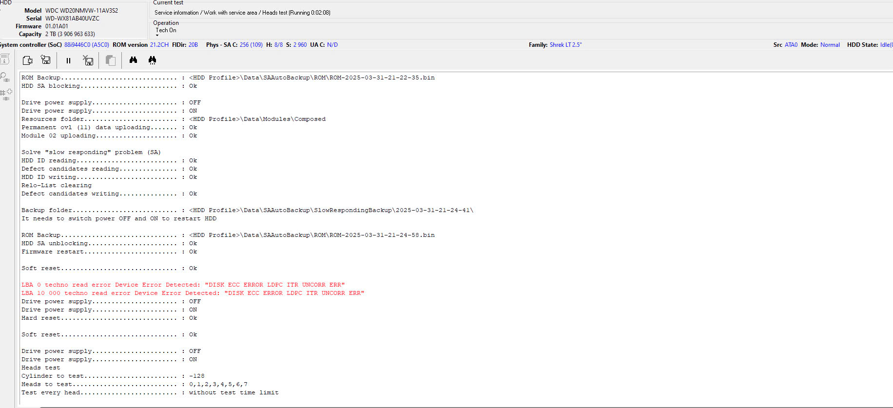

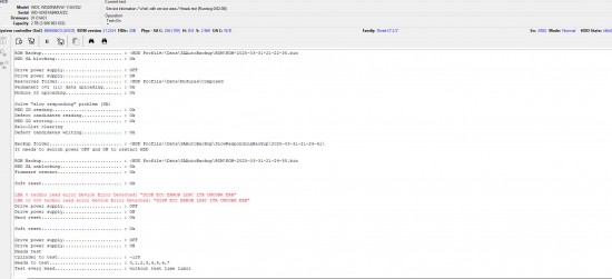

Comes fully ready. No clicking sounds. But cannot access data. i have tested all the heads. backed up all modules. All critical modules seems to be fine but other ones has checksum error and criticical heads error
It shows
Error W: 1480 on every head
So my guess it was the head problem> So i changed the heads with 100% fully functional new donor
It still give me the same exact issues
Cannot access data
Does anyone know the issue?? Can anybody help me out?

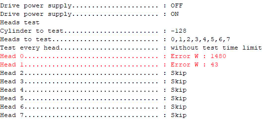

Here are the head test after changing the heads
Heads test
Cylinder to test........................ : -128
Heads to test........................... : 0,1,2,3,4,5,6,7
Test every head......................... : without test time limit
Head 0.................................. : Error W : 1480
Head 1.................................. : Error W : 1480
Head 2.................................. : Skip
Head 3.................................. : Skip
Head 4.................................. : Skip
Head 5.................................. : Skip
Head 6.................................. : Skip
Head 7.................................. : Skip

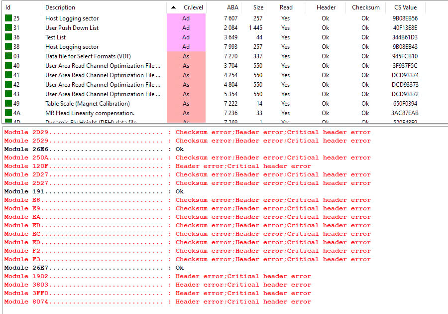

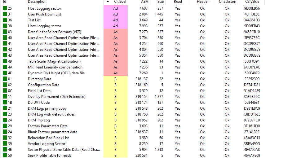

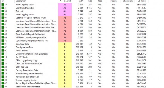

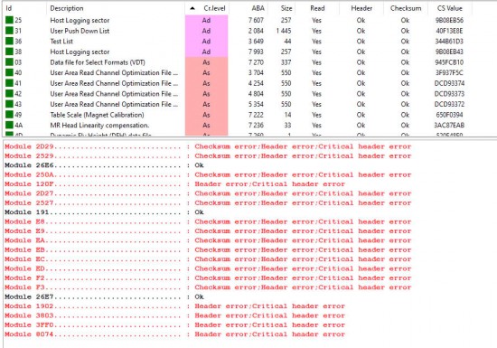

Here are the module checking in SA after swapping fully functional heads
Modules checking
Module 01............................... : Ok
Module 35............................... : Ok
Module 12E.............................. : Ok
Module 102.............................. : Ok
Module 103.............................. : Ok
Module 104.............................. : Ok
Module 105.............................. : Ok
Module 106.............................. : Ok
Module 108.............................. : Ok
Module 02............................... : Ok
Module 1B............................... : Ok
Module 411.............................. : Ok
Module 2F............................... : Ok
Module 2A............................... : Ok
Module 21............................... : Ok
Module 23............................... : Ok
Module 24............................... : Ok
Module 11............................... : Ok
Module 50............................... : Ok
Module 51............................... : Ok
Module 52............................... : Ok
Module 53............................... : Ok
Module 109.............................. : Ok
Module 6E............................... : Ok
Module 116.............................. : Ok
Module 118.............................. : Ok
Module AC55............................. : Ok
Module 4002............................. : Ok
Module 6D............................... : Ok
Module 122.............................. : Ok
Module 81............................... : Ok
Module 147.............................. : Ok
Module 149.............................. : Ok
Module 12B.............................. : Ok
Module 80FC............................. : Ok
Module 33............................... : Ok
Module 31............................... : Ok
Module 0C............................... : Ok
Module 34............................... : Ok
Module 32............................... : Ok
Module 36............................... : Ok
Module 29............................... : Ok
Module 40............................... : Ok
Module 41............................... : Ok
Module 42............................... : Ok
Module 43............................... : Ok
Module 4E............................... : Ok
Module 49............................... : Ok
Module 4A............................... : Ok
Module 4D............................... : Ok
Module 03............................... : Ok
Module 25............................... : Ok
Module 26............................... : Ok
Module 38............................... : Ok
Module 39............................... : Ok
Module 37............................... : Ok
Module 2D............................... : Header error
Module 2E............................... : Header error
Module 6B............................... : Ok
Module 3A............................... : Ok
Module 28............................... : Ok
Module 3B............................... : Ok
Module 3C............................... : Ok
Module 3D............................... : Ok
Module 3E............................... : Ok
Module 3F............................... : Ok
Module 6F............................... : Ok
Module 16F.............................. : Ok
Module 119.............................. : Ok
Module 68............................... : Ok
Module 69............................... : Ok
Module 6A............................... : Ok
Module 121.............................. : Ok
Module 128.............................. : Ok
Module 12A.............................. : Ok
Module 120.............................. : Ok
Module 12D.............................. : Header error
Module 22D.............................. : Header error
Module 132.............................. : Ok
Module 14A.............................. : Ok
Module 131.............................. : Checksum error;Header error;Critical header error
Module 123.............................. : Ok
Module 124.............................. : Ok
Module 125.............................. : Ok
Module 126.............................. : Ok
Module D002............................. : Ok
Module D003............................. : Ok
Module D004............................. : Ok
Module D005............................. : Ok
Module D000............................. : Ok
Module D001............................. : Ok
Module 127.............................. : Ok
Module D006............................. : Ok
Module 62............................... : Ok
Module 63............................... : Ok
Module 115.............................. : Ok
Module 3700............................. : Checksum error;Header error
Module DE............................... : Checksum error;Header error;Critical header error
Module B6............................... : Checksum error;Header error;Critical header error
Module D5............................... : Checksum error;Header error;Critical header error
Module 34D5............................. : Checksum error;Header error;Critical header error
Module 3426............................. : Checksum error;Header error;Critical header error
Module 3424............................. : Checksum error;Header error;Critical header error
Module 3425............................. : Checksum error;Header error;Critical header error
Module 3431............................. : Checksum error;Header error;Critical header error
Module 3430............................. : Checksum error;Header error;Critical header error
Module 3411............................. : Checksum error;Header error;Critical header error
Module D1............................... : Checksum error;Header error;Critical header error
Module 3513............................. : Checksum error;Header error;Critical header error
Module 34D1............................. : Checksum error;Header error;Critical header error
Module 34D2............................. : Checksum error;Header error;Critical header error
Module 34D3............................. : Checksum error;Header error;Critical header error
Module 34D4............................. : Checksum error;Header error;Critical header error
Module 34D6............................. : Checksum error;Header error;Critical header error
Module 34D8............................. : Checksum error;Header error;Critical header error
Module 34D7............................. : Checksum error;Header error;Critical header error
Module DB............................... : Checksum error;Header error;Critical header error
Module DF............................... : Checksum error;Header error;Critical header error
Module DD............................... : Checksum error;Header error;Critical header error
Module 3514............................. : Checksum error;Header error;Critical header error
Module 3309............................. : Checksum error;Header error;Critical header error
Module 3310............................. : Checksum error;Header error;Critical header error
Module 3311............................. : Checksum error;Header error;Critical header error
Module 3312............................. : Checksum error;Header error;Critical header error
Module 3413............................. : Checksum error;Header error;Critical header error
Module 3414............................. : Checksum error;Header error;Critical header error
Module 3429............................. : Checksum error;Header error;Critical header error
Module 3402............................. : Checksum error;Header error;Critical header error
Module D7............................... : Checksum error;Header error;Critical header error
Module 3300............................. : Checksum error;Header error;Critical header error
Module 3301............................. : Checksum error;Header error;Critical header error
Module 3307............................. : Checksum error;Header error;Critical header error
Module 3303............................. : Checksum error;Header error;Critical header error
Module 3500............................. : Checksum error;Header error;Critical header error
Module BB............................... : Checksum error;Header error;Critical header error
Module 3400............................. : Checksum error;Header error;Critical header error
Module 3407............................. : Checksum error;Header error;Critical header error
Module 3405............................. : Checksum error;Header error;Critical header error
Module D9............................... : Checksum error;Header error;Critical header error
Module D4............................... : Checksum error;Header error;Critical header error
Module 3305............................. : Checksum error;Header error;Critical header error
Module DC............................... : Checksum error;Header error;Critical header error
Module D0............................... : Checksum error;Header error;Critical header error
Module D3............................... : Checksum error;Header error;Critical header error
Module F7............................... : Checksum error;Header error;Critical header error
Module BA............................... : Checksum error;Header error;Critical header error
Module 3406............................. : Checksum error;Header error;Critical header error
Module B9............................... : Checksum error;Header error;Critical header error
Module BC............................... : Checksum error;Header error;Critical header error
Module 3417............................. : Checksum error;Header error;Critical header error
Module D8............................... : Checksum error;Header error;Critical header error
Module BD............................... : Checksum error;Header error;Critical header error
Module BE............................... : Checksum error;Header error;Critical header error
Module 3401............................. : Checksum error;Header error;Critical header error
Module 3302............................. : Checksum error;Header error;Critical header error
Module 3304............................. : Checksum error;Header error;Critical header error
Module 3501............................. : Checksum error;Header error;Critical header error
Module 3502............................. : Checksum error;Header error;Critical header error
Module 3416............................. : Checksum error;Header error;Critical header error
Module 3F01............................. : Header error;Critical header error
Module B8............................... : Header error;Critical header error
Module BF............................... : Header error;Critical header error
Module 34E7............................. : Header error;Critical header error
Module 3802............................. : Header error;Critical header error
Module B7............................... : Ok
Module FA............................... : Ok
Module FC............................... : Ok
Module FD............................... : Ok
Module EE............................... : Ok
Module 3E00............................. : Ok
Module 3801............................. : Checksum error;Header error;Critical header error
Module 3C00............................. : Ok
Module 3423............................. : Checksum error;Header error;Critical header error
Module 3422............................. : Checksum error;Header error;Critical header error
Module 3511............................. : Checksum error;Header error;Critical header error
Module 3421............................. : Checksum error;Header error;Critical header error
Module 3503............................. : Checksum error;Header error;Critical header error
Module 3F00............................. : Checksum error;Header error;Critical header error
Module 3504............................. : Checksum error;Header error;Critical header error
Module 3408............................. : Checksum error;Header error;Critical header error
Module 3605............................. : Checksum error;Header error;Critical header error
Module 3551............................. : Checksum error;Header error;Critical header error
Module 3703............................. : Checksum error;Header error;Critical header error
Module E7............................... : Ok
Module C5............................... : Checksum error;Header error;Critical header error
Module 2401............................. : Checksum error;Header error;Critical header error
Module 2403............................. : Checksum error;Header error;Critical header error
Module 2404............................. : Checksum error;Header error;Critical header error
Module 2420............................. : Checksum error;Header error;Critical header error
Module 2407............................. : Checksum error;Header error;Critical header error
Module 2408............................. : Checksum error;Header error;Critical header error
Module 2409............................. : Checksum error;Header error;Critical header error
Module 2410............................. : Checksum error;Header error;Critical header error
Module 2428............................. : Checksum error;Header error;Critical header error
Module 242F............................. : Checksum error;Header error;Critical header error
Module 240C............................. : Checksum error;Header error;Critical header error
Module 241E............................. : Checksum error;Header error;Critical header error
Module 241F............................. : Checksum error;Header error;Critical header error
Module 2414............................. : Checksum error;Header error;Critical header error
Module 240B............................. : Checksum error;Header error;Critical header error
Module 2413............................. : Checksum error;Header error;Critical header error
Module 240A............................. : Checksum error;Header error;Critical header error
Module 241D............................. : Checksum error;Header error;Critical header error
Module 240E............................. : Checksum error;Header error;Critical header error
Module 2422............................. : Checksum error;Header error;Critical header error
Module 2427............................. : Checksum error;Header error;Critical header error
Module 2423............................. : Checksum error;Header error;Critical header error
Module 2415............................. : Checksum error;Header error;Critical header error
Module 2424............................. : Checksum error;Header error;Critical header error
Module 241A............................. : Checksum error;Header error;Critical header error
Module 2429............................. : Checksum error;Header error;Critical header error
Module 242A............................. : Checksum error;Header error;Critical header error
Module 242C............................. : Checksum error;Header error;Critical header error
Module 242B............................. : Checksum error;Header error;Critical header error
Module 242D............................. : Checksum error;Header error;Critical header error
Module 2425............................. : Checksum error;Header error;Critical header error
Module 242E............................. : Checksum error;Header error;Critical header error
Module 2433............................. : Checksum error;Header error;Critical header error
Module 2432............................. : Checksum error;Header error;Critical header error
Module 8010............................. : Checksum error;Header error;Critical header error
Module 802C............................. : Header error;Critical header error
Module 8035............................. : Header error;Critical header error
Module 8038............................. : Checksum error;Header error;Critical header error
Module 803C............................. : Checksum error;Header error;Critical header error
Module 8016............................. : Checksum error;Header error;Critical header error
Module 801D............................. : Checksum error;Header error;Critical header error
Module 8044............................. : Header error;Critical header error
Module 8031............................. : Header error;Critical header error
Module 8062............................. : Header error;Critical header error
Module 8063............................. : Header error;Critical header error
Module 8041............................. : Critical header error
Module 8042............................. : Critical header error
Module 800E............................. : Checksum error;Header error;Critical header error
Module 802D............................. : Checksum error;Header error;Critical header error
Module 8019............................. : Checksum error;Header error;Critical header error
Module 802F............................. : Checksum error;Header error;Critical header error
Module 8034............................. : Checksum error;Header error;Critical header error
Module 802E............................. : Checksum error;Header error;Critical header error
Module 8032............................. : Checksum error;Header error;Critical header error
Module 8017............................. : Checksum error;Header error;Critical header error
Module 8002............................. : Checksum error;Header error;Critical header error
Module 800B............................. : Checksum error;Header error;Critical header error
Module 8005............................. : Checksum error;Header error;Critical header error
Module 8020............................. : Checksum error;Header error;Critical header error
Module 8046............................. : Checksum error;Header error;Critical header error
Module 8045............................. : Checksum error;Header error;Critical header error
Module 8027............................. : Checksum error;Header error;Critical header error
Module 8014............................. : Checksum error;Header error;Critical header error
Module 801C............................. : Checksum error;Header error;Critical header error
Module 8023............................. : Checksum error;Header error;Critical header error
Module 801F............................. : Checksum error;Header error;Critical header error
Module 803A............................. : Checksum error;Header error;Critical header error
Module 803E............................. : Checksum error;Header error;Critical header error
Module 8012............................. : Checksum error;Header error;Critical header error
Module 8026............................. : Checksum error;Header error;Critical header error
Module 802B............................. : Header error;Critical header error
Module 8029............................. : Header error;Critical header error
Module 802A............................. : Header error;Critical header error
Module 8037............................. : Header error;Critical header error
Module 803B............................. : Header error;Critical header error
Module 800F............................. : Header error;Critical header error
Module 800A............................. : Header error;Critical header error
Module 8025............................. : Header error;Critical header error
Module 8009............................. : Header error;Critical header error
Module 800C............................. : Header error;Critical header error
Module 8006............................. : Header error;Critical header error
Module 8018............................. : Header error;Critical header error
Module 800D............................. : Header error;Critical header error
Module 8008............................. : Header error;Critical header error
Module 8024............................. : Header error;Critical header error
Module 8015............................. : Header error;Critical header error
Module 8007............................. : Header error;Critical header error
Module 8065............................. : Header error;Critical header error
Module 801A............................. : Header error;Critical header error
Module 8030............................. : Header error;Critical header error
Module 801E............................. : Checksum error;Header error;Critical header error
Module 8001............................. : Header error;Critical header error
Module 8022............................. : Header error;Critical header error
Module 8064............................. : Header error;Critical header error
Module 8049............................. : Header error;Critical header error
Module 805D............................. : Checksum error;Header error;Critical header error
Module 805E............................. : Checksum error;Header error;Critical header error
Module 805F............................. : Header error;Critical header error
Module 8060............................. : Header error;Critical header error
Module 8061............................. : Header error;Critical header error
Module 8011............................. : Header error;Critical header error
Module 803F............................. : Header error;Critical header error
Module 8040............................. : Header error;Critical header error
Module 8033............................. : Header error;Critical header error
Module 8043............................. : Header error;Critical header error
Module 8000............................. : Header error;Critical header error
Module 8021............................. : Header error;Critical header error
Module 8FFC............................. : Header error;Critical header error
Module 8FFD............................. : Header error;Critical header error
Module 8FFE............................. : Header error;Critical header error
Module 8047............................. : Header error;Critical header error
Module 8048............................. : Header error;Critical header error
Module 8004............................. : Header error;Critical header error
Module 8003............................. : Header error;Critical header error
Module 8028............................. : Header error;Critical header error
Module 8039............................. : Header error;Critical header error
Module 803D............................. : Header error;Critical header error
Module 8036............................. : Header error;Critical header error
Module 801B............................. : Header error;Critical header error
Module 8013............................. : Header error;Critical header error
Module 804C............................. : Header error;Critical header error
Module 804D............................. : Header error;Critical header error
Module 804E............................. : Header error;Critical header error
Module 804F............................. : Header error;Critical header error
Module 804A............................. : Header error;Critical header error
Module 804B............................. : Header error;Critical header error
Module 8050............................. : Header error;Critical header error
Module 8051............................. : Header error;Critical header error
Module 8052............................. : Header error;Critical header error
Module 8053............................. : Header error;Critical header error
Module 8054............................. : Header error;Critical header error
Module 8055............................. : Header error;Critical header error
Module 8056............................. : Header error;Critical header error
Module 8057............................. : Header error;Critical header error
Module 8058............................. : Header error;Critical header error
Module 8059............................. : Header error;Critical header error
Module 805A............................. : Header error;Critical header error
Module 805B............................. : Header error;Critical header error
Module 805C............................. : Header error;Critical header error
Module 8066............................. : Header error;Critical header error
Module 8067............................. : Header error;Critical header error
Module 8068............................. : Header error;Critical header error
Module 8069............................. : Header error;Critical header error
Module 806A............................. : Header error;Critical header error
Module 806B............................. : Ok
Module 806C............................. : Header error;Critical header error
Module 806D............................. : Header error;Critical header error
Module 806E............................. : Header error;Critical header error
Module 1000............................. : Checksum error;Header error;Critical header error
Module B1............................... : Checksum error;Header error;Critical header error
Module B2............................... : Checksum error;Header error;Critical header error
Module 1001............................. : Checksum error;Header error;Critical header error
Module 1002............................. : Checksum error;Header error;Critical header error
Module 1009............................. : Checksum error;Header error;Critical header error
Module 100A............................. : Checksum error;Header error;Critical header error
Module 1003............................. : Checksum error;Header error;Critical header error
Module 100C............................. : Checksum error;Header error;Critical header error
Module 1005............................. : Checksum error;Header error;Critical header error
Module 100F............................. : Checksum error;Header error;Critical header error
Module 1004............................. : Checksum error;Header error;Critical header error
Module 1007............................. : Checksum error;Header error;Critical header error
Module 100B............................. : Checksum error;Header error;Critical header error
Module 100E............................. : Checksum error;Header error;Critical header error
Module 1011............................. : Checksum error;Header error;Critical header error
Module 1008............................. : Checksum error;Header error;Critical header error
Module 1010............................. : Checksum error;Header error;Critical header error
Module 3604............................. : Ok
Module 806F............................. : Ok
Module 80FF............................. : Ok
Module 80FE............................. : Ok
Module 8108............................. : Ok
Module 1500............................. : Ok
Module 1501............................. : Ok
Module 1502............................. : Ok
Module 1503............................. : Ok
Module 1101............................. : Ok
Module 1504............................. : Ok
Module 1505............................. : Ok
Module 1506............................. : Ok
Module 1507............................. : Ok
Module 1508............................. : Ok
Module 1509............................. : Ok
Module 150A............................. : Ok
Module 150B............................. : Ok
Module 150C............................. : Ok
Module 150D............................. : Ok
Module 150E............................. : Ok
Module 150F............................. : Ok
Module 1100............................. : Ok
Module 1205............................. : Ok
Module 1121............................. : Ok
Module 2D13............................. : Ok
Module 2513............................. : Ok
Module 2FF0............................. : Checksum error;Header error;Critical header error
Module 9A............................... : Header error;Critical header error
Module 2D03............................. : Checksum error;Header error;Critical header error
Module 2503............................. : Checksum error;Header error;Critical header error
Module 2D04............................. : Header error;Critical header error
Module 2E00............................. : Ok
Module 2504............................. : Ok
Module 2D20............................. : Checksum error;Header error;Critical header error
Module 2640............................. : Ok
Module 2641............................. : Ok
Module 2642............................. : Ok
Module 2643............................. : Ok
Module 2644............................. : Ok
Module 2645............................. : Ok
Module 2646............................. : Ok
Module 2647............................. : Ok
Module 26D0............................. : Checksum error;Header error;Critical header error
Module 2D07............................. : Checksum error;Header error;Critical header error
Module 2520............................. : Checksum error;Header error;Critical header error
Module 26D1............................. : Checksum error;Header error;Critical header error
Module 26D2............................. : Checksum error;Header error;Critical header error
Module 26D3............................. : Checksum error;Header error;Critical header error
Module 26D4............................. : Checksum error;Header error;Critical header error
Module 26D5............................. : Checksum error;Header error;Critical header error
Module 26D6............................. : Checksum error;Header error;Critical header error
Module 26D7............................. : Checksum error;Header error;Critical header error
Module 2507............................. : Checksum error;Header error;Critical header error
Module 2D14............................. : Checksum error;Header error;Critical header error
Module 2670............................. : Checksum error;Header error;Critical header error
Module 2671............................. : Checksum error;Header error;Critical header error
Module 2672............................. : Checksum error;Header error;Critical header error
Module 2673............................. : Checksum error;Header error;Critical header error
Module 2674............................. : Checksum error;Header error;Critical header error
Module 2675............................. : Checksum error;Header error;Critical header error
Module 2676............................. : Checksum error;Header error;Critical header error
Module 2677............................. : Checksum error;Header error;Critical header error
Module 2514............................. : Checksum error;Header error;Critical header error
Module 252C............................. : Checksum error;Header error;Critical header error
Module 13F1............................. : Header error;Critical header error
Module 2D2C............................. : Checksum error;Header error;Critical header error
Module 2D2D............................. : Checksum error;Header error;Critical header error
Module 26E0............................. : Ok
Module 2D0B............................. : Checksum error;Header error;Critical header error
Module 2D2A............................. : Checksum error;Header error;Critical header error
Module 26E1............................. : Ok
Module 26E2............................. : Ok
Module 13F5............................. : Ok
Module B5............................... : Header error;Critical header error
Module 2D1E............................. : Checksum error;Header error;Critical header error
Module 251E............................. : Checksum error;Header error;Critical header error
Module E6............................... : Header error;Critical header error
Module E0............................... : Header error;Critical header error
Module E1............................... : Header error;Critical header error
Module E2............................... : Header error;Critical header error
Module E3............................... : Header error;Critical header error
Module E4............................... : Header error;Critical header error
Module E5............................... : Header error;Critical header error
Module F0............................... : Header error;Critical header error
Module F1............................... : Header error;Critical header error
Module 1903............................. : Ok
Module 2D09............................. : Checksum error;Header error;Critical header error
Module 2509............................. : Checksum error;Header error;Critical header error
Module 2D0C............................. : Checksum error;Header error;Critical header error
Module 2690............................. : Checksum error;Header error;Critical header error
Module 2691............................. : Checksum error;Header error;Critical header error
Module 2692............................. : Checksum error;Header error;Critical header error
Module 2693............................. : Checksum error;Header error;Critical header error
Module 2694............................. : Checksum error;Header error;Critical header error
Module 2695............................. : Checksum error;Header error;Critical header error
Module 2696............................. : Checksum error;Header error;Critical header error
Module 2697............................. : Header error;Critical header error
Module 250C............................. : Checksum error;Header error;Critical header error
Module 1102............................. : Header error;Critical header error
Module 1800............................. : Header error;Critical header error
Module 1810............................. : Header error;Critical header error
Module 1801............................. : Checksum error;Header error;Critical header error
Module 1811............................. : Checksum error;Header error;Critical header error
Module 1802............................. : Checksum error;Header error;Critical header error
Module 1812............................. : Checksum error;Header error;Critical header error
Module 1803............................. : Checksum error;Header error;Critical header error
Module 1813............................. : Checksum error;Header error;Critical header error
Module 1804............................. : Checksum error;Header error;Critical header error
Module 1814............................. : Checksum error;Header error;Critical header error
Module 66............................... : Checksum error;Header error;Critical header error
Module ADDD............................. : Checksum error;Header error;Critical header error
Module FE............................... : Header error;Critical header error
Module 2D22............................. : Checksum error;Header error;Critical header error
Module 252A............................. : Checksum error;Header error;Critical header error
Module 3C10............................. : Header error;Critical header error
Module 3C20............................. : Checksum error;Header error;Critical header error
Module 3C11............................. : Header error;Critical header error
Module 3C21............................. : Checksum error;Header error;Critical header error
Module 3C12............................. : Header error;Critical header error
Module 3C22............................. : Checksum error;Header error;Critical header error
Module 3C13............................. : Header error;Critical header error
Module 3C23............................. : Checksum error;Header error;Critical header error
Module 3C14............................. : Checksum error;Header error;Critical header error
Module 3C24............................. : Checksum error;Header error;Critical header error
Module 3C15............................. : Header error;Critical header error
Module 3C25............................. : Checksum error;Header error;Critical header error
Module 3C16............................. : Checksum error;Header error;Critical header error
Module 3C26............................. : Checksum error;Header error;Critical header error
Module 3C17............................. : Header error;Critical header error
Module 3C27............................. : Header error;Critical header error
Module 3E01............................. : Header error;Critical header error
Module 3F04............................. : Header error;Critical header error
Module 3F03............................. : Header error;Critical header error
Module 1410............................. : Header error;Critical header error
Module 2D0A............................. : Checksum error;Header error;Critical header error
Module 250B............................. : Checksum error;Header error;Critical header error
Module 26E3............................. : Ok
Module 26E4............................. : Ok
Module 26E5............................. : Ok
Module 252D............................. : Checksum error;Header error;Critical header error
Module 2D0E............................. : Checksum error;Header error;Critical header error
Module 250E............................. : Checksum error;Header error;Critical header error
Module 2D1F............................. : Checksum error;Header error;Critical header error
Module 251F............................. : Checksum error;Header error;Critical header error
Module 1400............................. : Header error;Critical header error
Module 2522............................. : Checksum error;Header error;Critical header error
Module 2D29............................. : Checksum error;Header error;Critical header error
Module 2529............................. : Checksum error;Header error;Critical header error
Module 26E6............................. : Ok
Module 250A............................. : Checksum error;Header error;Critical header error
Module 120F............................. : Header error;Critical header error
Module 2D27............................. : Checksum error;Header error;Critical header error
Module 2527............................. : Checksum error;Header error;Critical header error
Module 191.............................. : Ok
Module E8............................... : Checksum error;Header error;Critical header error
Module E9............................... : Checksum error;Header error;Critical header error
Module EA............................... : Checksum error;Header error;Critical header error
Module EB............................... : Checksum error;Header error;Critical header error
Module EC............................... : Checksum error;Header error;Critical header error
Module ED............................... : Checksum error;Header error;Critical header error
Module F2............................... : Checksum error;Header error;Critical header error
Module F3............................... : Checksum error;Header error;Critical header error
Module 26E7............................. : Ok
Module 1902............................. : Header error;Critical header error
Module 3803............................. : Header error;Critical header error
Module 3FF0............................. : Header error;Critical header error
Module 8074............................. : Header error;Critical header error
 Post subject: Re: WDC WD20NMVW Ready but no data access
PostPosted: March 31st, 2025, 18:44
Posts: 4808
was Dir loaded from file or from HDD? If from file, it might not be the right one...
PostPosted: April 1st, 2025, 7:27
Posts: 261
Location: Vietnam
dir loaded from HDD
PostPosted: April 1st, 2025, 17:19
Posts: 17216
I can't help you, but I'm curious about the difference between "Header error" and "Critical header error". Would you mind uploading your drive's resources?
PostPosted: April 1st, 2025, 17:29
Posts: 1773
Location: Phoenix, AZ USA
Did you try switching all head off in RAM and reading one at a time. So...
First try 00000000 and read from H0 only
Then 11111111 and read from H1.
Rinse and repeat.
PostPosted: April 2nd, 2025, 5:35
Posts: 4808
Rinse and repeat.
don't do that, it can be quite destructive, and i see no point in this case...
check if sa defect list is ok and native. i suspect some shift in sa but it needs to be verified.
PostPosted: April 2nd, 2025, 10:11
Posts: 17216
Module 0x8041 is actually module 0x8009.
Offset(h) 00   02   04   06   08   0A   0C   0E
00000000  524F 594C 0300 3000 0980 0200 54DE 26A1  ROYL..0..€..TÞ&¡
                              ID = 0x8009
00000010  3634 3137 0000 0000 0C0F 0E00 0000 0000  6417............
Module 0xB8 is zero filled. Checksum is 0x00000000.
00000000  00 00 00 00 00 00 00 00 00 00 00 00 00 00 00 00  ................
00000010  00 00 00 00 00 00 00 00 00 00 00 00 00 00 00 00  ................
Module 0xB6 is filled with data, but has no header.
00000000  00 0C 70 47 F7 B5 04 00 0E 00 88 B0 00 27 0A 98
00000010  23 F0 30 EC 06 90 0A 98 21 F0 DF F8 05 00 4B 21
Module 0x22D has correct checksum, but consists of 0x26 sectors whereas the header says 2 sectors.
00000000  524F 594C 0100 3000 2D02 0200 5BE1 3E25  ROYL..0.-...[á>%
                                   size is 2 sectors
00000010  3030 3032 3030 3034 0000 0000 0000 0000  00020004........
00004BE0  1010 32F3 206D 69E5 1064 21F0 A91F A163
00004BF0  9870 35B6 C454 200C A2F0 1770 2071 E960
PostPosted: April 3rd, 2025, 4:24
Joined: February 18th, 2020, 9:35
Posts: 75
Location: Ukraina
gameboybin wrote:
gold6565 wrote:
gameboybin wrote:
Rinse and repeat.
I am giving this a try
How do you connect it to PC 3000? Sata or USB . If SATA, what board are you using?
I am using Sata board 771960
SA SPT.................................. : 2960
Is the ROM original?
PostPosted: April 3rd, 2025, 6:08
Posts: 4808
yeah, SaSpt of 2960 seems insane... 1480 is fine
PostPosted: April 3rd, 2025, 10:58
Posts: 1773
Unless I am missing something, W: 1480 is the number of write errors from a PC3K head test.
PostPosted: April 3rd, 2025, 11:23
Posts: 4808
it is both the spt and the write errors, as 2960 is 2x1480 :)
but honestly idk what it means in the head test, the first error or number of errors, i don't use this feature...
PostPosted: April 3rd, 2025, 13:25
Posts: 17216
FWIW, I have regenerated the ROM from module 0x129.
regrom.7z [237.19 KiB]
Downloaded 359 times
Users browsing this forum: No registered users and 217 guests
