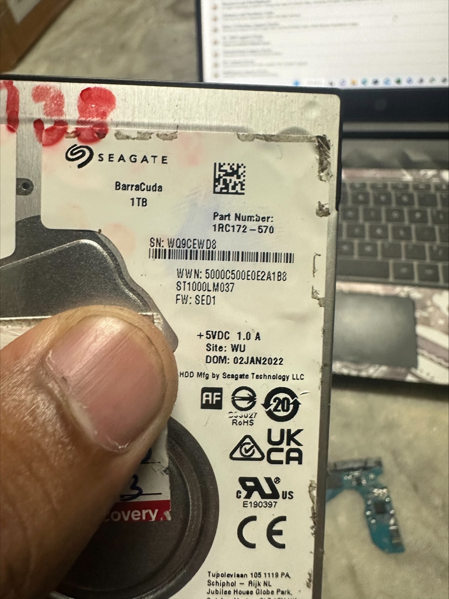

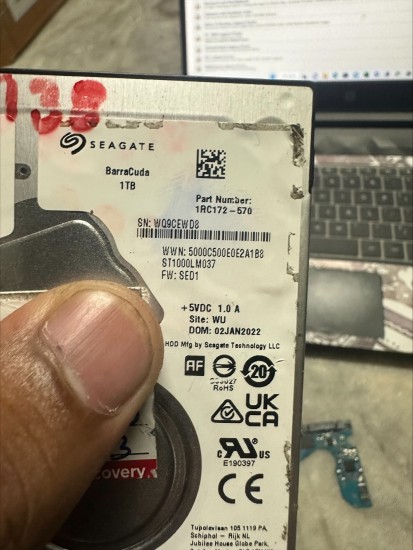

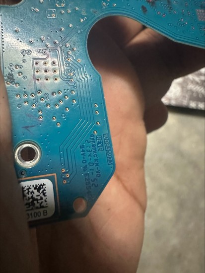

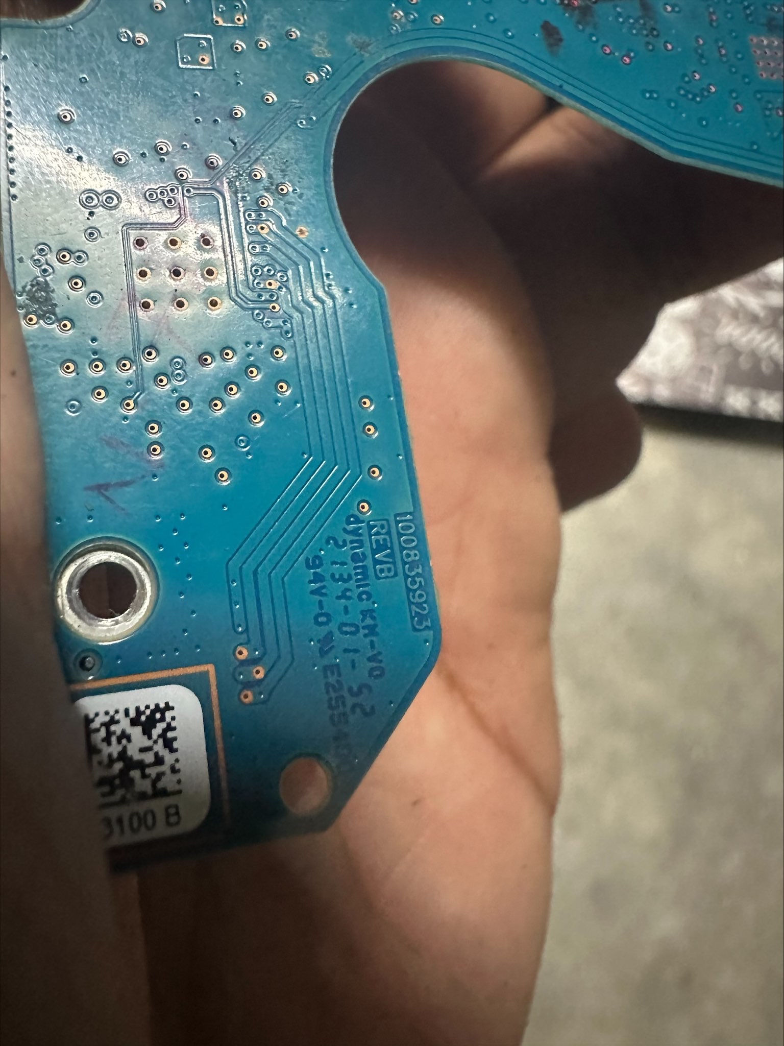

Hi
Got a seagate rosewood drive with sed1 fw version with dom 02jan 2022, rom cannot be read via pc3k or dfl says no bootcode mode found, So read the rom via programmer got the rom file. when i patch the rom via pc3k or dfl latest version , it results in LED:0x000000BB FAddr:0x00004300 in terminal. is there any way to unlock the rom ?. I have asked acelab support they say the model is not supported yet. can anyone help me to unlock the rom for this case. Attached the rom file along with hdd pic and pcb pic.

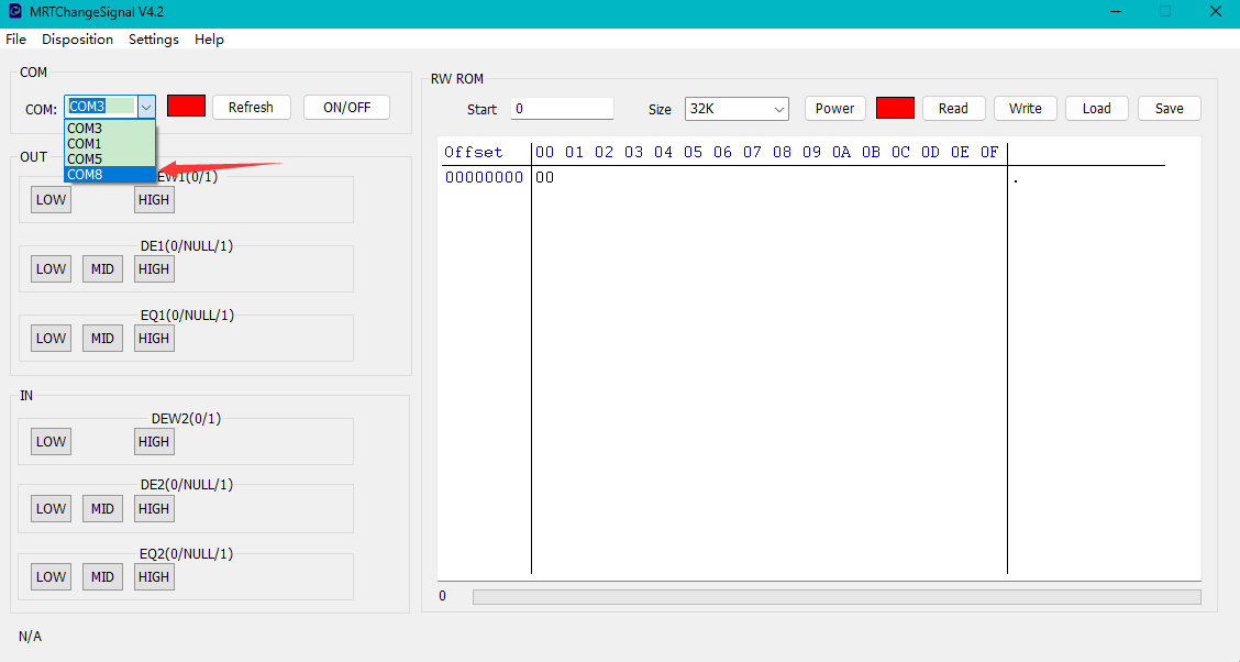

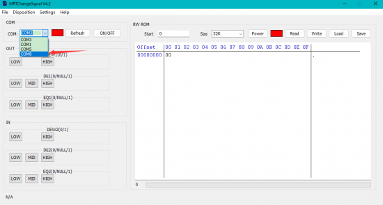

From MRT
MRT SATA Signal Equalizer
http://us.mrtlab.com/news/339.html
http://us.mrtlab.com/news/339_1.html
Regarding Seagate upgrades, it is already known that there are numerous new hard drives with ROMs that cannot be read and written directly. These belong to the AF family and cover some products from 2021 and most products from 2022. Additionally, there are new families starting from family ID 0xCF. We have collected relevant model information, and the next update will provide support for them
