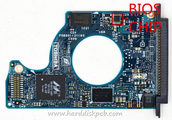

My Toshiba MK6006GAH ZK01 1.8" 60GB drive failed - short inside the Marvell 88i6612-GAB1 CPU :(
Is PCB swap possible on these drives? Tried with PCB from the same model but ZL01 - the drive spins up but does not calibrate.

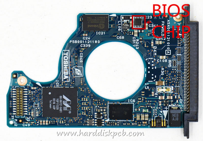

This shows that IC23 should be moved to the new PCB:
https://www.harddiskpcb.com/toshiba-mk6 ... -3393.html
But IC23 does not look like flash or EEPROM. It has Ricoh logo and "A01H" marking. Looks like a DC/DC controller, connected to the nearby coil and diode. Three of the 8 pins are 3.3V, two are GND, one is connected to diode.
Should I try to find a board from ZK01 drive? Or give up?

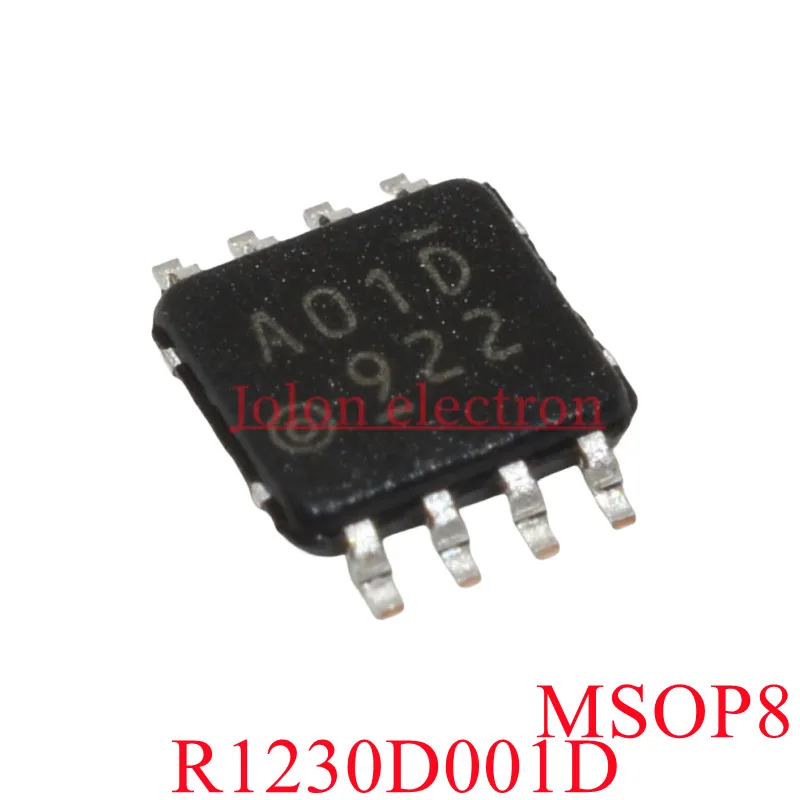

I think IC23 may be a R1230D001H converter, but I'm not confident.
https://pdf.datasheetcatalog.com/datasheets/1150/357691_DS.pdf
https://www.datasheetarchive.com/pdf/download/distributors/Datasheets-29/DSA-562755.pdf?h=87f5b384a7c9d87e5d9848041f04add9%3Ac723dea4f5fb08f43f3b17ea400b821845676cdaa4a2373b15078ae2971ae2fd3286c1a74921e4f75ab9%3A341ed76237640c10f092c00834743749
This is a photo of the "D" version:
https://ae-pic-a1.aliexpress-media.com/kf/S83bdb509e6f14264a21c0f91d75620b5C.jpg
