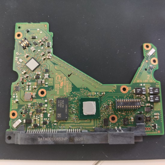

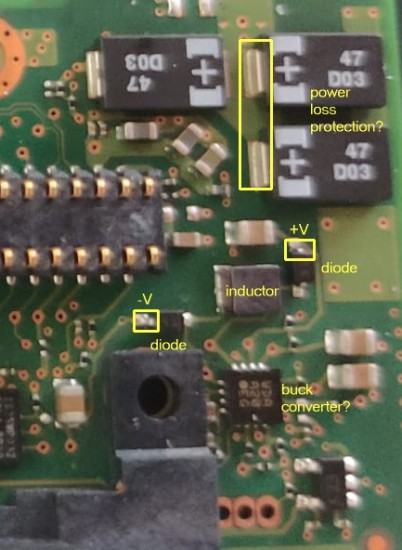

Hey guys, I came across a 18TB Ultrastar helium drive with a bad PCB (no spin). AFAIK on these drives a ROM swap is not enough. I have a donor that I can experiment on, but due to the price of this drives I was wondering if someone already worked on this specific issue.
ROM is a IS25WP032, i have no reader for this format :(
PCB NUMBER: IS: 006-0B44198
Pics attached.

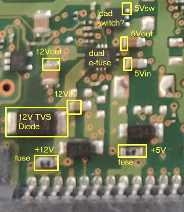

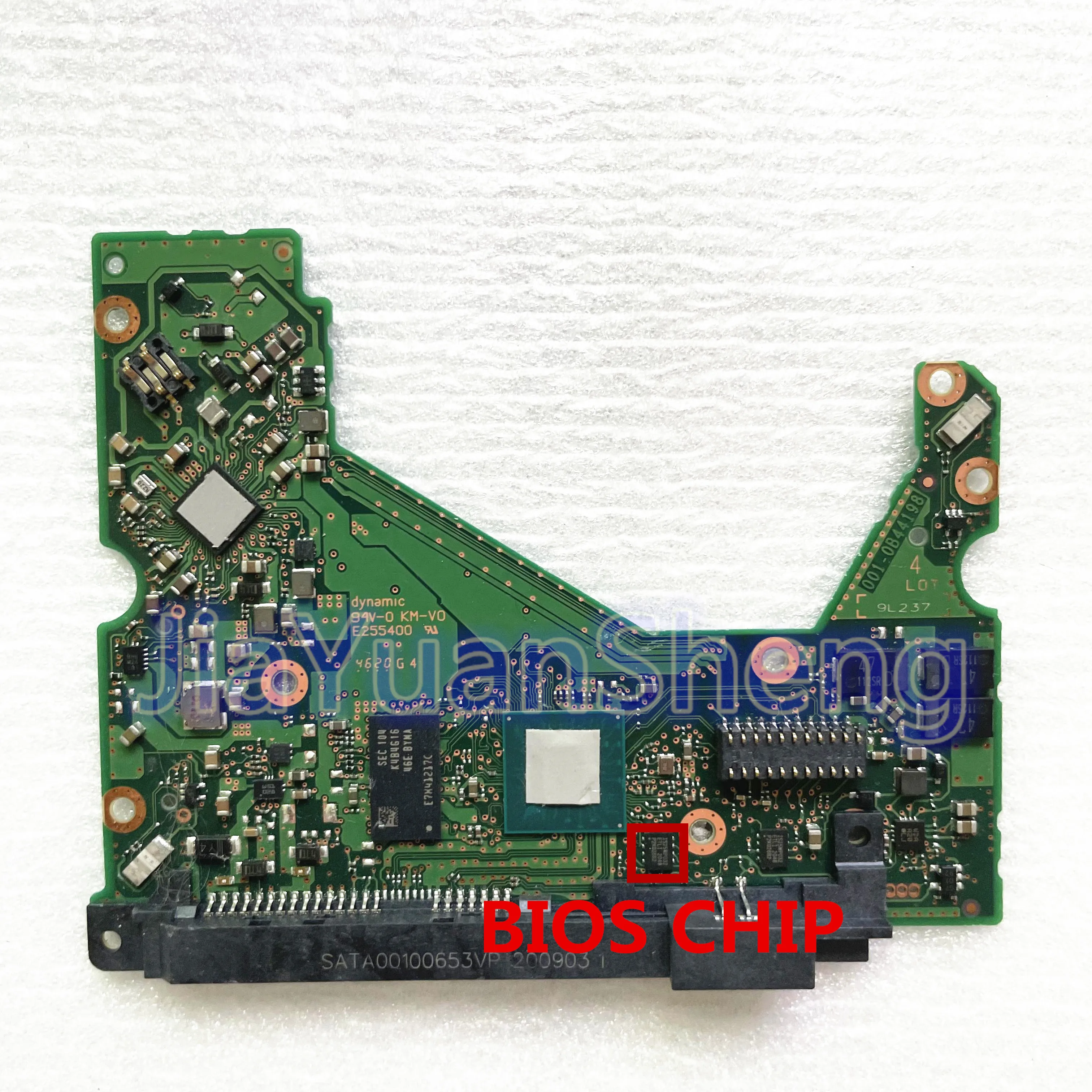

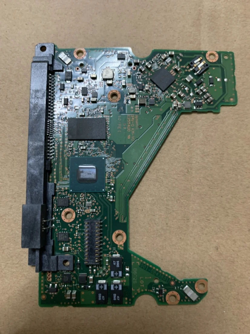

I notice that WD have opted to save 10c by omitting the 5V TVS diode. Instead they are relying on the dual e-fuse (?) to protect the drive from PSU disasters. That's hardly what you would expect from a "Gold" product.
Here are more examples:
https://ae01.alicdn.com/kf/He24c50b109ad43cbba3393b7c6f4b69dm/hard-disk-PCB-board-number-HDD-PCB-board-0B44198-006-0B44198-001-0B44198.jpg
https://ae01.alicdn.com/kf/H38697717660d47738eb0685006e9cf0dC/Western-digital-circuit-board-0B44198-006-0B44198-001-0B44198.jpg

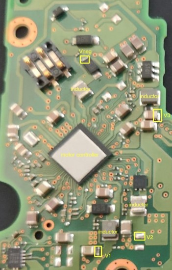

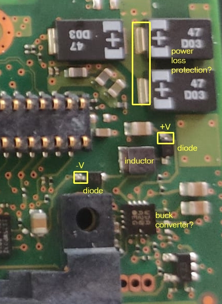

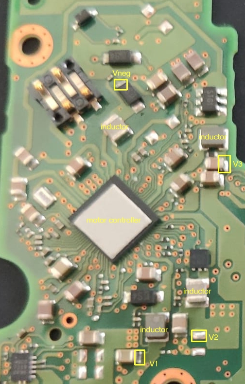

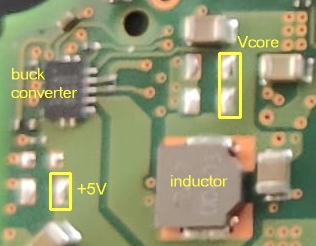

I would measure the following test points.
I'll test them as soon as I get back to the lab tomorrow.
Should dual e-fuse bewave like a blown tvs diode? I mean, would the removal of the dual e-fuse make the drive power on again?
It's a fuse, you'd need to bridge in and out.

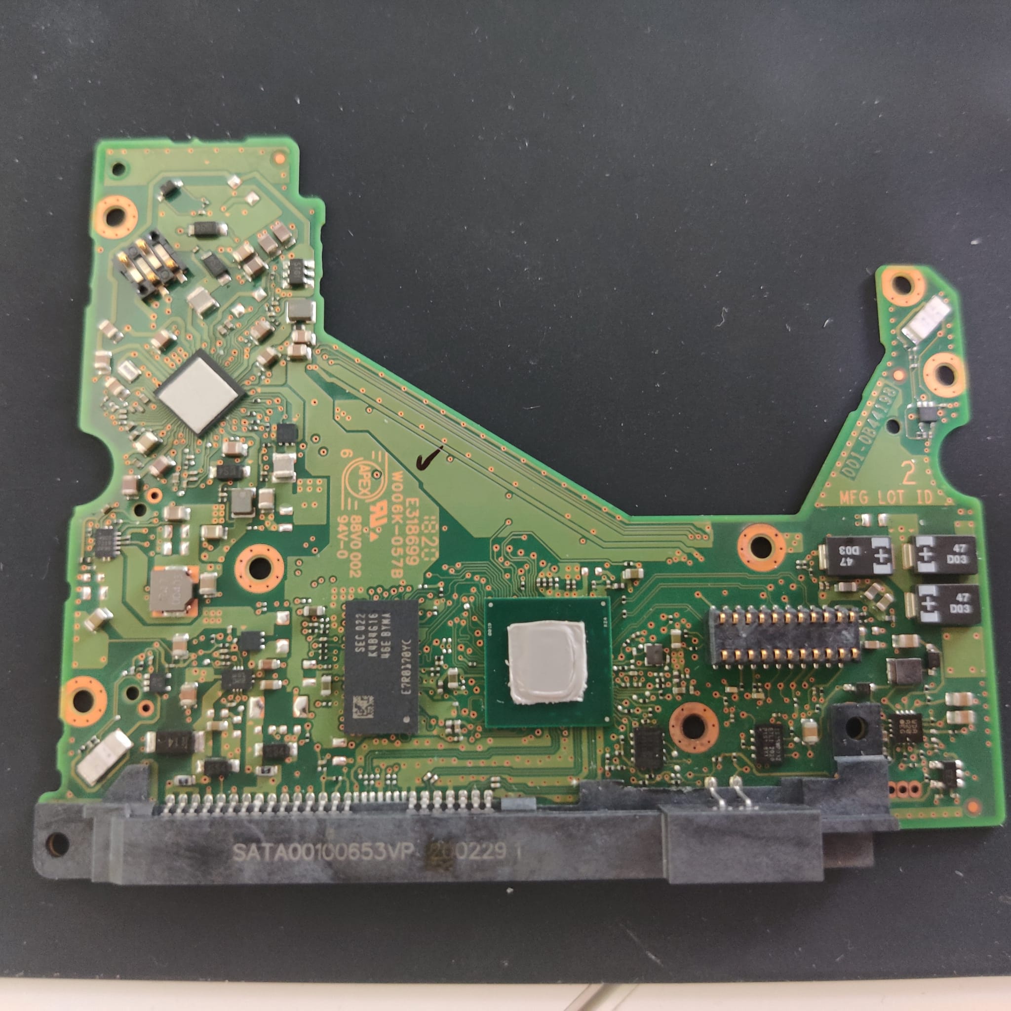

Well, I had to go back to the lab just to swap tasks for the night. I ended up trying to swap the ROM to a donor board and drive does not spin. I'll try to read it with a external programmer...

I have written a tool to parse these ROMs.
http://www.users.on.net/~fzabkar/FreeBasic_W32/Hitachi/
BTW, the PCB appears to have two SPI flash memories.

I've seen on donor pcbs websites that only the left one has the rom.
What do you use to read this package? It's the first time i see it...

I've just realised that my parsing tools expect to see 8Mbit or 16Mbit ROMs, not 32Mbit. I'll rewrite the tool if necessary.
I wonder if the extra ROM is used for power loss data protection. If so, then I wonder what would happen if the donor's cache were to contaminate the patient?
Is the patient drive an SMR model?
If you don't have an appropriate jig for the ROM package, then you might have to hardwire it.

Already done some measurements, both fuses read 0.00V
I'm hoping to be able to swap the rom to a donor board, I just need to figure out what other components will have to be transfered as well.
Volts or ohms?
What about the rest?
