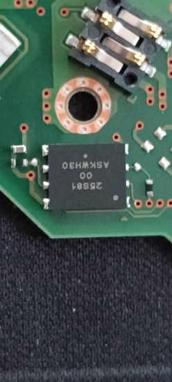

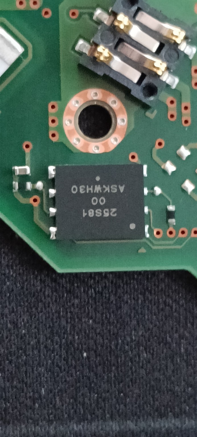

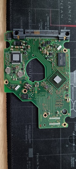

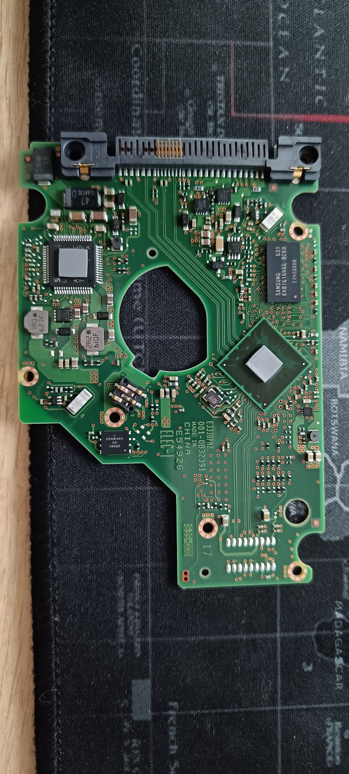

I’ve taken the next step and opened up one of my HUC101890CSS200 drives. I found an 8-pin SOP chip labeled 25S81 00 45KW430, which seems to be the SPI flash containing the firmware/ROM.
I’m planning to try flashing it using a CH341A USB programmer along with a SOP8 clip adapter (like the one from this set: AliExpress Link).
I will attach both PCB photos (full board and close-up of the flash chip) in this thread.
Before I proceed, I’d really appreciate your input on a few things:
1. Will this setup (CH341A + SOP8 clip) work properly with this flash chip?
The chip looks like a standard SPI flash (most likely 3.3V), so I’m hoping to use the clip without desoldering the chip. Has anyone successfully done this on similar HGST SAS models?
2. About the firmware I previously attached (CFGNADB0.zip):
Is this a safe candidate for direct flashing onto the SPI flash chip? Or would it be better to make a physical dump from a working donor drive with the ADB0 firmware and clone that?
I found a working drive for sale with FW: ADB0, but I’d rather avoid buying more disks unless it’s the only safe way.
My goal is to convert these EMC drives into generic/OEM HP-compatible units for use with SmartArray RAID controllers.
I have too many EMC-marked disks to just discard them, so I’m trying to recover and repurpose them, and hopefully learn something useful in the process.
If I’m missing anything critical or if there’s a better way to do this – I’d really appreciate your guidance before I risk bricking the flash chip.
Thanks again in advance for your time and help!
Best regards,
Michal

 Post subject: Re: Cross-flash HUC10189 CLAR900 (EMC) 900GB to HP/OEM?
PostPosted: June 20th, 2025, 6:48
Posts: 4816
- the flash chip contains only a part of the firmware, most of it is on the platters.
- it contains unique adaptive data, so swapping the chip or writing foreign content will result in a failed drive.
PostPosted: June 20th, 2025, 7:09
Joined: June 18th, 2025, 16:05
Location: POLAND
so I have 20 paperweights :P nice :P
