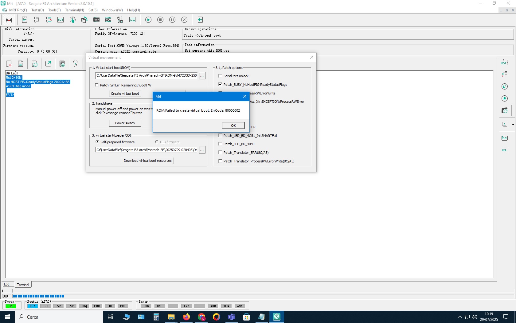

i've this 7200.12 drive stuck in busy:
FAMILY: Pharaoh
Model: STM3500418AS
FW: CC38
s/n first 3 digits: 9VM
Terminal output:
Rst 0x10M
No HOST FIS-ReadyStatusFlags 2002A185
ASCII Diag mode
F3 T>
If i try the virtual boot patch i get this rom error

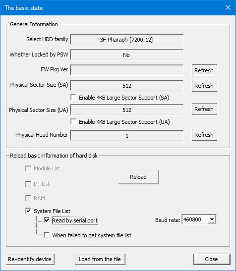

i can access and backup SYS only via serial mode
Ring any bells?

I meant that terminal shows you what's wrong. Most of cases it's translator issue but can be caused by few things. Did you check NRG, SMART etc?
I don't use MRT and don't know why the patch doesn't work. Is the ROM read without any errors? Maybe there's somenthing about this error on their forum/site/support.
I used F3romExplorer 1.0.9 to check the rom, it hasn't find any flipped byte. It says all OK
About MRT, i've contacted tech support, probably they will answer me in the middle of the night... i'm located in italy, they are in china.
I've use already the virtualboot function for other cases, it worked well for those, but for this case is not working. :?

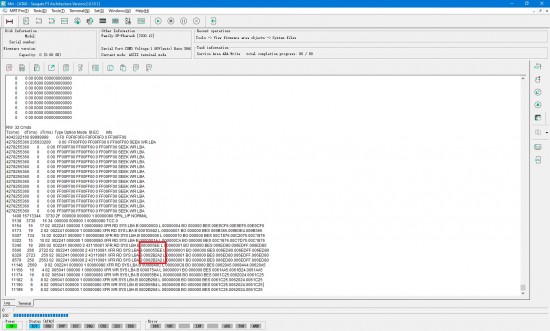

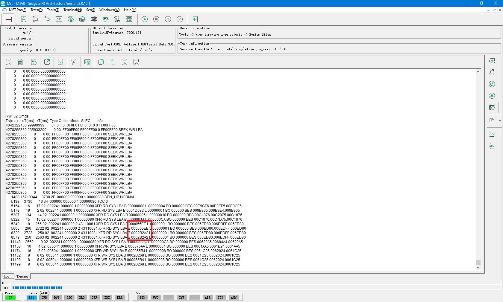

 Post subject: Re: Seagate 7200.12 Pharaoh stuck in BUSY - SYS file access
PostPosted: July 29th, 2025, 11:42
Posts: 1768
Location: Verona, Italy

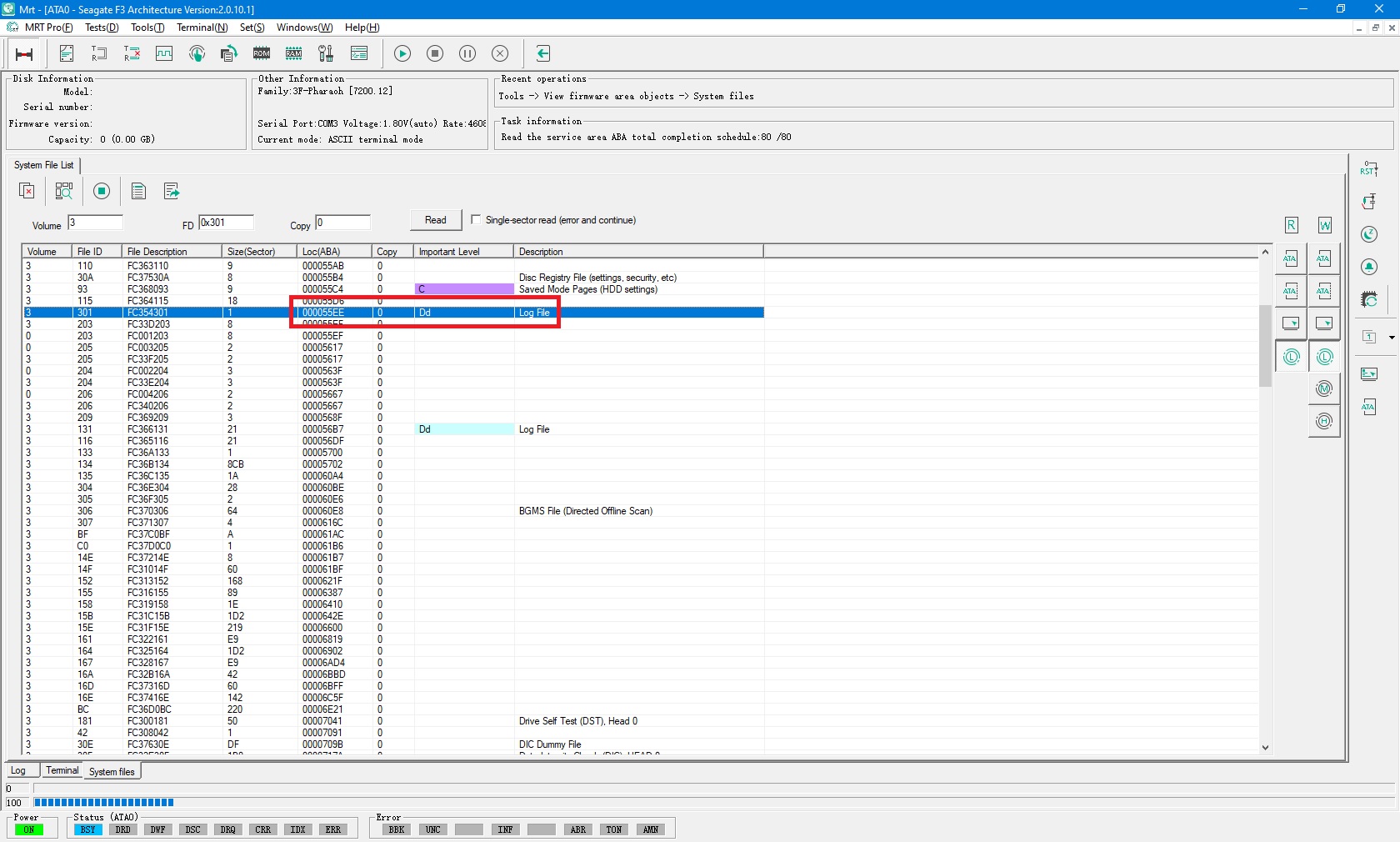

It has issues to access into this SA addresses
LBA 000055EE 0002B2A2
My firmware database:

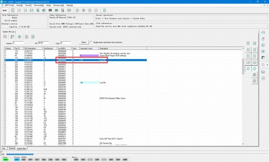

PostPosted: July 29th, 2025, 11:46
Posts: 1768

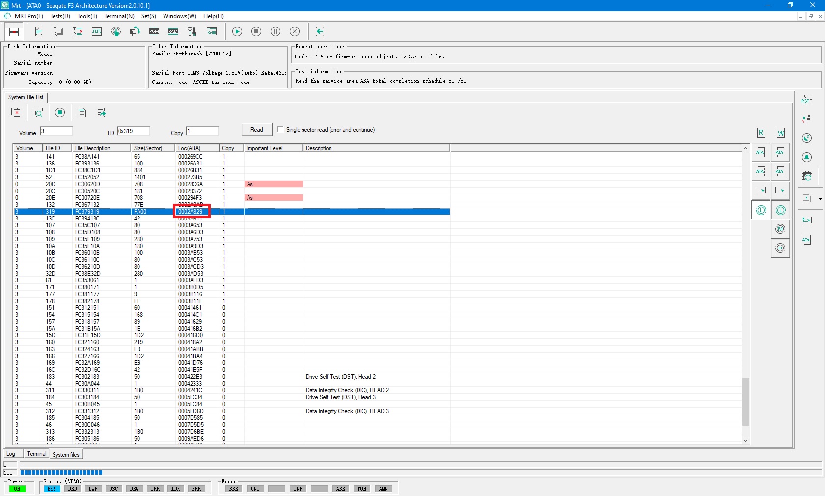

PostPosted: July 29th, 2025, 11:58
Posts: 347
Location: Eastern Europe
55EE - copy0, 2B2A2 - copy1. Mod ID 1B SysFile volume 3 ID 301. Len. 1 sector
Try to write from another or an empty sector.
If the error remains after rewriting, the recording heads are bad.

skinbob wrote:
Fancy sharing how to help people going forward?
I've already provided the solution, i just repaired the damaged SYS.
I repaired SYS 301 copy 0 by overwriting it from copy 1.
SYS 319 is the biggest SYS, but i didn't overwrite it. I only tried to read it from copy 0 (the good one) for the purpose of backing it up (it took a long time in serial mode). After that, i tried to access SYS 319 copy 1 (which was previously damaged because it returned an error while reading), but this time it had no problems opening, so i didn't touch it.
After that, i sent the translator regeneration command m0,6,3,,,,,22 again, which this time took effect. I had already tried sending the command before i was able to understand that there were corrupt SYS, from the response log on the terminal it appeared that the m0 command had completed successfully but in reality it had no effect, the disk remained in busy.
