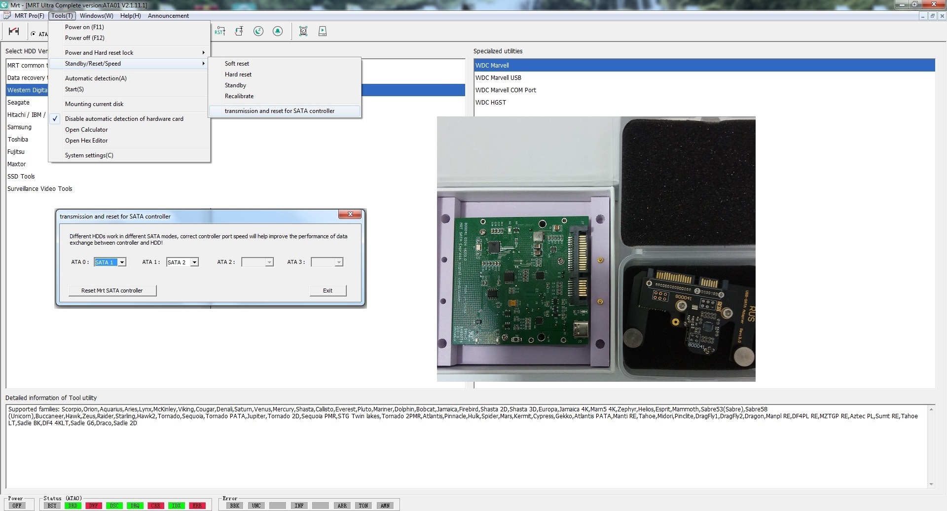

Location: Cyprus

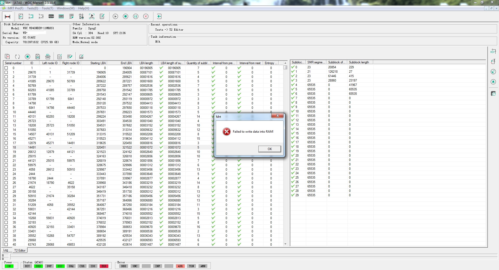

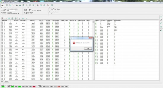

It also happens when I set to sata1 mode.
Only in 800041 pcb and failed only to load T2 with conversion usb to sata board.
Is that also the case in pc3k?

Location: Angel Data Recovery
MR8S , They are very sensitive. Sata wires should be as short as possible and firmly soldered. SATA1 set in mod 02

Joined: February 1st, 2016, 19:51
Posts: 147
Location: Cyprus
That's why I use these conversion usb to sata boards they are very stable.

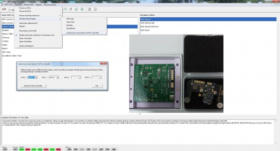

When I change sata speed within MRT settings to SATA1 the problem still exists.
Do you suggest I change it manually (maybe MRT doesn't change anything)?
Which bits to change in module 02?

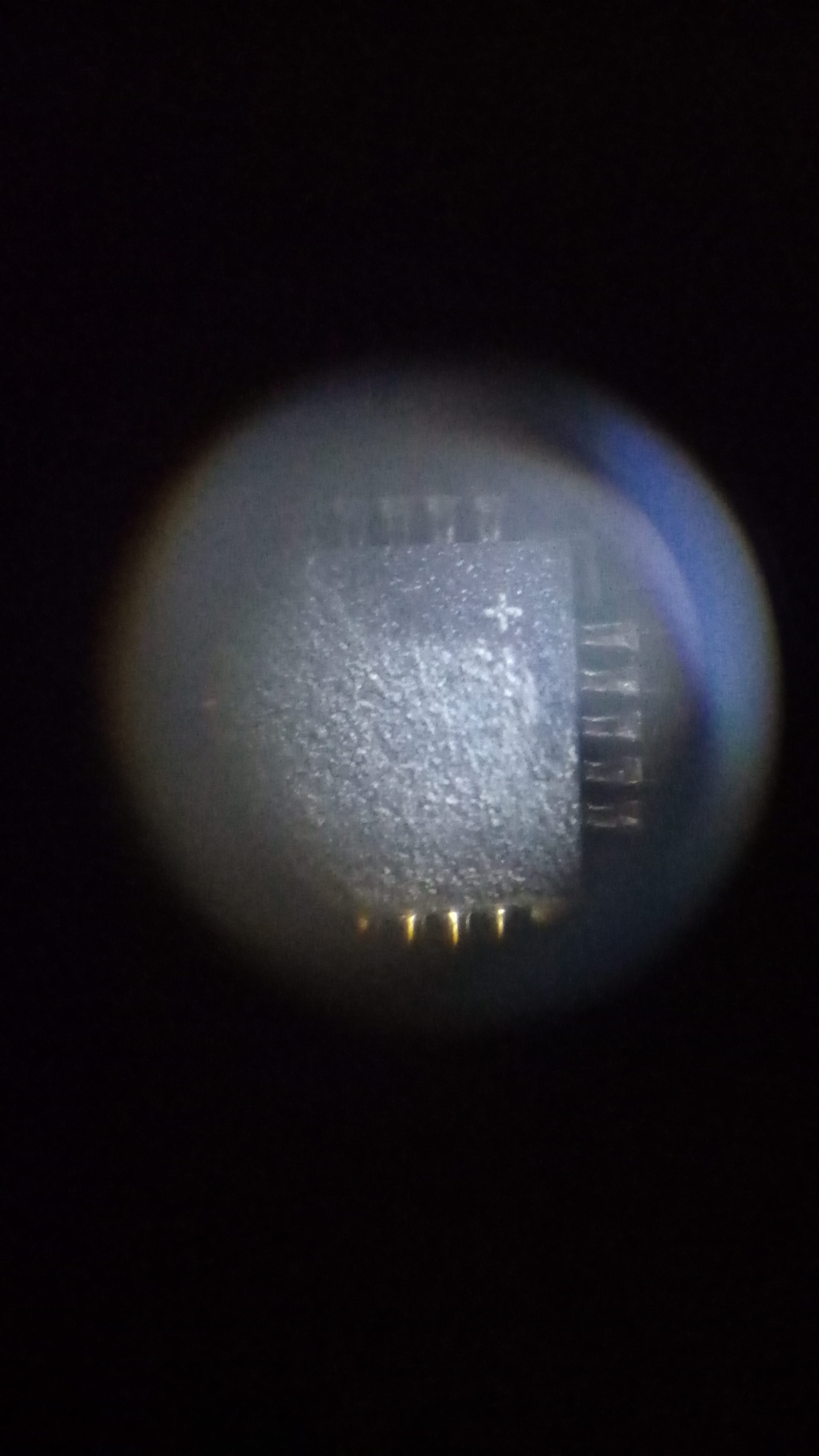

ISTR that the big square PCB has a SATA redriver IC, so it should be stable. However, I don't see anything like that on the other PCB. Can you show us photos of each side of the smaller PCB?

https://www.hddheadtools.com/wp-content/uploads/2023/09/800069-USB-SATA-Adapter-Smart-1-scaled.jpg
I think that square IC is a SATA redriver. The other IC is probably a 3.3V LDO regulator. If so, then this should be a stable setup.
If you can tell us the IC markings, that would clear things up.

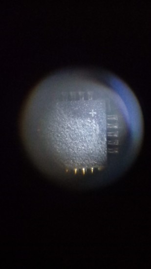

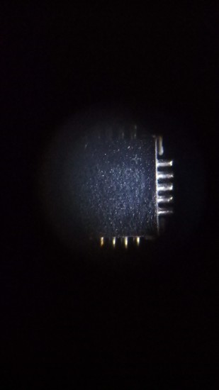

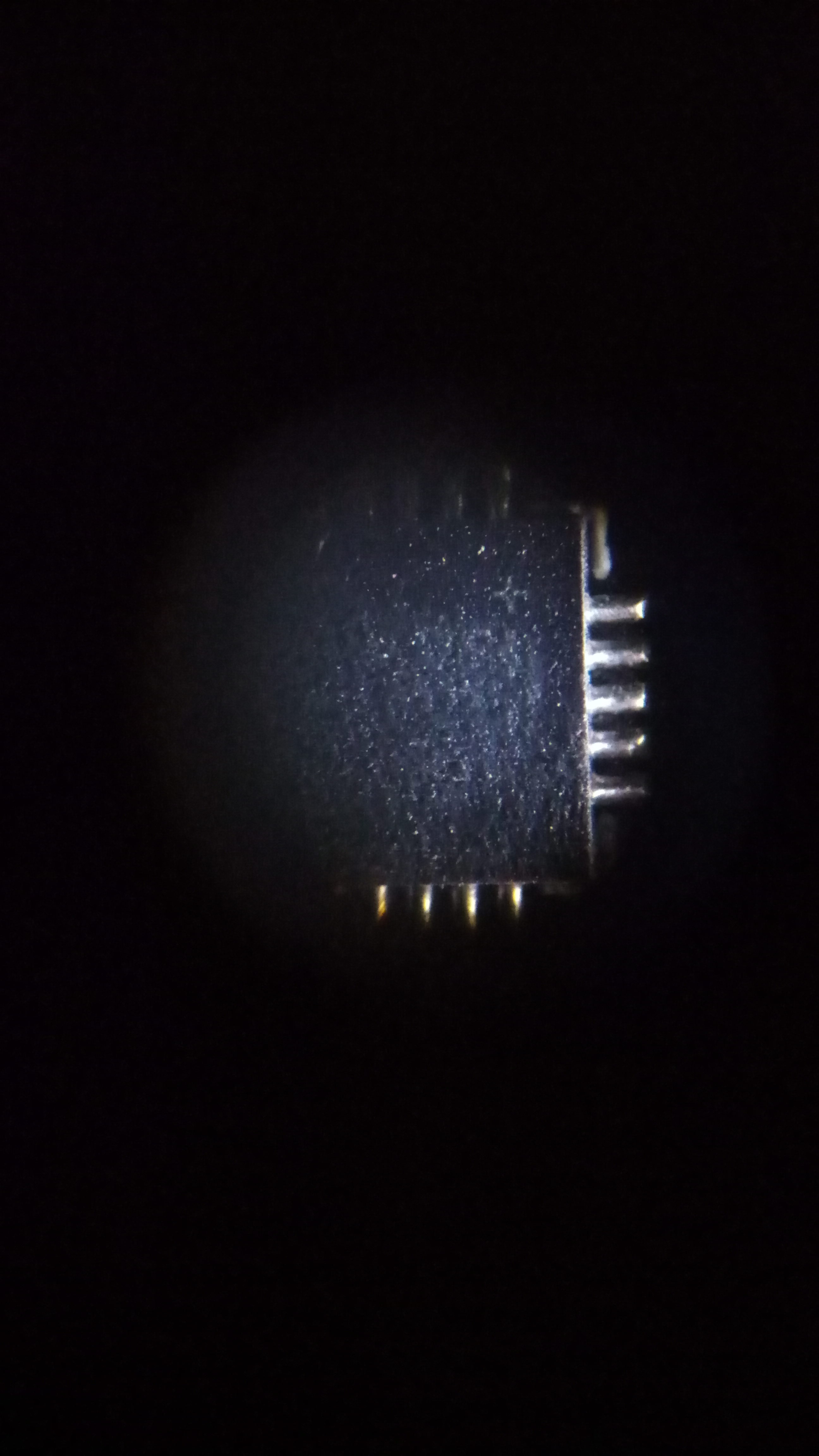

The manufacturer destroyed the IC markings in all my units.
There are two letters or numbers at the top is a semicircl.
On the regulator it is written AMS1117 3.3.
 Post subject: Re: spyglass 2 load T2: usb connection vs usb converted to s
PostPosted: August 10th, 2025, 16:09
Posts: 17328
The "+" mark at pin #1 identifies it as a Maxim IC, possibly this SATA redriver (MAX4952B):
https://www.mouser.com/datasheet/2/609/MAX4952B-3469998.pdf
I don't understand why the manufacturer would deface the chip markings. Seems very petty to me.
