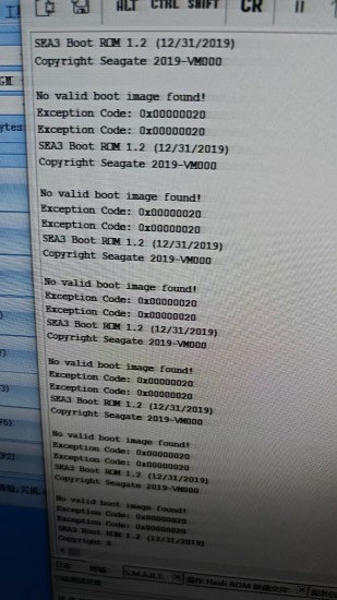

 Post subject: Seagate st16000ne000rom is damaged
PostPosted: August 13th, 2025, 6:40
Joined: July 25th, 2024, 6:36
Posts: 26
Location: 美国加利福利亚州
Any kind person can help me fix my damaged rom
 Post subject: Re: Seagate st16000ne000rom is damaged
PostPosted: August 13th, 2025, 6:42
Posts: 26
Location: 美国加利福利亚州

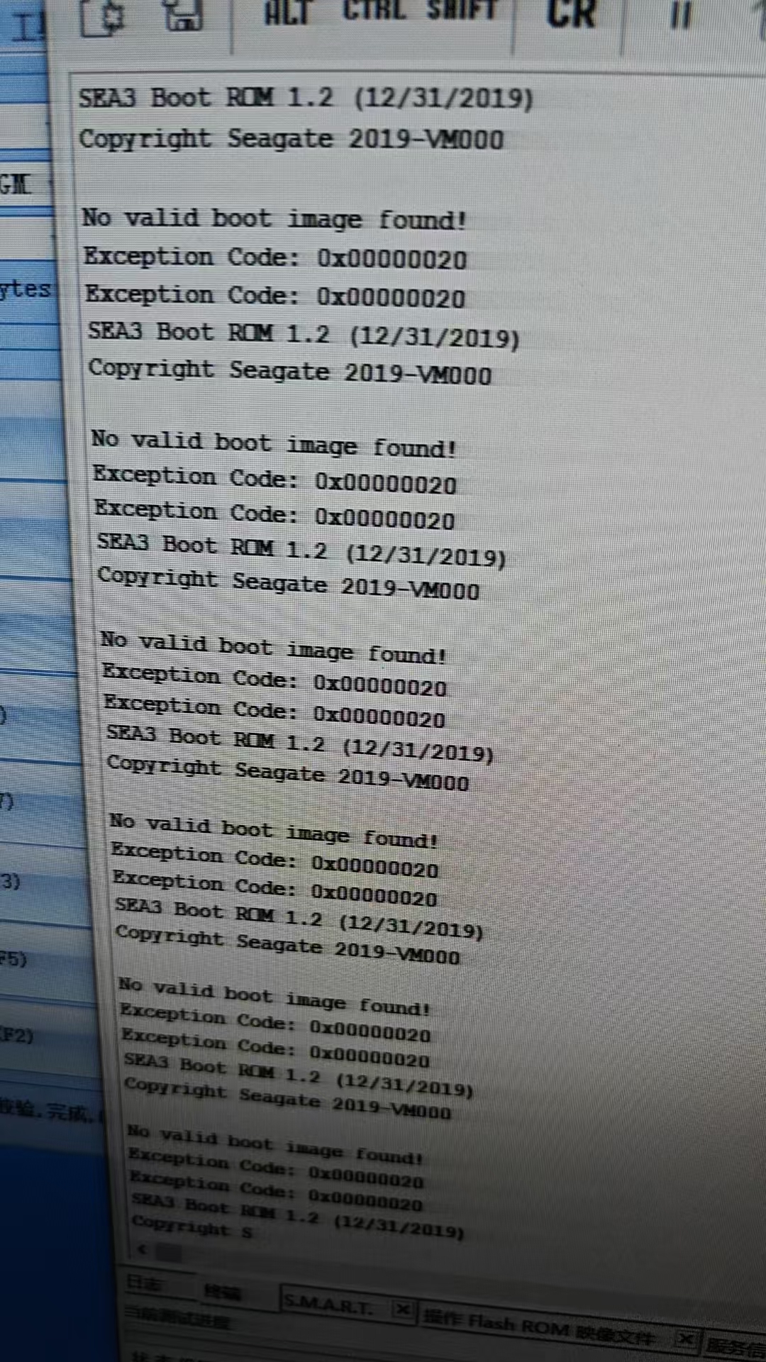

This is the terminal prompt.

Damaged ROM
