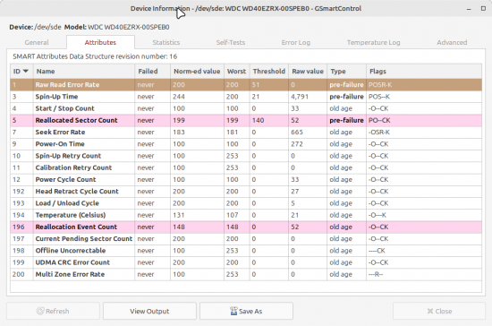

I bought a pair of Western Digital Green 4TB HDDs off Aliexpress recently. And formatted both with BTRFS, then went to copy a ton load of data onto the first one (migrating from an older 4TB)) using rsync.
A lot of errors were reported. So I ran a SMART long test, and it passed but had 52 Reallocated Sectors reports and three Pre-fail flags set as illustrated in the attacked image. Aliexpress accepted both of them as returns.
Looking into it Greens someone suggested they were SMR (Shingle Magnetic Recording) and I should aim for CMR (Conventional Magnetic Recording), and Blues being a little pricier offered that, so I sunk some money into getting two Western Digital Blue HDDs.
Given the sour experience with those Greens, and thinking the vendor is maybe shipping seconds with a low price tag I checked the Blues SMART attributes and was surprised. Very surprised.
The same three attributes have the P (Pre-Fail) flag set out of the shop (this time from a bricks and mortar store up the road). All the attribute values, raw and scaled look fine, and I ran long tests and both passed with no rsynced the a drive to near full and no errors (Reallocated_Sector_Ct has a raw value of 0). I attach the full SMART reports for both as text files.
What I'd like to know is what's up here. I have some theories (in the poll).

File comment: SMART attributes reported by gsmartcontrol for brand new fault reporting WD Green

Copilot is wrong. The Prefail flag merely identifies the attribute type. It does not indicate that there is anything wrong. To determine whether that attribute is failing, you need to examine the raw value and threshold level. In your case the non-zero raw values for the Seek Error Rate and Reallocated Sector Count are indicative of a degraded drive.
Thanks enormously. With that insight in hand to uncover a blind spot in my thinking, I:
1. Googled and found docs thin on the ground in this rspect, but Wikipedia does agree stating: If one or more attribute have the "prefailure" flag, and the "current value" of such prefailure attribute is smaller than or equal to its "threshold value" (unless the "threshold value" is 0), that will be reported as a "drive failure". In addition, a utility software can send SMART RETURN STATUS command to the ATA drive, it may report three status: "drive OK", "drive warning" or "drive failure".
2. Let CoPilot know it was lying to me and it apologised profusely and confirmed your version and Wikipedia's. Fret not I never trust an AI, which is why a post here, where I had hoped to find an experienced eye.
3. Checked a pile of other drives and indeed they all have some attributes witht he P flag set, different in different models.
So the poll concludes with 4. as the elected answer!
