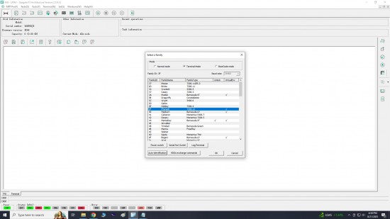

Hi, I am using MRT.
I have :
Seagate Barracuda 500Gb
ST500DM002-1BD142 / 3F Pharaoh
KC48
Capacity (0.00 GB)
Model unable to read
It is READY, no clicking , spindle run normal. After select model then DWF, ERR, ABR light ON . Spindle keep spinning.
Try access SA by ABA, it is no issue all saved with no error.
How to solve this problem ?
thanks

On terminal I got this since power up ;
Boot 0x10M
Spin Up[0x00000000][0x0000B67C][0x0000BA10]
Trans.
Rst 0x10M
MC Internal LPC Process
Spin Up
(P) SATA Reset
ProcessRWError -Read- at LBA 0013204A Sense Code=40000087
Unretryable read error
ProcessRWError -Write- at LBA 0013204A Sense Code=40000087
Unretryable write error
ASCII Diag mode
F3 T>
 Post subject: Re: ST500DM002-1BD142, ready, select model then;DWF, ERR, AB
PostPosted: August 21st, 2025, 9:58
Posts: 4854
Device Fault flag is set. Clear it.
