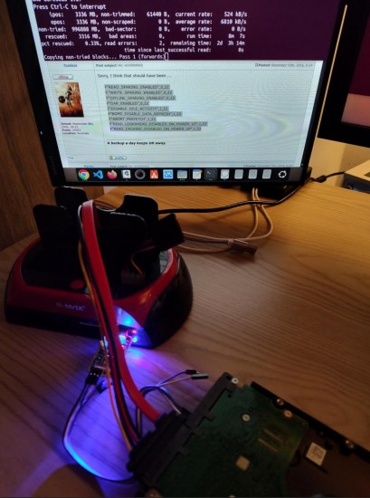

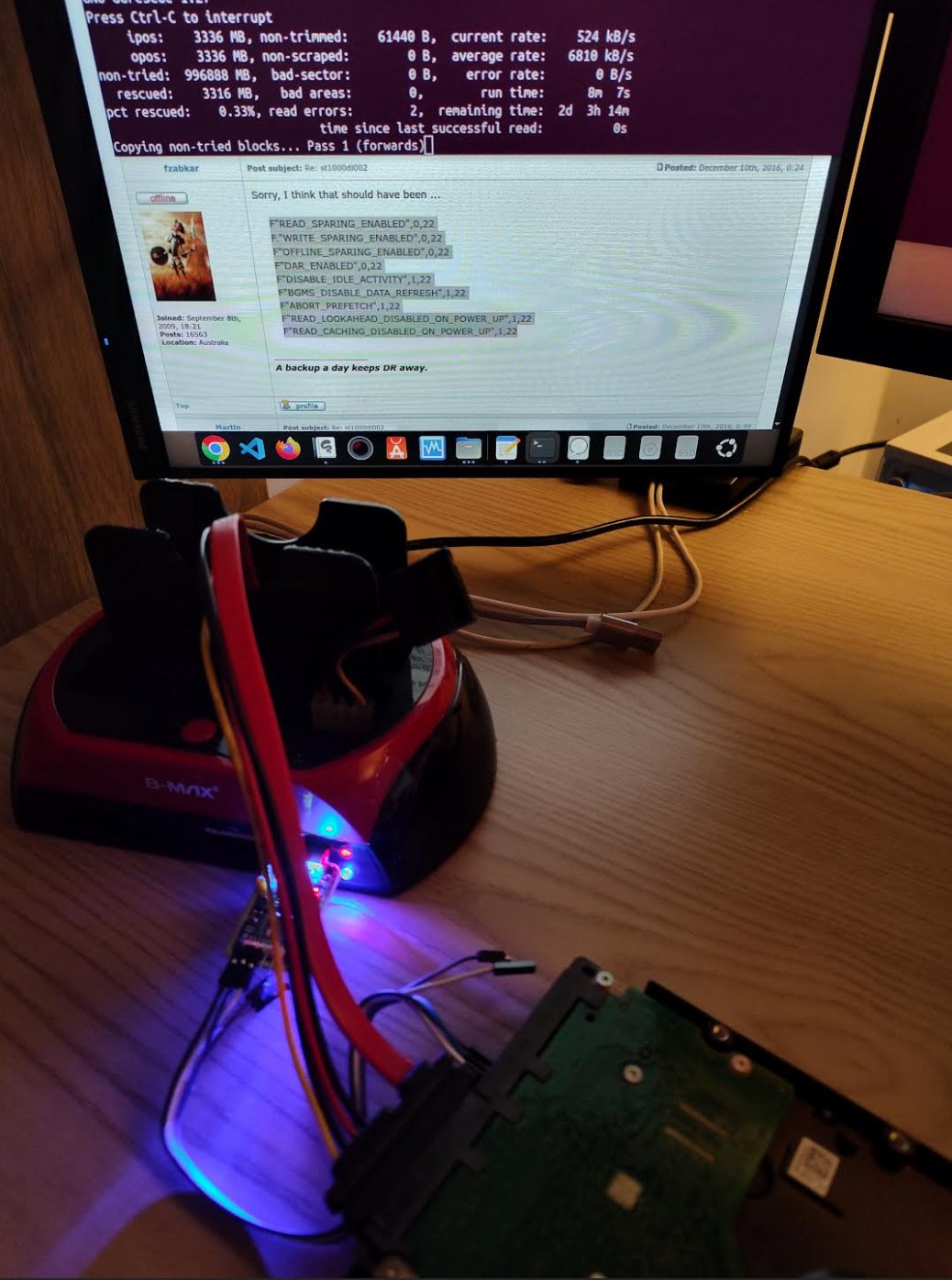

 Post subject: Re: ST31000524 stuck in InitiateMarkPendingReallocateReqest
PostPosted: August 23rd, 2025, 21:49
Joined: August 23rd, 2025, 13:10
Location: Brazil
fzavkar, you rock!
Found your post, turned off sparing and bunch of other flags:
F"READ_SPARING_ENABLED",0,22
F"WRITE_SPARING_ENABLED",0,22
F"OFFLINE_SPARING_ENABLED",0,22
F"DAR_ENABLED",0,22
F"DISABLE_IDLE_ACTIVITY",1,22
F"BGMS_DISABLE_DATA_REFRESH",1,22
F"ABORT_PREFETCH",1,22
F"READ_LOOKAHEAD_DISABLED_ON_POWER_UP",1,22
F"READ_CACHING_DISABLED_ON_POWER_UP",1,22
And now I'm imaging :)
I am deeply grateful!
