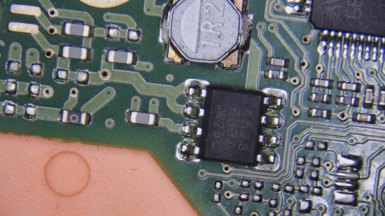

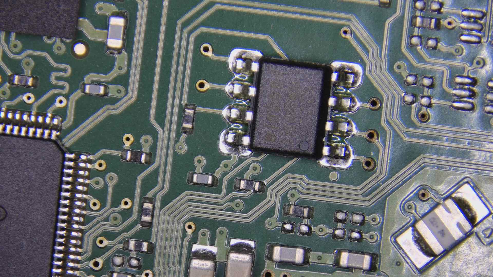

Hi everyone,
A customer just sent us a HDD that was previously sent to a small DR company that concluded the HDD needed a heads swap.
The drive does not spin so we first took a look at the PCB and found out that one TVS diode is dead.
But also we noticed that the bios chip might have some flux around it so we are not sure if this is the original pcb/bios chip, before going any further i'd like to ask for your opinions about this.
Thanks in advance to everyone who will take the time to answer !

Compare the serial number on the sticker and in the ROM. Terminal log?

read the contents and check SN in SAP

The second photo shows an Si4823DY MOSFET:
https://www.vishay.com/docs/64715/si4823dy.pdf
It is not a "BIOS" or ROM IC.
Well, here is the answer to the main question of the topic... :)
Otherwise, why bother with photos of all eight-pin chips? Sorry...
Which diode, 5V or 12V? Did you check the fuses or zero-ohm resistors?
Yes the first picture is the eeprom but we attached the second picture because this chip also looks like it has some flux around it, but we could be wrong
