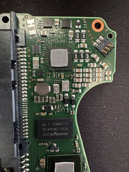

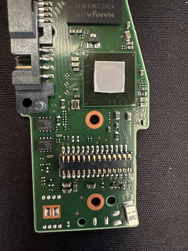

Hi Everyone,
I recently swapped out my power supply, but the SATA cable that came with it was for a different model. Since then, my HDD hasn’t been spinning. I ordered the same PCB from eBay, and now the drive does spin and is detected — but the reported size changed from just under 14 TB to 14.5 TB, which makes me hesitant to use it.
From what I’ve read, I may need to do a BIOS/ROM swap, but the ROM chips on this drive are really small. I’ve also seen suggestions that it could be a diode issue, but when I check with my multimeter, I get similar readings on both the old and new PCB.
Has anyone dealt with this before? Any tips on how to properly diagnose the problem would be much appreciated.
HDD Model: Seagate PCB 100852967 REV C

This photo suggests that this model has a unique key in the MCU:
https://ae01.alicdn.com/kf/Sea692b1527fd46b8a01c160eafbb29baa.png
Unfortunately, neither photo is clear enough for me to help you.

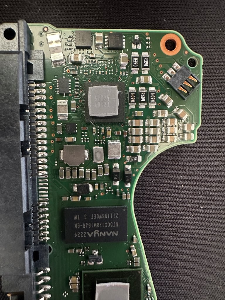

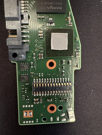

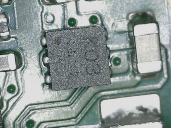

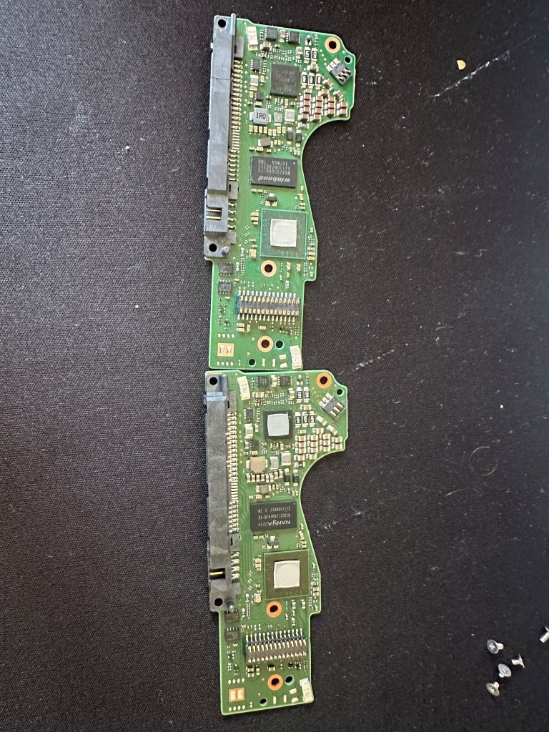

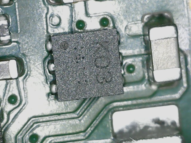

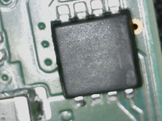

Is this any better?
 Post subject: Re: Seagate Exos 18 PCB Repair
PostPosted: October 1st, 2025, 4:35
Posts: 17337
In the top left corner of the first photo, all I see are black squares. Hint: if you can't see the part markings on the ICs in your photos, then neither can we.

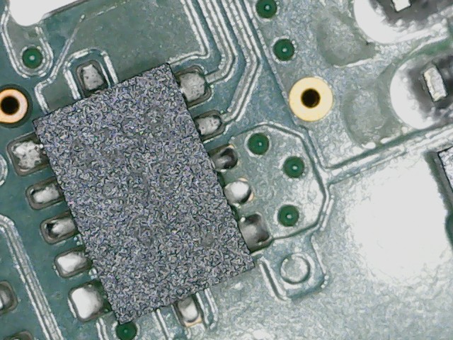

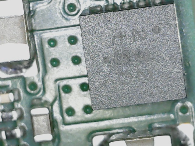

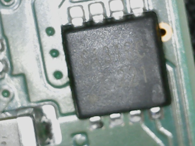

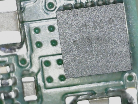

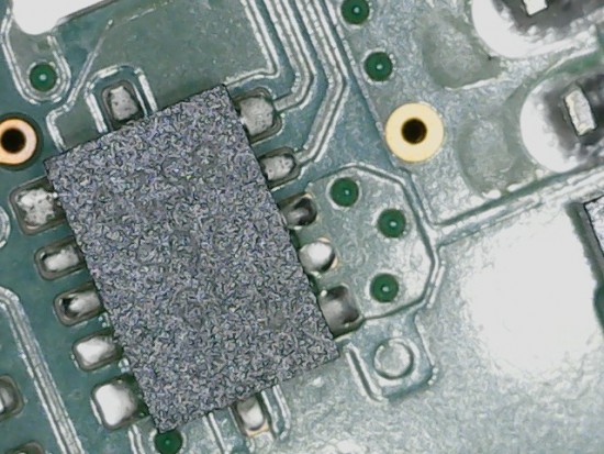

Hopefully this tells you something.
Im starting to think a bios/rom swap might be easier at this point.
PostPosted: October 2nd, 2025, 4:08
Posts: 17337
Measure 12Vout and 5Vout as marked in that other thread.

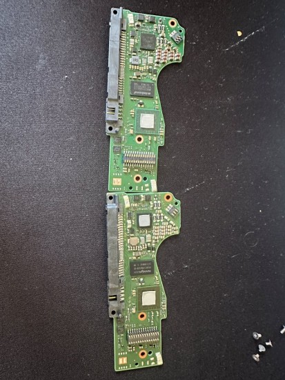

The pcb removed from the Seagate hard disk of this label can be used in common with other X18s.
Screenshot_2025-10-09-13-37-36-79_0dff84d2da4d0ad536cbb4d749024dd6.jpg [ 479.89 KiB | Viewed 2748 times ]
