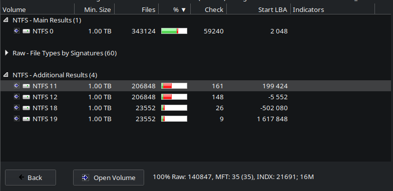

- Testdisk reports MBR is good, MFT and mirror are bad. It suggests "None" as partition table.

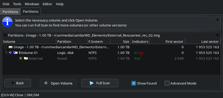

- It mounts in DMDE without issues. Initially it finds only the data volume ($Volume 01 > External), after running a full scan (RAW+NFTS) it reports additional results. The the file structure seems correct for the External volume.
- Opening the extra volumes from the Full Scan tab shows files that were being copied from/to the drive sitting outside the $Root.

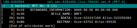

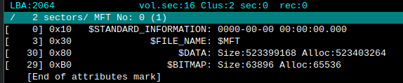

- There are two entries for the $MFT in $FSFragments. The rest are files that were being transferred and can be ignored.

It's strange that you have a boot sector at LBA 0, and it's strange that the capacity of the image is 4 sectors short of a full 1TB drive. Perhaps those missing 4 sectors contain the backup NTFS boot sector. Or maybe the Seagate enclosure's firmware grabs those last 4 sectors for its own use?

Yeah, it's strange. As the owner I should know what exactly the disk looked like before it got corrupted, but if I formatted it it was a very long time ago and I had no reason to peek at it from any software that would show LBAs since then.
The only related information I managed to dig up in a search is that some Seagates have a small offset at the start. Someone trying to install Linux on a drive of potentially the same model got:
the partition /dev/sda1 assigned to / starts at an offset of 3584 bytes from the minimum alignment for this disk, which may lead to very poor performance.
The poster only shared the consumer-facing name and capacity of his drive, not the model, but the date is about right.
