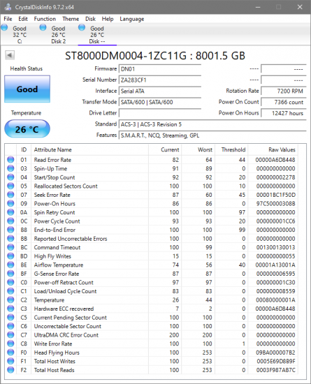

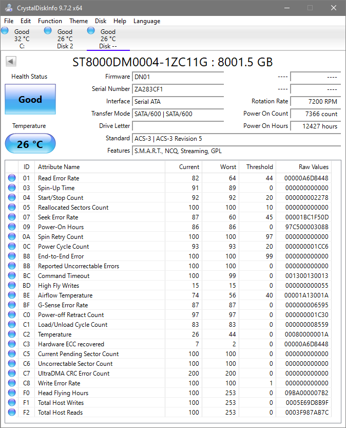

The drive was part of a RAID array that failed.
I replaced the drive and rebuilt the RAID.
Thankfully no data was lost.
Before thowing the drive in the skip I hooked up a terminal to the serial port to check the diagnostics and error messages.
This is what I get:-

CrystalDiskInfo for the two drives in the RAID.

The first drive is reporting 19 (= 0x13) Command Timeouts where the drive took longer than 7 seconds to complete a read or write request. I would keep an eye on that attribute.

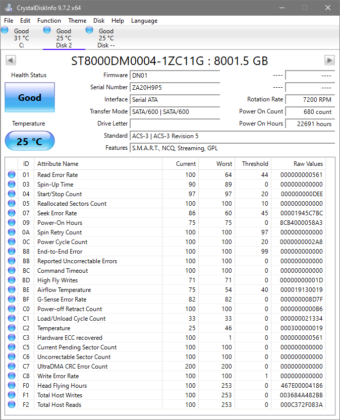

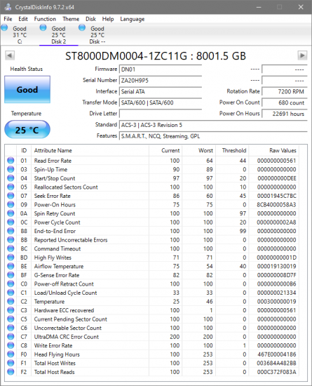

I can already see your current temperature from the raw value 0xBE (max:0x1A = 26C, min:0x13 = 19C). Where do the worst values ​​of 0x56 and 0x54 come from with a threshold of 0x40?
Regarding power: raw 0xC0 = 7216 and 182. Just read the SMART, let it click, read the SMART again, and see what's changed.
 Post subject: Re: Seagate Barracuda Pro 8TB ST8000DM0004 7200rpm
PostPosted: October 19th, 2025, 12:04
Posts: 17327
Those normalised values are decimal. They represent "100 - Temperature". Therefore, the threshold is 60C (= 100 - 40), and the worst case values are 44C and 46C.
