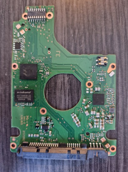

Hi Everyone,
I have a WD drive (WD10SPSZ-24Z10T1) to recover after what seems to be an overvoltage or shortcircuit on the motherboard...
I've found the HDD not spinning. replacing the PCB with another one made the drive turn and windows recognized it uninitialiazed.
I've tied to dump the ROM from the orginal PCB into the new PCB but then the HDD didn't want to spin anymore...
As far as I went through i realized that the F/W version was different on the 2 drives but i also think that their is a chance for the datas in the original ROM was corrupted because i was able to read it only once and after it doesn't worked anymore...
I have looked in both BIN files and realized that their was a "missing part" in the original ROM (perhaps a reading issue...)...
I am quite new in this kind of troubleshooting and I can't really find a clue on my case, i am a bit afraid of going further without any advices.
Do you guys think i can recover my datas with a ROM coming from a drive with another F/W version ? Or maybe i is posssible to fix the original ROM file by filling the "missing part" ?
File comment: the two bin files extracted from the ROMs

Are you trying to read your ROM with a 3.3V programmer?
 Post subject: Re: corrupted ROM
PostPosted: November 2nd, 2022, 16:54
Joined: November 1st, 2022, 12:59
Posts: 12
Location: France
Hello fzabkar,
As far as i can see (and understand) the original ROM file is bad.
I've tried both with 1.8V and 3.3V on two different readers I can't remember on wich case i achieved to read it... i also tried to solder it on a pcb instead of using a clamp to avoid bad contacts...
to answer your question in my other thread wich was a false issue, my PCB is 2060-800066 which is "MCU locked".
As I understand i need to be able to recover the datas frome the original ROM in order to get my HDD back to life, right ? In this case i don't believe it will be a success I wll try one more time to read this chip with the slowest baudrate i can do.
Is their anyway to "clone" the raw datas on the drive and trying to rebuild files from this ?

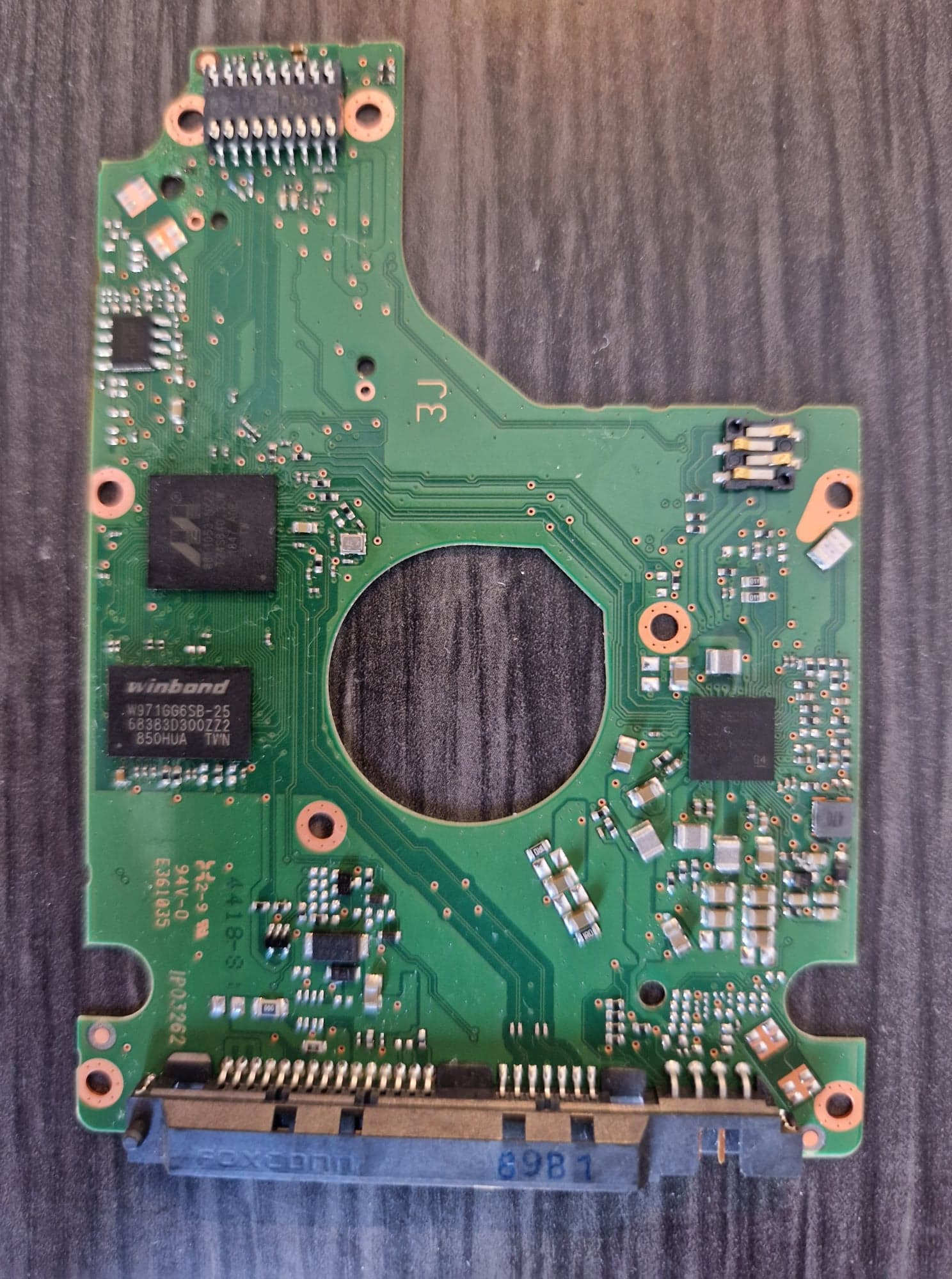

I suggest you obtain a multimeter (~US$5). Also, show us a photo of the PCB.

I've already performed the basic electrical tests on the PCB and it appears to be good.
I am not testing the original board as the drive failed after what seems to be a power failure on the PCB motherboard (the computer was off and i discover the audio codec hot as hell and as i opened the case it started to burn...) and also while desoldering the ROM chip my hot air flow was a bit to strong and the tiniest IC on the board decided to fly out, it must be a decoupling capacitor but as i dont't have the schematic i prefer to use a new PCB
I do use 3.3V sometimes instead of 1.8V in a "last chance" try for chips that might need a "little punch" to start working. I know this is not a good practice but in some cases i was able to get what i need.
Attached, a picture of the new PCB with it's original ROM.
314380725_660885239105504_8517262555633257133_n.jpg [ 350.29 KiB | Viewed 9048 times ]
PostPosted: November 4th, 2022, 6:28
Posts: 12
Location: France
I only tied with 3.3V as i wasn't able to get any good extract from the chip...
After some trials I realized that the issue was in fact the programmer itself, I've flashed another ROM on a second programmer then try to read it with my first programmer but it didn't worked, worst of all when i tried to read the datas with my second programmer they were bad...
So I guess that I've messed up my ROM at the very first time I tried to read it with my crappy programmer...
PostPosted: November 4th, 2022, 15:47
Posts: 17326
Try to read the unique "adaptive" components of the ROM instead of the entire ROM.
These are the ROYL modules:
Address    Size (bytes)
0007C000   0000004E
0007C556   00000600
0007C04E   00000108
0007C156   00000400
0007CB56   0000007E
0007CBD4   0000069E
0007D272   00000128
0007D39A   0000013D
0007E000   0000004E
0007E04E   00000108
0007E156   00000400
0007E556   00000600
0007EB56   0000007E
0007EBD4   0000069E
0007F39A   0000013D
000FE000   00000400
000FE400   00000C00
Also carve out the range from 0 to 0x1FFF.
These are the critical areas. The rest can be recovered from resource dumps.
Don't discard the original PCB. You will need it.
PostPosted: November 5th, 2022, 5:34
Posts: 12
Location: France
Well... the chip is not giving any sign of life even with slow baudrate and withour any data validation...
I think it is totally burnt...
