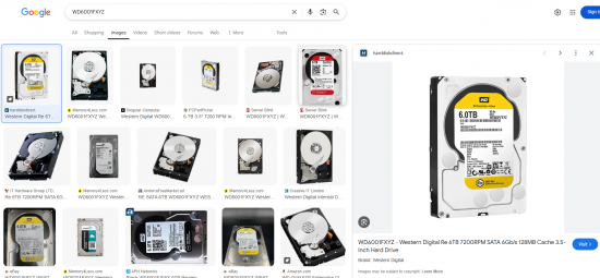

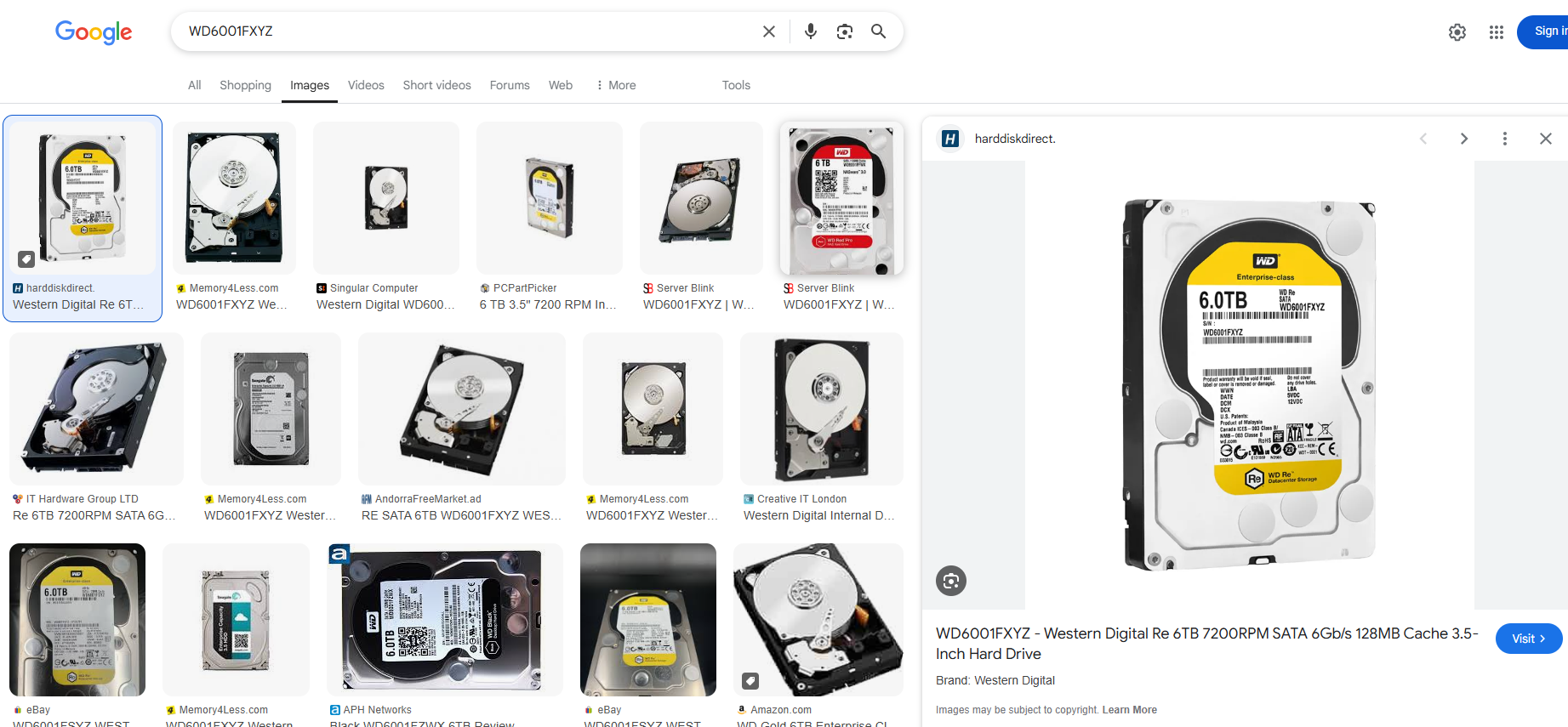

https://harddiskdirect.com/wd6001fxyz-wd-desktop-hard-drive.html
is this what you mean?

HaQue wrote:
No. That is just a corporate computer-generated image, not an actual picture that someone has taken of one. The only pictures I can find are of WD6001FSYZs.

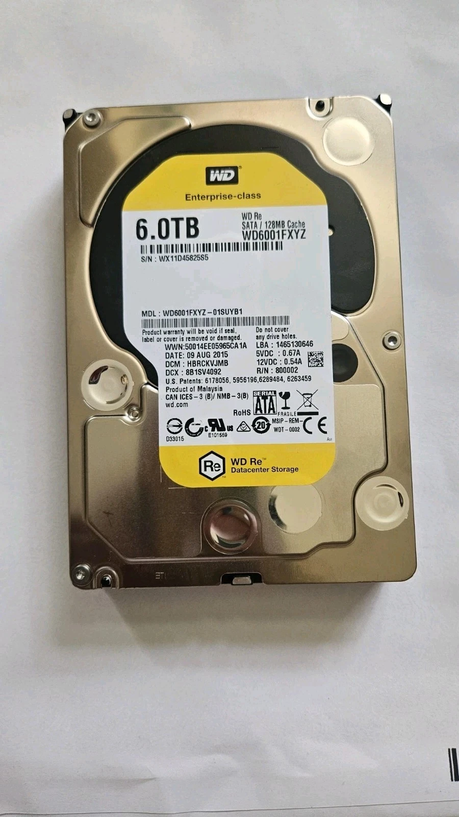

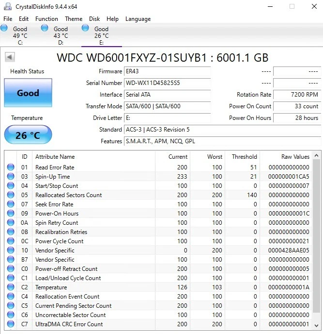

Someone just sold one! And it only has 28 hours on it!
https://www.ebay.com/itm/167955077584

That drive appears to be a fake.
1/ The capacity on the label is 1465130646 LBAs. That's 750GB. A real 750GB drive has 1465149168 LBAs (a difference of 18522 sectors), and a real 6TB drive has 11721045168 LBAs.
2/ The DCX (8B1SV4092) suggests that the model number suffix should be -xxBV9x1.
3/ The serial number is unknown at WD's warranty checker page.
https://support-en.wd.com/app/warrantystatusweb
4/ The R/N is 800002, which reflects the PCB P/N, 2060-800002. Typical models with this PCB are WD5001FZWX-00ZHUA0, WD6001FZWX-00A2VA0 and WD5001FZWX-00A2VA0.
https://www.hdd-parts.com/nsearch.html?section=&query=800002&searchsubmit=Search&vwcatalog=yhst-14437584971410
https://i.ebayimg.com/images/g/mlIAAeSwY9xo~RKi/s-l1600.webp (label)
https://i.ebayimg.com/images/g/tioAAeSwHb1o~RKd/s-l1600.webp (SMART)

1465130646 LBAs x 4096 = 6001175126016
It would have 11721045168 sectors if it was a 512-byte-per-sector drive. But this is a 4096-byte-per-sector drive, so divide that first number by 8, and you get 1465130646 sectors. Also, this is the correct model suffix, as listed on RML527's HDD Platter Capacity Database. Western Digital has never used the model suffix you listed. As well as that, the WD6001FZWX is the WD Black version of the much more common 512e version of this drive, the WD6001FSYZ. They use the same unique HDA that was only used on Western Digital's final five-platter platform before switching to re-branded Hitachi drives.
I expect you will find that suffix in the SA firmware. The suffix would have been amended afterwards.
See this thread:
https://www.hddoracle.com/viewtopic.php?p=14305#p14305
A drive with "WD5000AUDX-63WNHY0" on the label has "WD5000AUDX-63AMGY0" in SA module 0x8028. The DCX reflects AMG rather than WNH.
