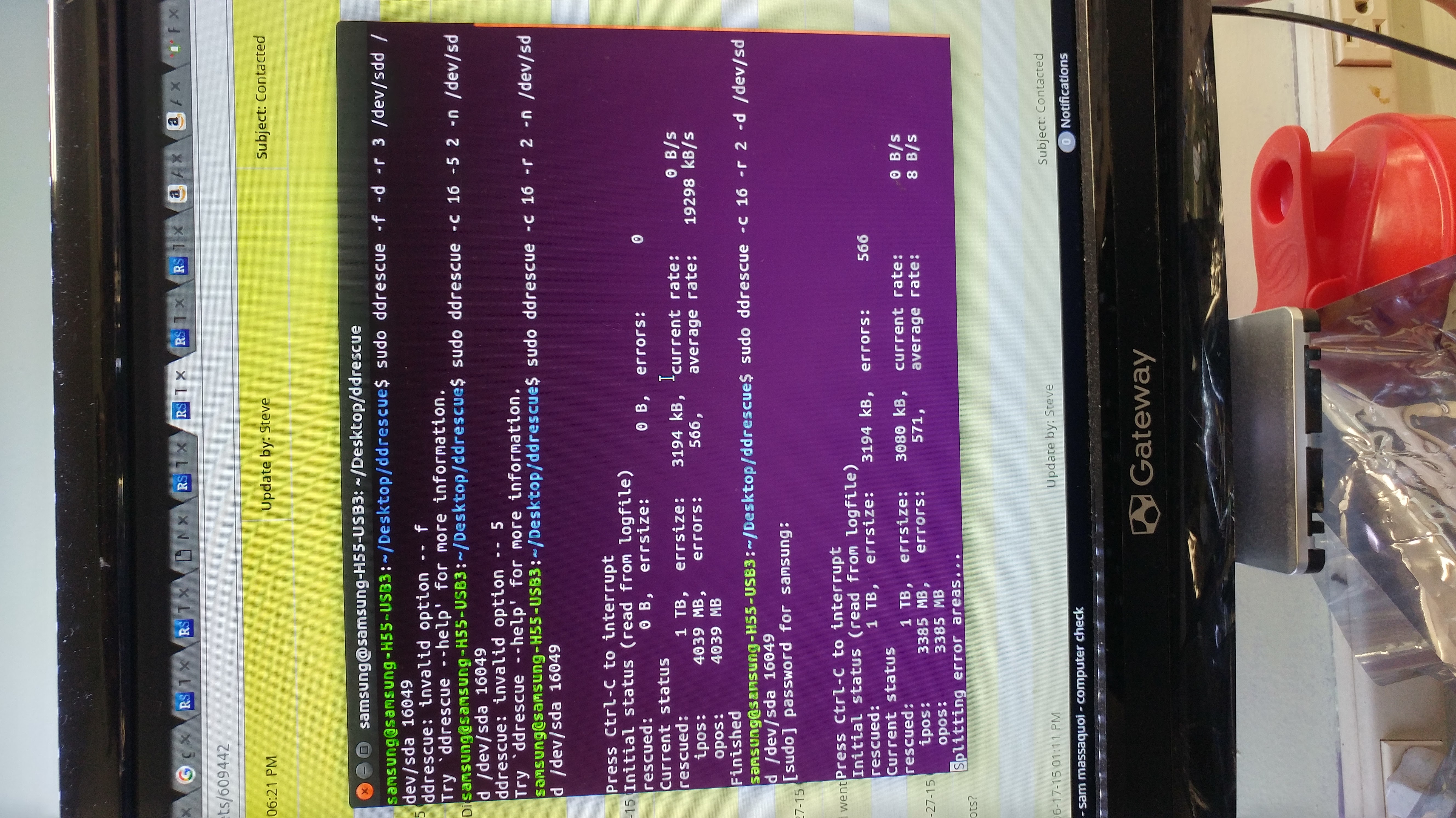

Newbie here. I have a WD My Passport Ultra 1TB with a 2060-771961-001 PCB that wasn't being recognized by the computer at all. The LED would flash a few times, then go steady, then flash again. It seemed to spin up fine and I didn't hear any clicking.
I followed this guide here: viewtopic.php?f=1&t=27819
I removed U14, then desoldered C13, C18, C31, C37 from the JMS side as it said in the thread, but what wasn't clear was whether to leave the caps on or not. I left them on and soldered on the A and B wires from the SATA port to the other end of the caps that would normally go to the JMS chip.
The drive is now recognized as a 1TB WD drive, but Windows/Linux/Mac/Rapidspar do not see a partition map. It also reads incredibly slow; ddrescue was reading at like 320kb/s.
Rapidspar says the heads are 100% healthy and 79% of tested sectors contain data. Drive CPU/RAM, ROM are ok, but Translator and Defect Lists only have partial access.
Any ideas what could be the issue? Does it have something to do with the encryption from the JMS chip? What would be the next step here to recover data?

Sorry, did not mean zeroing out the entire module, only the section after the key as described.
I did compare the original and patched module right after I asked those dumb questions and saw it had been applied successfully. The drive actually ddrescued completely overnight at a good rate of 19mB/s. I guess it was just a combination of bad blocks in the beginning of the drive and my impatience for this data :roll: :roll:
Thanks for everyone's help. Now to decrypt the drive. I'm also considering putting U14 back on and reconnecting the USB interface just to see if the drive would work again as it might be easier to get data off that way or if I can't decrypt it.
