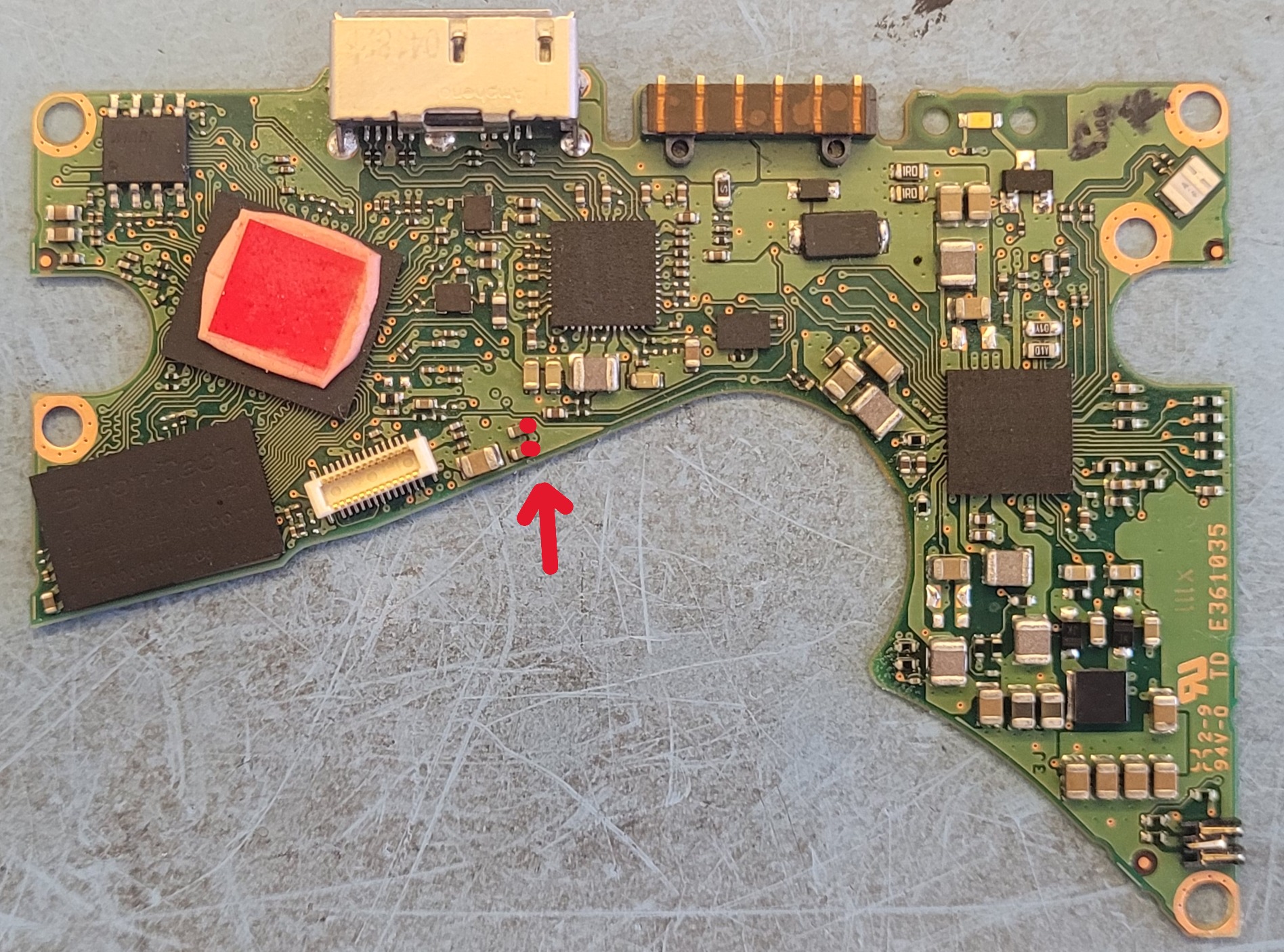

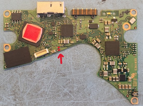

If you want to troubleshoot the PCB, upload a clear hi-res photo.
Ok, thank you, I’m attaching the photo. If it helps, I noticed that on the points marked in red, the working PCB has 3V, while the faulty PCB has 0. Generally, the other voltages seem quite similar on both PCBs.

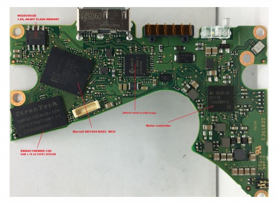

n3dv3d wrote:
I noticed that on the points marked in red, the working PCB has 3V, .
Hi, did you purchase a donor pcb?
these boards have independent ROM chips, according to the picture.
I would read/save the content of the eeprom first, then transfer it to the donor board.

Better picture

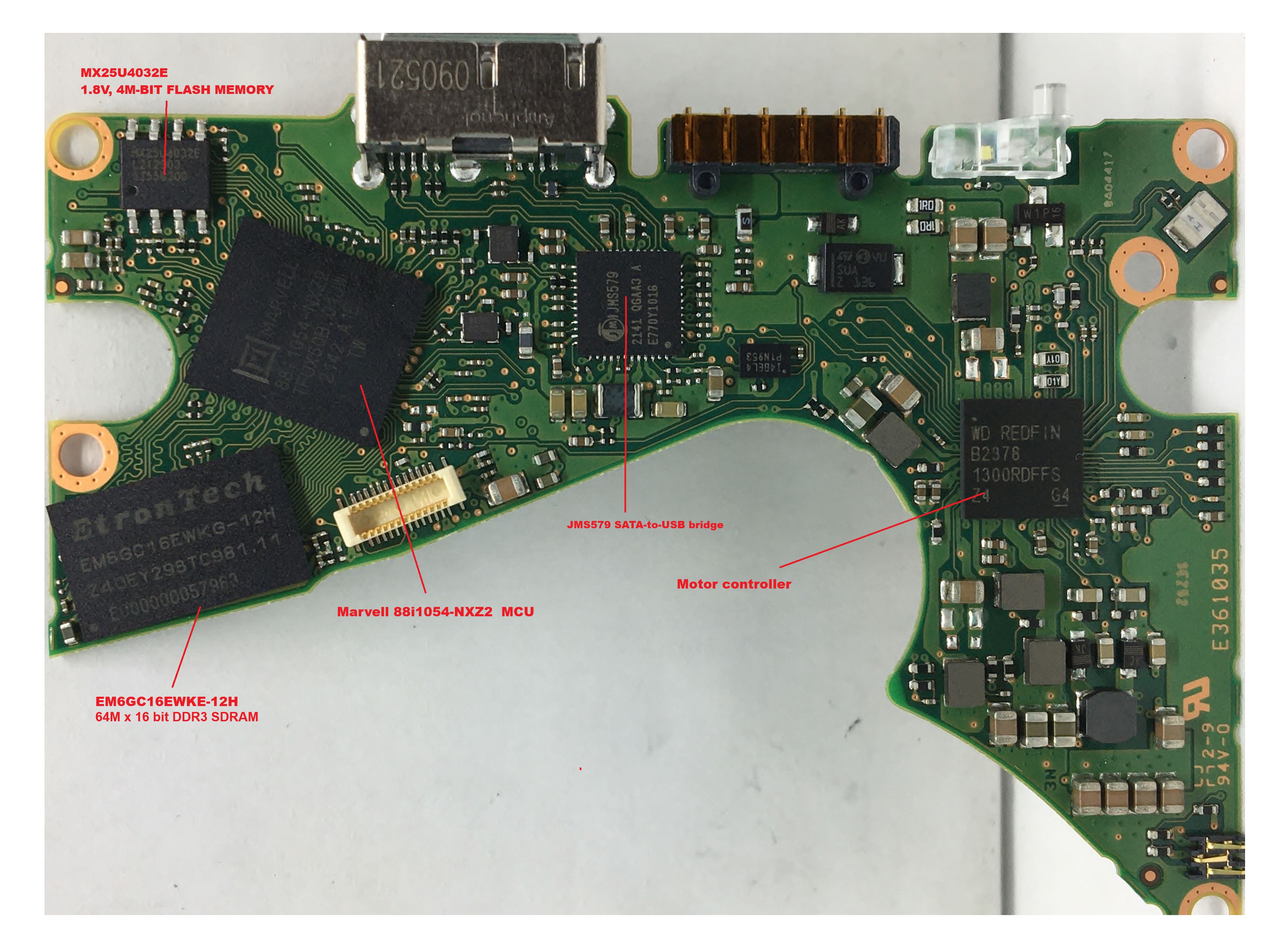

n3dv3d wrote:
This drive needs the native the USB pcb to read unencrypted data so move the only ROM chip will provide garbage data.
I don't quiet understand, what do you mean by saying "Drive needs the native usb pcb"
Are you saying If you get the same donor and transfer the Flash chip, the trick is not going to work?
Any way, i would try to fix your original pcb first. The motor controller chip also acts as power supply, creating several voltages for the pcb.
You mentioned previously that you see +3 volts on capacitors, on the donor board, but not on your original pcb? This could be an indication of the faulty motor controller chip.
With the hot air station you can easily transfer this chip from the donor board. Requires a bit of experience of course.
My approach is always the same. Read/save ROM (if possible) from the original pcb, then try to fix it.
