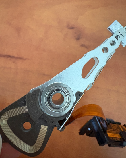

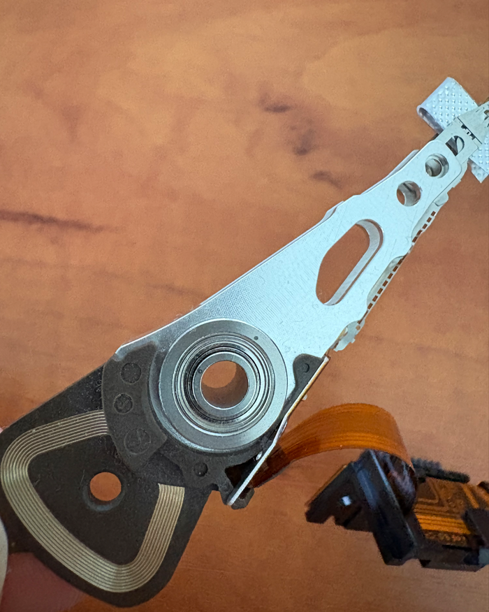

BTW, is this one of those models where the head screw affects the alignment?
yes.

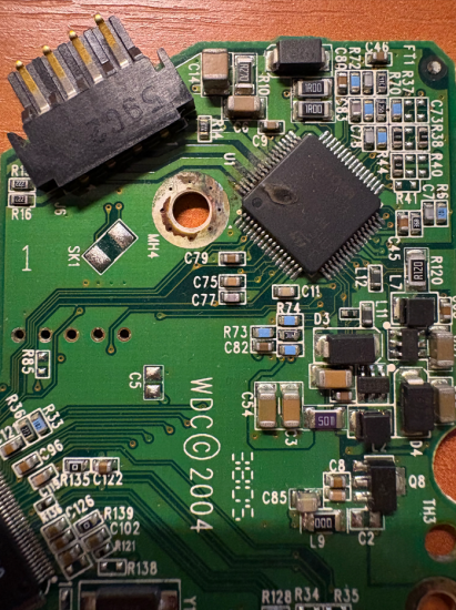

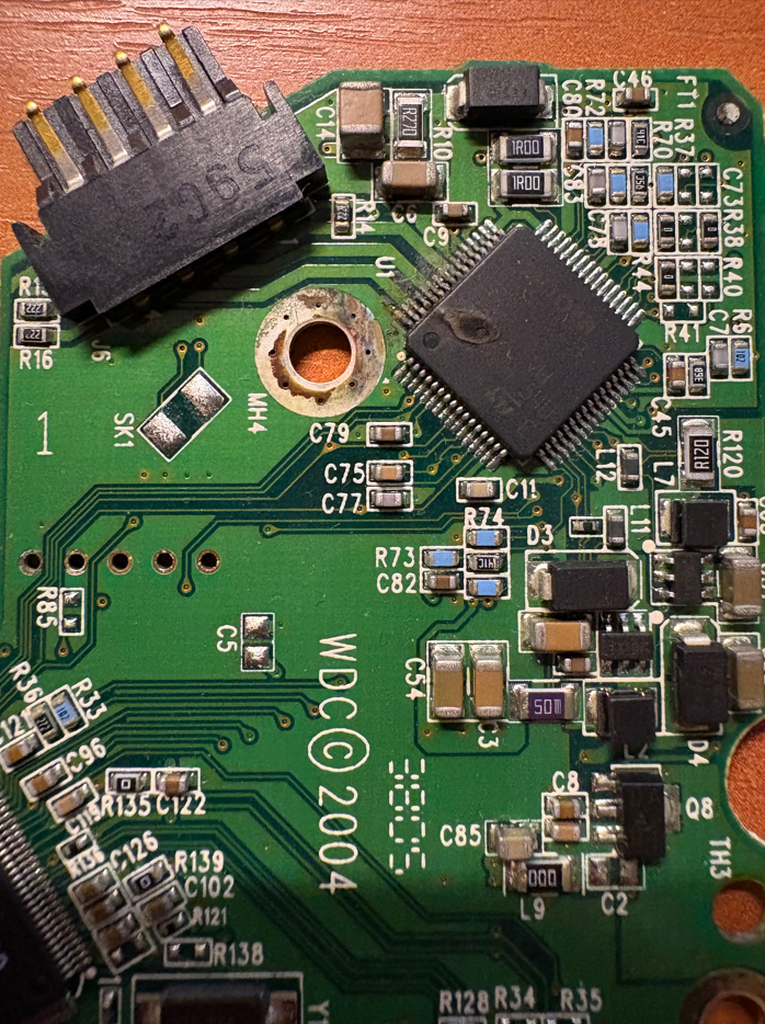

Currently using HDDSuperClone and 48.1GB of data rescued, but the drive has too many bad sectors. Drive has 2785 power cycles and >12799 hours
I have attached images of the burned SMOOTH chip of pacient PCB and original head from pacient, it seems that it has no screw for adjustment or I'm wrong? It just slides off when dissasembly.
When there are good sectors average read speed is ~55 MB/sec, bad sectors skipping or slow read speed ~10 KB/sec
I will let it run day or two and I hope it will complete

hey, was it spinning and clicking with that smooth??
 Post subject: Re: WD800JD-08LSA0 very slow imaging
Hi, yes it was
PostPosted: November 21st, 2025, 15:36
Posts: 17342
It looks like the drive took a hit on the 12V side. That's where the spindle motor and VCM MOSFETs are powered from.
Do you have a dump of the donor ROM?
