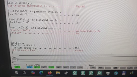

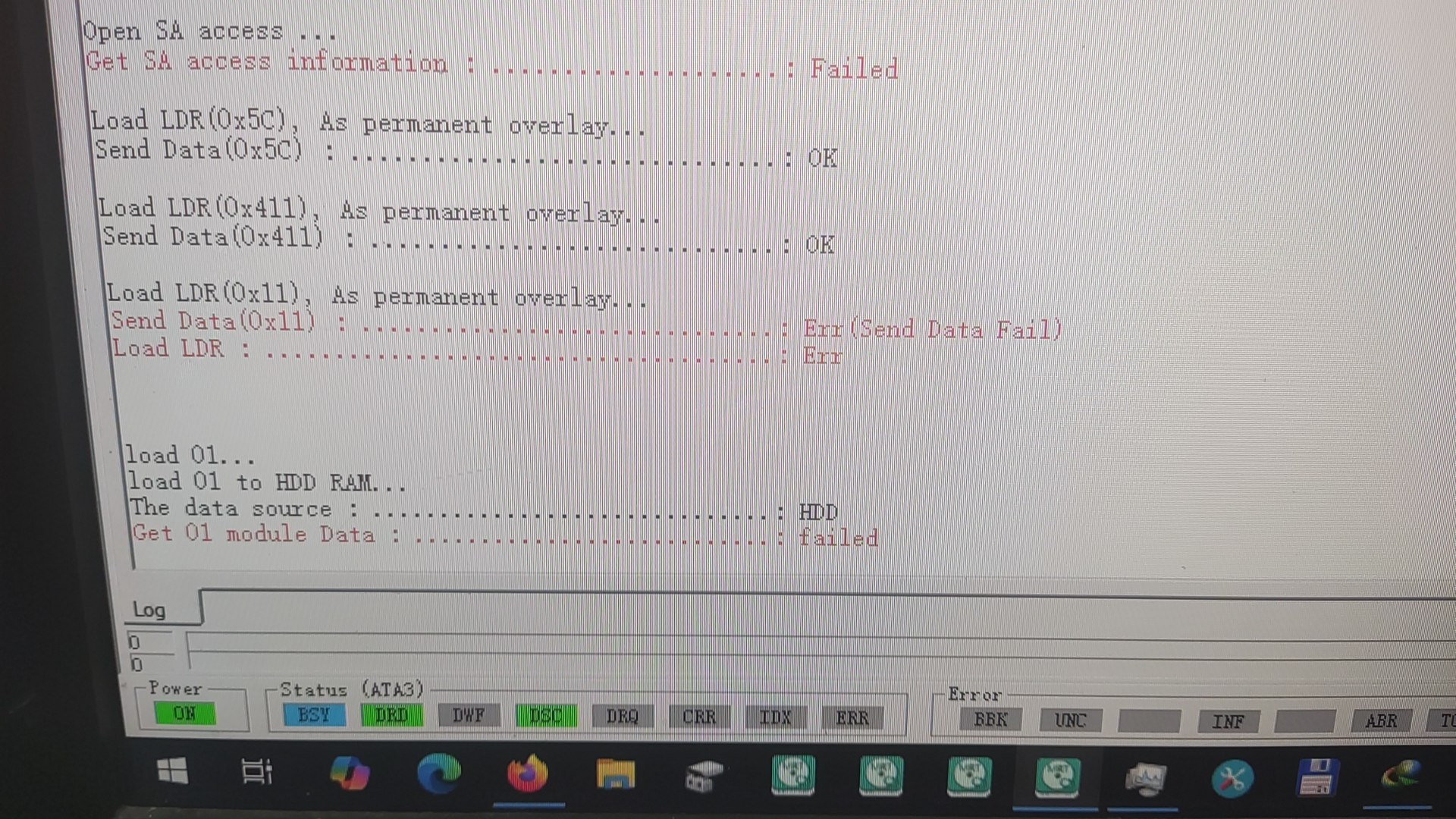

Any compatible loader ?
Using load 01 module into ram
Using load loader

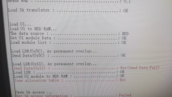

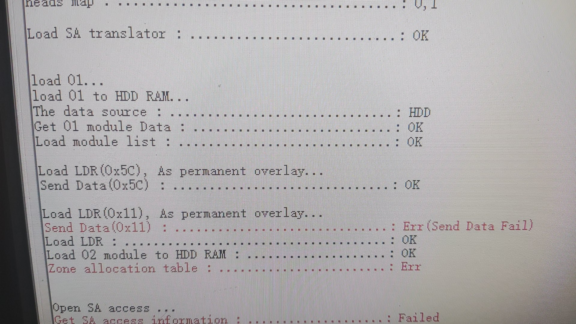

Okay I manage find a loader that give me access to SA, but after try to load 02 to ram hard goes to busy...

Block SA access (SA regions, module 0x30 or 0x411)
Upload DIR and Loader from SA (I think is possible on this model, if not get suitable resource from hddsurgery database based on ROM version of your case)
Now check that SA is accessible and write back here - if is accessible then is possible to try find cause of the problem in SA

Already do that, and have access to SA, but in most of DR cases after load mod 02 UA become accessible, but in this case not!

User area will not be available with 0x411 blocked but SA should be and need to find what fault is. You need to give more information. right now could be many issues, ROM could be not original, some SA adaptive modules could be bad, relocation table could be full causing relo issue - with some SA blocking mechanism present and loader uploaded you can make proper tests of SA to make backup, find any modules that have errors and check condition of modules like 31, 32, 02, 40 etc

ROM is original.
Relocation table has been cleared, and I’ve already tested all SA modules — none of them report any errors.
