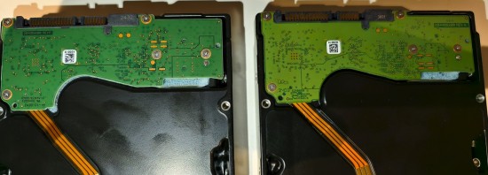

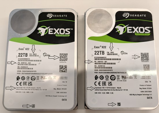

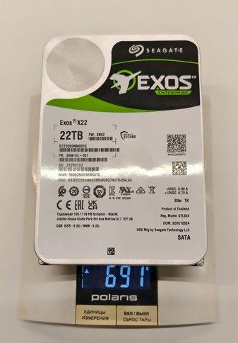

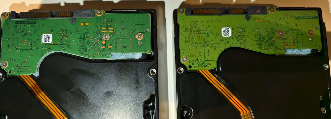

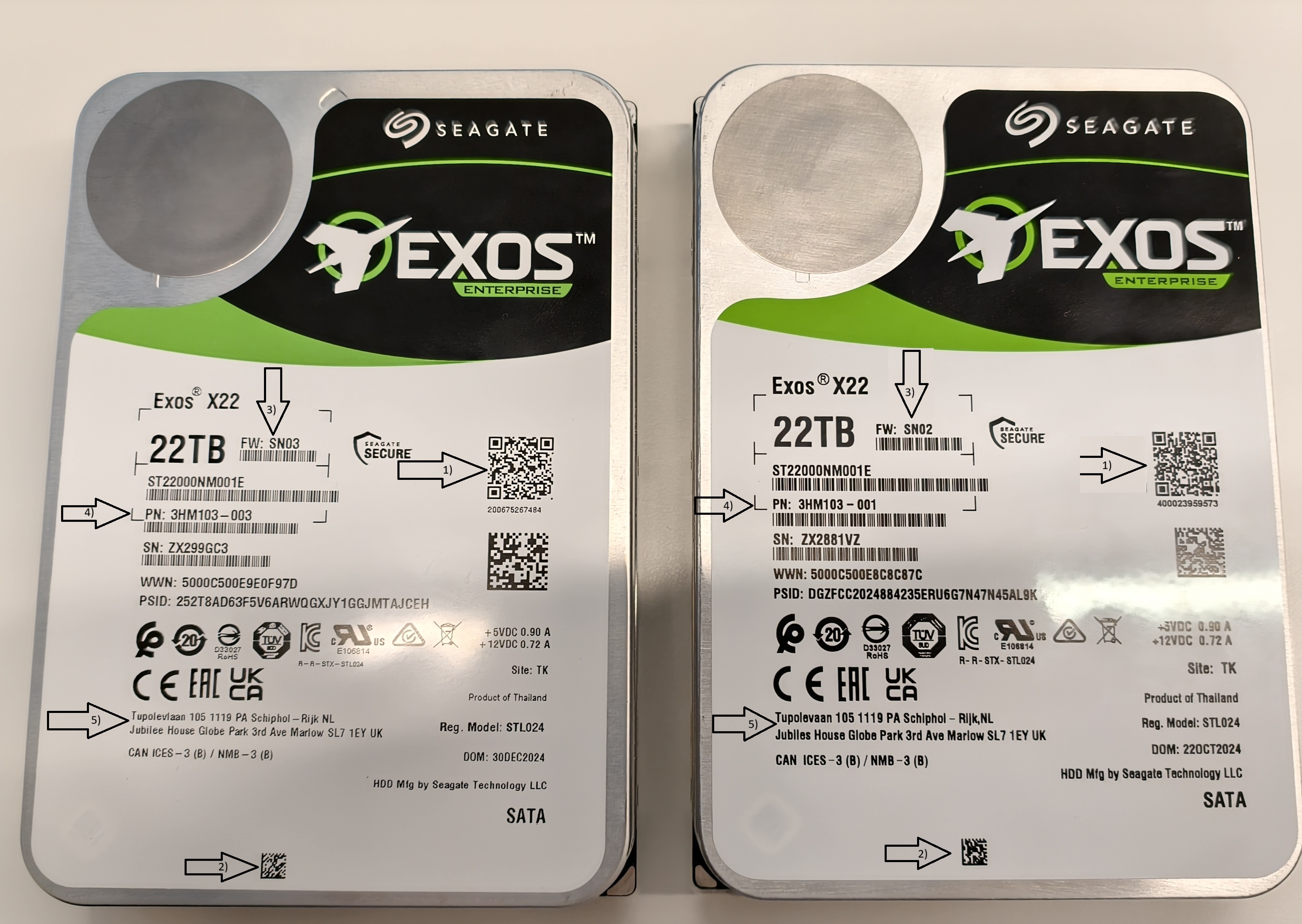

Hello guys!
I need help and advice:
Right now i have 2 discs of same model Seagate X22 ST22000NM001E
On pictures it's the right one. Left one is original
My thoughts:
QR code not original (upper right one and bottom one)
SN of HDD not original
PN of HDD not original
Syntax errors on Seagate adress
Bold Font on sticker
Weight of HDD is 690 g. instead of 680
Different motherboard on back side
What type of tests should i do to check it properly? I read that scammers delete SMART data and FARM also... How i can prove it's fake by software?
Im ready to provide any additional photos you need. In 1-2 days i will have PC with SATA to test this drive

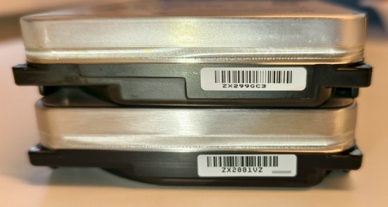

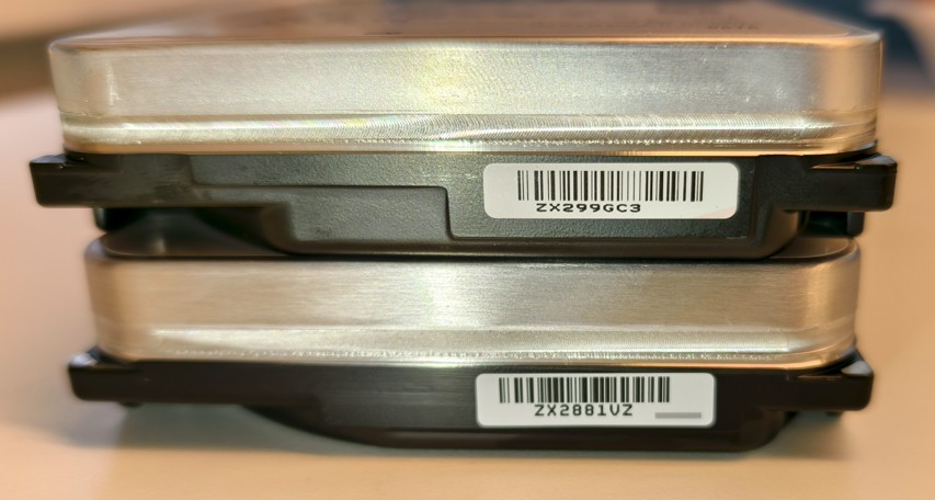

The bad spelling clearly points to a fake.
Check your serial numbers here:
https://www.seagate.com/au/en/support/warranty-and-replacements/
Your Product      Exos X22 22 TB
Model Number      ST22000NM001E
Serial Number     ZX299GC3
Your product is not under warranty. This product was originally sold as a part of a larger system. Please contact the system manufacturer or your place of purchase for warranty support.
Serial Number   ZX2881VZ
Warranty valid until September 13, 2029
The DOM on the label is is 22 Oct 2024, so that's a warranty period of 1 month less than 5 years. That's clearly not right.
The PCBs have date codes of 2439 (left) and 2403 (right). That's week 39 and week 03 of 2024.
Here is a 30TB HDD with the same PCB as your fake:
https://www.kitguru.net/components/hard-drives/simon-crisp/seagate-exos-m-30tb-hdd-review/all/1/

Same PCB here:
https://realhardwarereviews.com/seagate-exos-x24-review/6/

If you want to return the drive, the label with errors in the legal address is sufficient. You won't find old files—I wrote about why.
If you update the firmware (no matter the result), the seller may refuse your return. I would return this HDD if I bought it new.
Unless you're refurbishing it yourself, of course. It's a convenient way to check for discrepancies. :)

The problem is that company bought 1000+ of this fake HDDS - all with fake labels, SN etc.
And seller tells to our stupid IT department, that it's just OEM drives, LOL.
Im working in Corporate Security/Risk Management department and try to find any proofs that it's fake - all what i can.

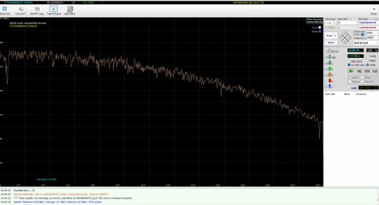

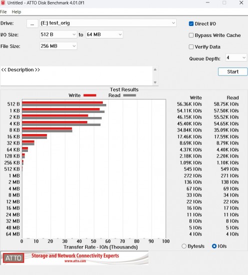

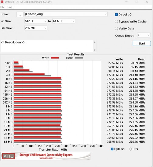

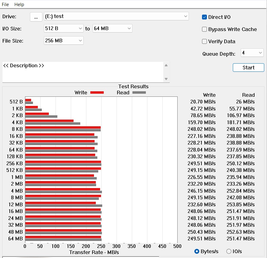

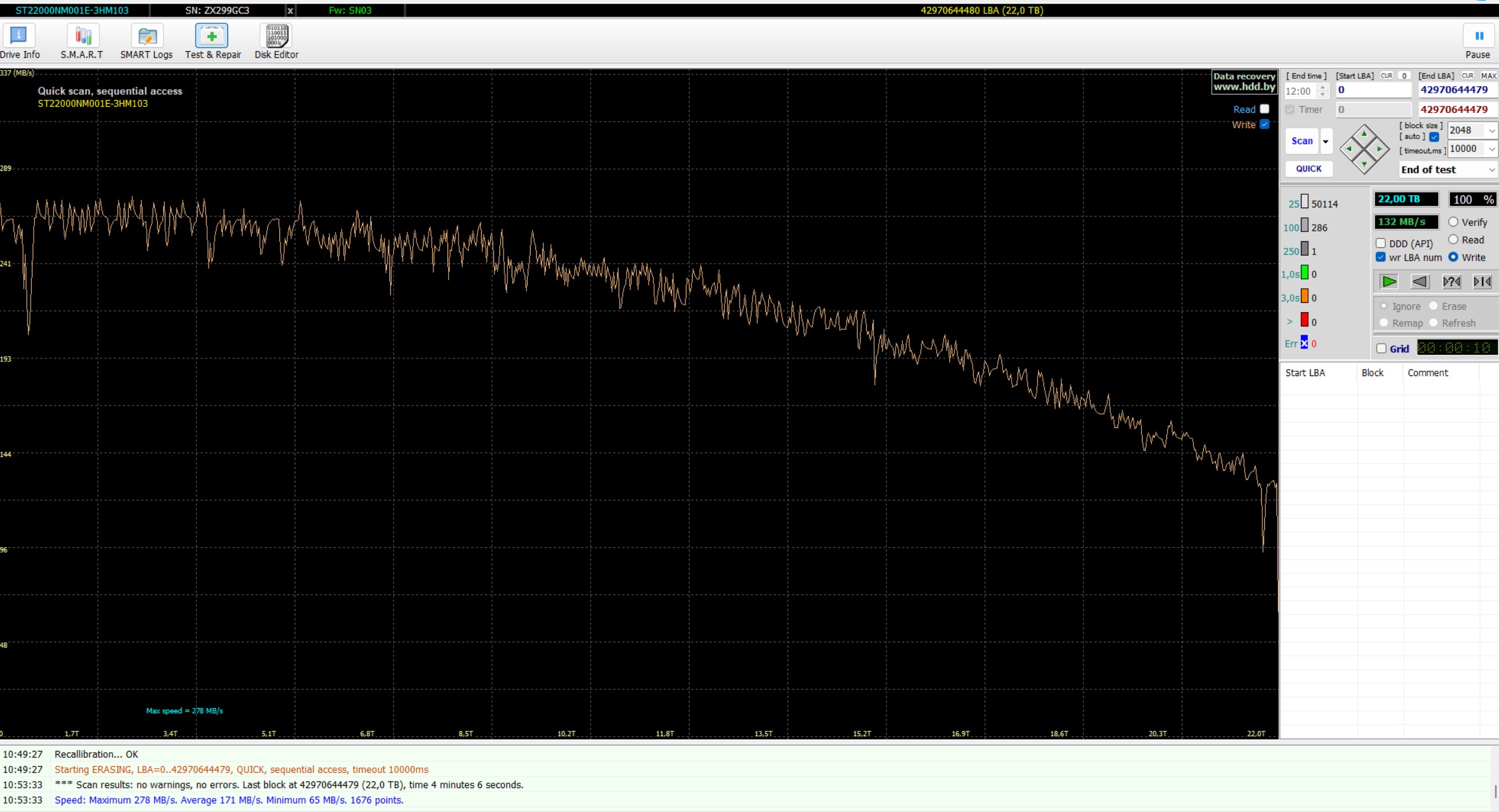

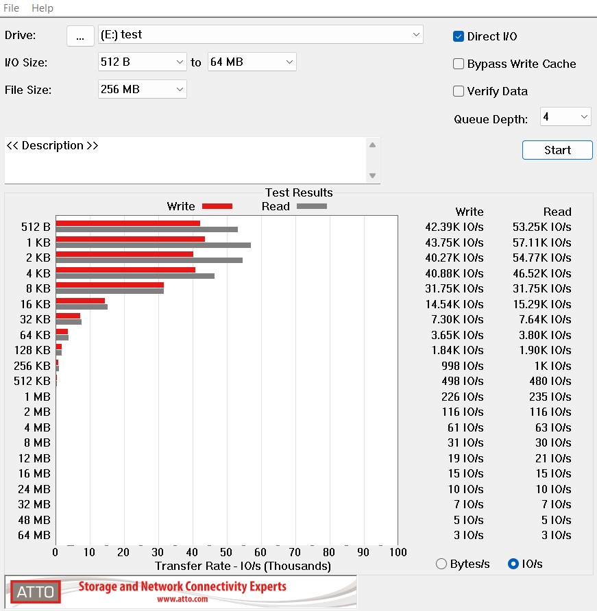

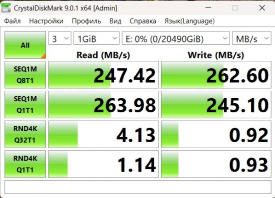

Sooo- what type of drive is that monster with 17 heads for 22 TB drive?

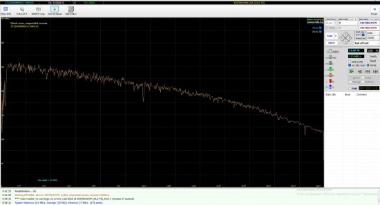

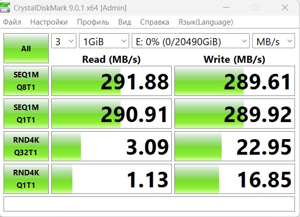

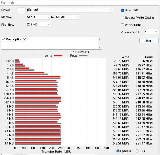

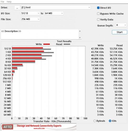

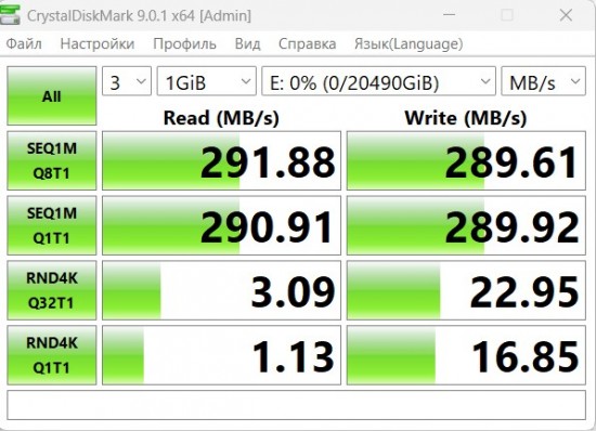

P.s. - i continue tests, attached more tests

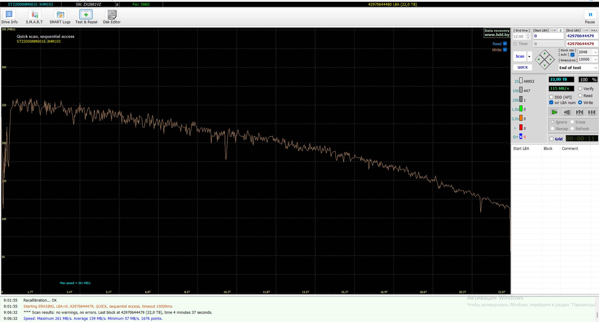

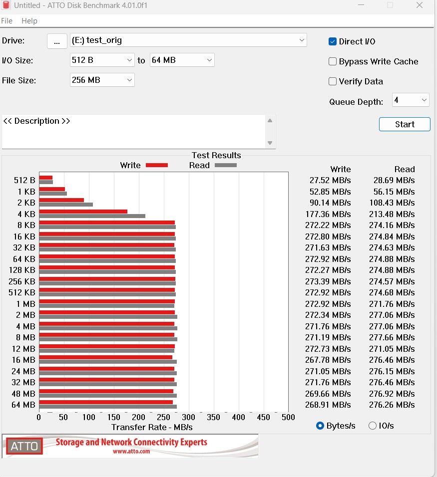

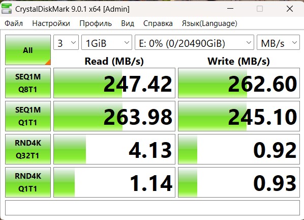

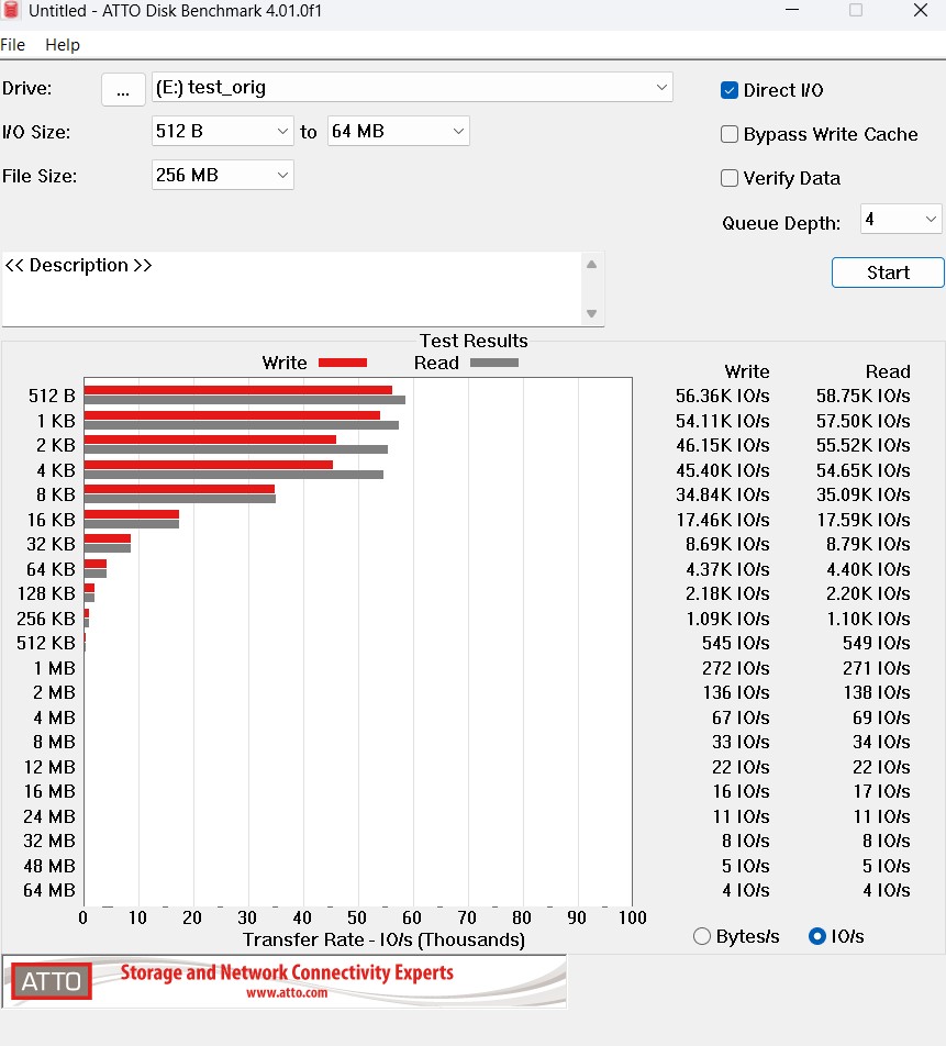

I can't understand what you want. The label is fake and there are 17 heads.
https://www.seagate.com/content/dam/sea ... 12000a.pdf
Table on sheet 7:
ST22000NM001E,
ST22000NM002E
Heads 20
Disks 10
What do your tests tell you? After the WinFof, the HDD is just like factory, except for dust in the hermetic block with damaged surfaces. How long will it take for it to get under the remaining working heads? :)

This fake HDD is Around 10% slower in seq. read/write tests. Another question - what happens with fake HDD if i try to update firmware on it ?

The FARM data must be fake. The manufacture dates on the PCB and in the FARM log are 18 months apart.
    Assembly Date (YYWW): 2531
    Date on PCB : 2403
Both drives have the same capacity, but the fake has a transfer rate which is 10% slower. This means it must have a lower areal density, which in turn means that it must have more heads.
    (No. of heads for fake) = (No. of heads for original) x (1.10)^2 = 20 x 1.21 = 24.2
To me, it looks like the actual number of heads is 24. If you can dump the ROM(s), I should be able to determine the real number of heads from the adaptive segments.
Another way to see the real number of heads would be via a short-stroke read benchmark in HD Tune or Victoria.
How to determine number of heads using HD Tune:
https://www.hddoracle.com/viewtopic.php?f=59&t=650
You will need Firefox to access the site (because of ongoing DDOS attack mitigation).
