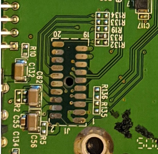

Hi all,
I'm looking for help diagnosing a failed WD1500ADFD Raptor drive. Here's what I know so far:
The Situation
  • The failure occurred after a pinched PSU cable, likely causing a short - possibly on the 12V rail.
  • The drive spins up, and I can feel it vibrating when powered.
  • There are no clicking sounds, no abnormal noises.
  • However, it is not detected in BIOS and does not appear as a connected device.
What I’ve Checked
  • PSU power is confirmed good (12V and 5V clean at the source).
  • No visible damage on the PCB.
  • Previously removed a TVS diode (D3 on the 5V line), but diode tested good - probably didn’t need to be removed.
  • D4 (on the 12V line) tests good in diode mode: ~600mV one way, open the other.
  • No shorts on the 12V input pins at the SATA power connector.
  • Drive stays spinning and does not click or power down, but is not seen by BIOS.
What I Suspect
  • Possibly a blown 0-ohm resistor, fuse, or trace on the 12V line, causing partial power loss.
  • Potential damage to the preamp or motor driver IC (Smooth chip), preventing full initialization.
  • Haven’t done a ROM dump or PCB swap yet, but it’s on the table.
Image of PCB
Looking for Advice
  • What components typically fail on these boards in a 12V short?
  • What else should I test before attempting a ROM transfer?
  • Could partial 12V loss explain vibration/spin-up but no detection?
Thanks in advance to anyone who takes the time to read and help. Really appreciate the expertise here.

D3 and D4 are Schottky rectifiers. They are not TVS diodes. You must NOT operate the drive without them. Serious damage to the MCU or other chips may result. That's because these are the freewheel diodes in switchmode converters.

Since this was happening even before I removed D3, it seems like the MCU or another chip was already toast. Is it even worth getting a chip clip and programmer to dump the U12 BIOS and transfer it to the replacement board as a donor? It’d save me about a week’s worth of setup and config, but it’s not the end of the world. I've been meaning to pick up a programmer anyway.

The problem is most likely internal, ie not PCB related.

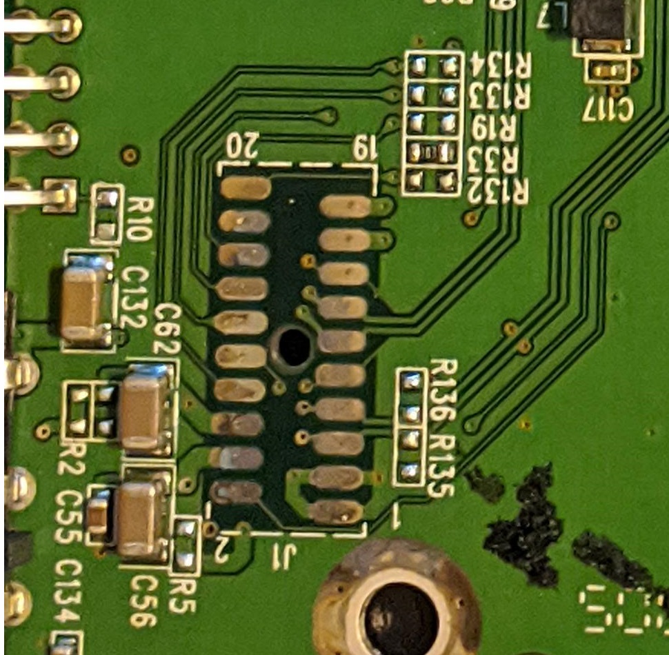

These pads on your PCB are badly corroded, did you clean them properly and tester for continuity?
I had a 2,5" drive for repairs, with corroded pads just like yours. Drive was clicking. I do not remember now was it visible in bios or not.
If pads are in such poor condition, then both pcb pads and connector spring pins must be always cleaned properly, before you move on.
