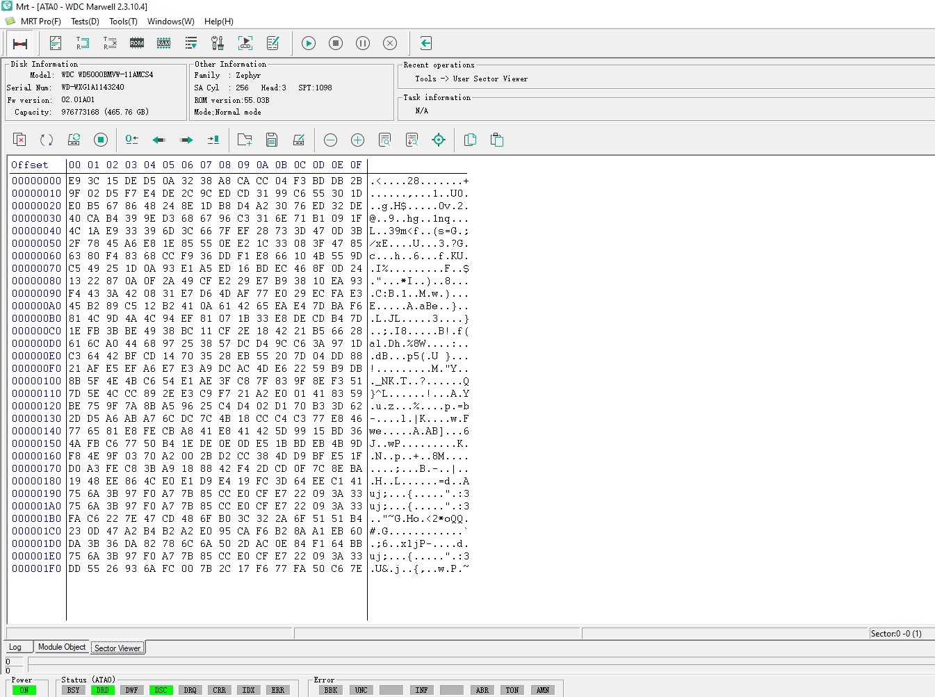

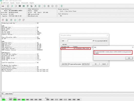

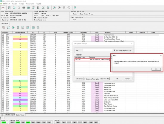

Hello. I have two WD42PURZ drives with defects that need to be hidden; however, current software versions identify the family as "03C1 Unknown," so I assume the drive family is not supported by the programs I have. It fails to read the service area (error 4F10), including the defect lists. How can I resolve this issue? Thank you.

To work with this drive, you need an unlocked ROM, or an unlocked PCB.
