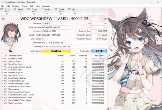

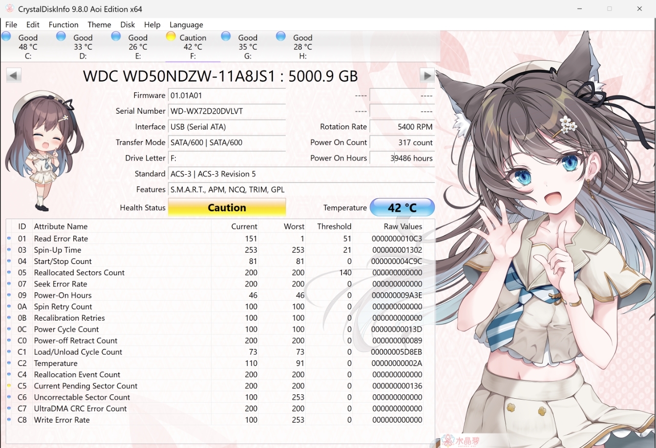

I have a WD Easystore 5tb Which I believe is in the process of failing & am getting the error "The Parameters are Not Correct" When trying to access.
I am including the results of both tests - am looking for any advise on whether
1 - The Drive is Fixable for Use
2 - The Data is Recoverable
3 - The drive should be scrapped (There is no hope for data or usage)
Thanks Very Much For Any Advice !
CHKDSK Results (If any more from the results is needed please let me know) -
Was getting a lot of "A disk read error occurredc00000b5 The disk does not have enough space to replace bad clusters"
667376 files processed.
File data verification completed.
Phase duration (User file recovery): 23.57 hours.
An unspecified error occurred (766f6c756d652e63 4cf).
CrystalDisk Image Attached

Pic Attachment

This is you best DIY option:
https://www.reddit.com/r/datarecoverysoftware/wiki/hddsuperclone_guide/
Be prepared for your drive to fail completely during the attempt.
