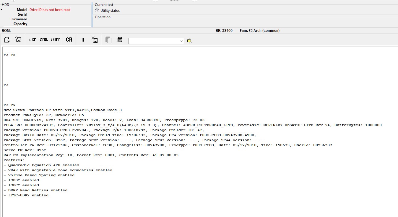

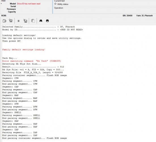

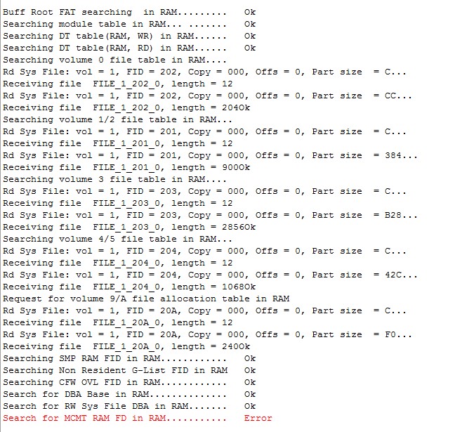

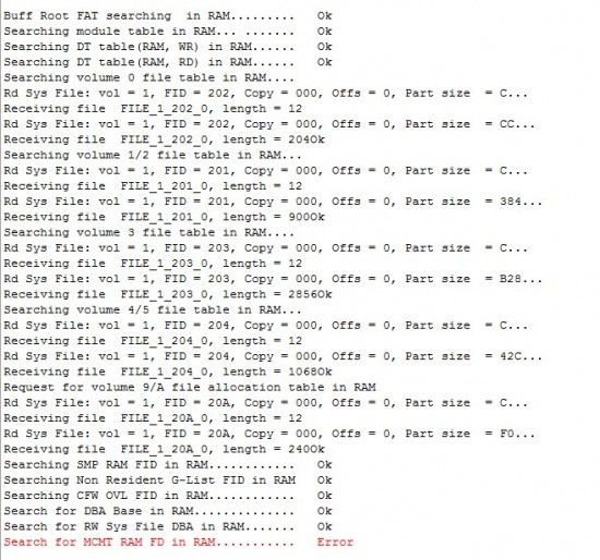

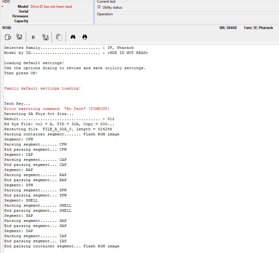

I try to get into the data recovery business and have a HDD here, that I screwed up. There is no valuable data on it, but I want to get it working again in order to learn something.
HDD has been opened and totally disassembled (HSA removed, platter removed) and assembled in a clean room environment.
Now it spins, I hear some HSA activities that stop after some seconds and thats it. Platter still spins but nothing more.
One thing that I´ve noticed. The screwed platter clamp is not perfectly centered causing some minor vibration - I don´t know if thats the issue, but I don´t get it perfectly aligned anymore.
When I start PC3000 the BSY + PHY LEDs are always green.
Utility selection gives an error, since "Drive ID has not been read"
Manually selecting "3F Pharaoh" leads to the error "Error initializing microprogram tables".
Then starting "Alternative initialization" seems to work and I get some data from the drive (see attached log)
Now I am stuck.
How to continue?

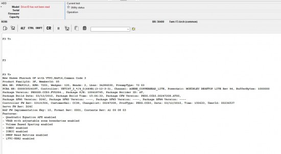

Hi!
With CTRL+X I get the following output.
