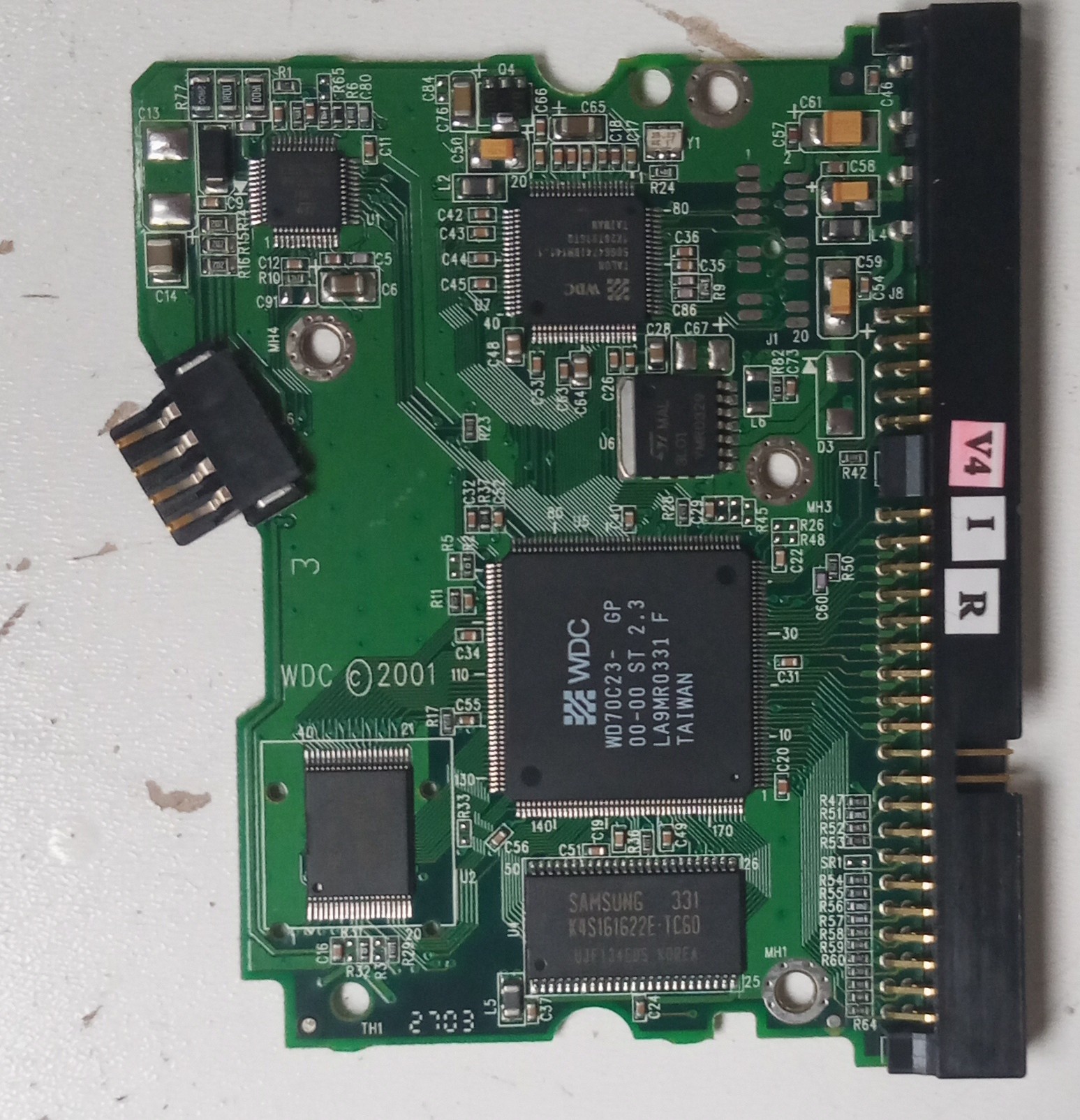

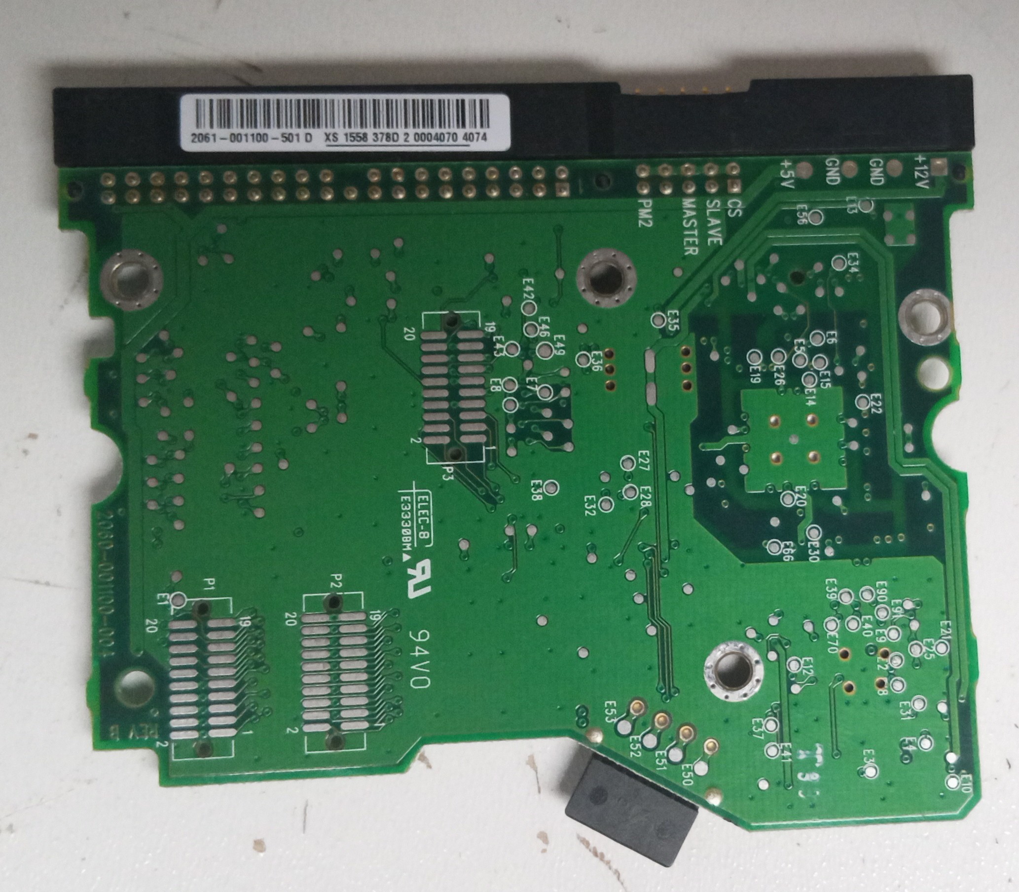

Hi
Recently my WD80EB-28CGH2 drive (might be from an OG Xbox since it was password locked) suddenly died (PC froze and then the HDD started clicking).
At first I thought the platters or heads gave up so I didn't think much of it. Out of boredom I swapped in a PCB from a known good HDD of the same model and turns out, the HDD works just fine. I can read the data and write. Using the bad PCB on the known good drive results in same behavior.
I am thinking it might be the EPROM corruption since the drive with bad PCB mounted isn't detected in BIOS. The PCB markings are 2060-001100-004 REV. B
What are your thoughts on this?

 Post subject: Re: WD80EB-28CGH2 - bad PCB, EPROM corruption?
PostPosted: December 20th, 2025, 12:28
Posts: 17228
Measure the voltages at Q6, U4 and the diode adjacent to the motor controller.
PostPosted: December 21st, 2025, 5:33
Joined: April 2nd, 2024, 3:40
Posts: 167
Location: on lifes edge
Diode near the motor controller:
Cathode: 12.21V
Anode: 11.91V
Voltage rails on U4 (K4S161622E-TC60 SDRAM):
Vdd: 3.27V
Vddq: 3.27V
Couldn't find any component labled Q6, closest I could find was U6 (ST3L01 triple voltage regulator)
Pin 1,4: 0V (GND)
Pin 2: 3.27V
Pin 3: 5.12V
Pin 5: 7.97V
Pin 6: 12.21V
Pin 7: 2.28V
Voltage on Q4: (labled BA QU)
Pin 1: 1.94V
Pin 2/tab: 1.86V
Pin 3: 2.58V
Hope this helps
PostPosted: December 21st, 2025, 14:39
Posts: 17228
Sorry, I meant U6 and Q4.
Pin 7 of U6 should be 2.6V. You have 2.28V. Did you mean 2.58V?
I'm not sure, but I think Q4 may be the pass transistor in a 1.8V regulator, in which case it is OK.
