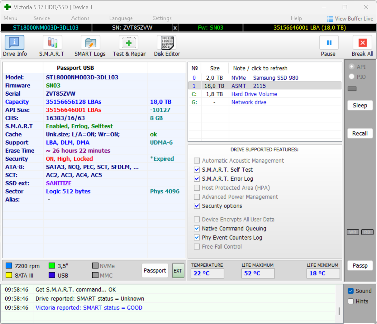

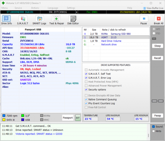

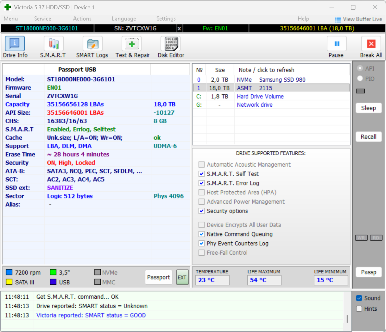

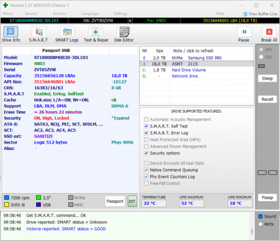

Occasionally, we receive drives back from customers that are password-protected using an ATA password.
Most drives were password-protected during deletion on Synology systems. Removing the password in these cases is straightforward.
However, I have some drives with passwords that are unknown.
I can easily reset SED drives using SeaChest and the `revertSP` command if the password is unknown.
This command doesn't work for non-SED drives, though.
I've tried several commands using SeaChest_Erase (`--revert`, `--revertSP`, `--ataSecureErase`, `--performQuickestErase`) specifying the PSID, but I get an error message every time.
Perhaps I'm simply making a mistake and entering the wrong command.
Is there any way to remove the password from these drives?

I guess sinology NAS boxes used disk passwords as the firmware lacked ext4 security
