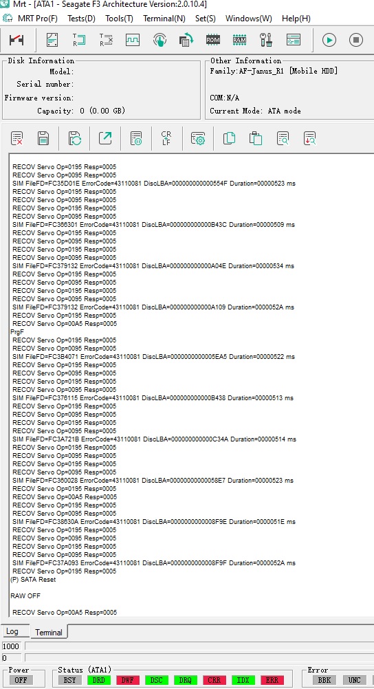

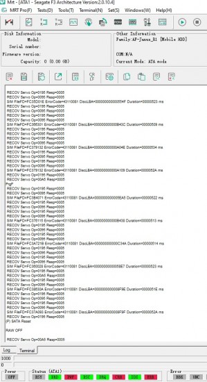

Hi everyone,
I have a Seagate ST2000LM007 that stays BSY and cannot be identified.
I attempted a head swap with a donor ST2000LM007, but the drive still does not come ready. In MRT terminal I get repeated servo recovery / FAIL Servo Op errors during startup.
To rule out damaged heads, I moved the donor heads back from the patient into the donor, and the donor works normally and identifies correctly., so the heads appear to be OK. I also checked under the microscope, and the head pattern looks identical/similar between the two drives.
In MRT I also noticed that the firmware family is different between the two drives:
Patient shows AF – Janus
Donor shows A5 – CheopsLite
Does this behaviour point to a head compatibility / family mismatch issue, or could it still be surface / SA damage, or something else?

a full log would be helpful instead of that screenshot.
If the drive loads DiscFw on its own, i guess SA is corrupted severely due to write problems.
Other cause may be non-native pcb but we need to see full log to determine that. Especially if that log was taken using virtual start.

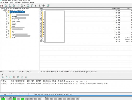

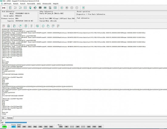

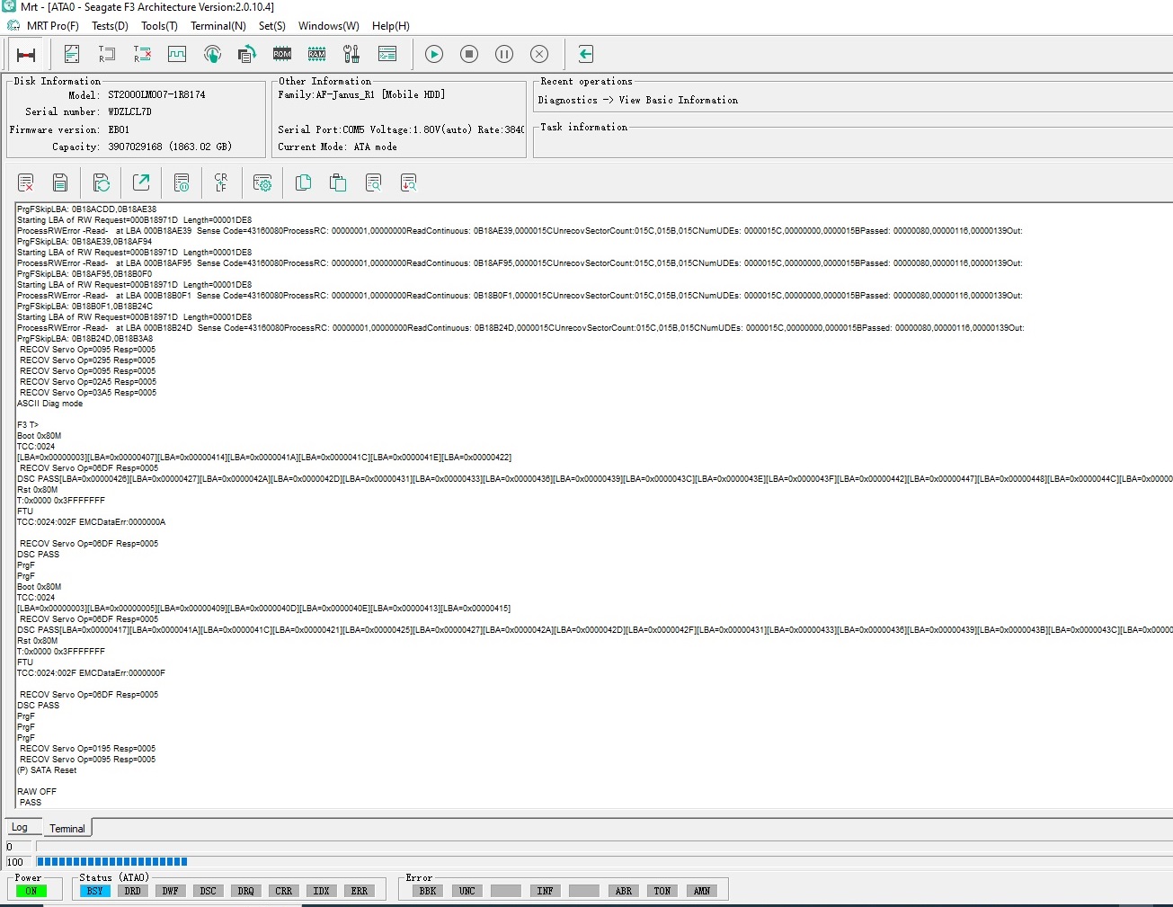

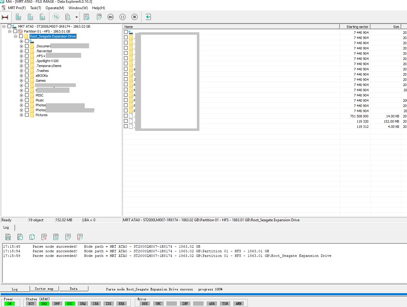

Thanks everyone for your replies. I bought a third donor and just swapped heads.
Donor details:
Model: ST2000LM007
SN: WDZNKPAK
PN: 1R874-570
FW: EB01
Site: WU
Date: 05 NOV 2019
The patient drive can now identify, and in DE I can see all client data and files.
However, in the MRT terminal, I still get repeated RECOV Servo / EMCDataErr messages during startup. It seems that system files and SA modules cannot be fully loaded, which prevents me from creating a head map.
Should I proceed with imaging, or is there a way to fix this issue?

I have done probably a couple hundred of these for recovery and I rarely ever check the preamp. Only thing I check for is if the drive is alt or default for head type. These drives dont care about preamp from my finding.
What they are picky about sometimes is manufacture data. But I have also had drives just straight up not be compatible even though they are exact matches. I would recommend getting another set of heads. Try to get as close to the manufacturing data as you can. This is important to hopefully have heads that can write and fix firmware after the head swap.
The fact the drive is coming ready is good. You are able to get the drive to ID, access the SA etc?
have you checked to see what firmware modules are damaged?
Those sim errors are because system files are not being read.
Remember, take your time. Be persistent. If you have doubts stop. Check, then proceed again.
