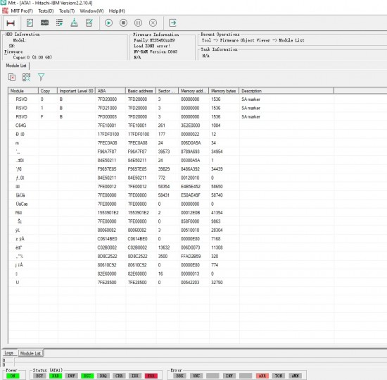

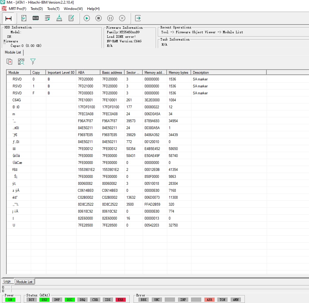

Hi everyone,

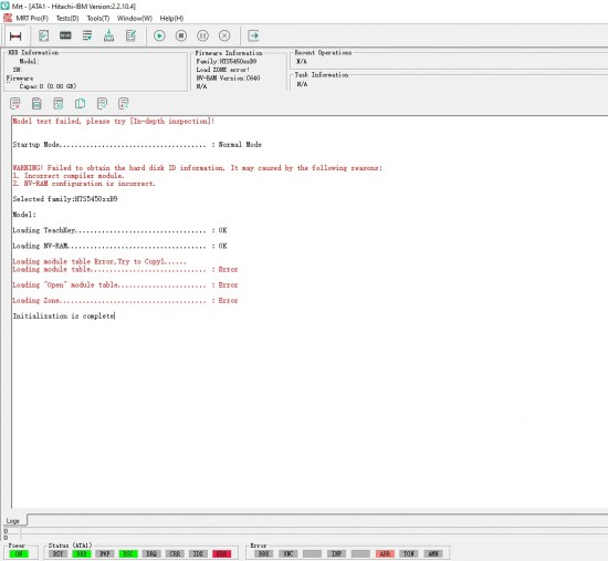

I’m working on a Hitachi HTS545025B9A300 (250GB).
Originally Head 0 was dead and Head 1 was working, and the drive could identify in MRT and read by H1. After a head swap, both H0 and H1 were working, and I managed to image about 60% of the drive. After that, the drive failed again: Now neither H0 nor H1 can read and the drive does not identify. Drive spins normally, heads move twice, then goes to READY.
To rule out heads, I moved the head stack back to the donor drive, and both heads work fine there, so the heads and preamp appear to be OK.
I backed up all resources while the drive was still identifying.

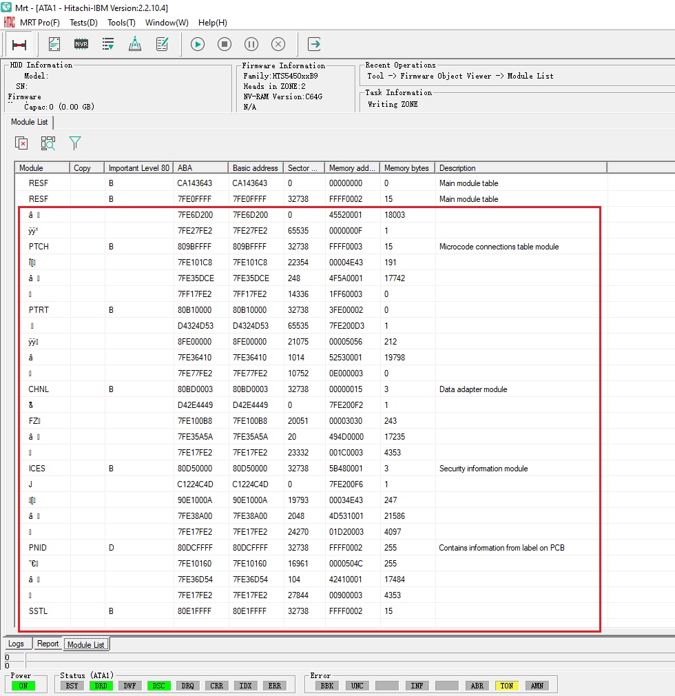

At the moment, when checking modules, I only get this output, which looks corrupted (see attached screenshot).
Has anyone seen this behavior before on Hitachi drives?
Any advice would be appreciated.
Thanks in advance.

NV-RAM seem to be got corrupt.
If you did backup the fw resourse when it was ok, you might try to rewrite it from backup.

I tried rewriting the NV-RAM from my backup, but the behavior is still the same — the drive cannot be identified.

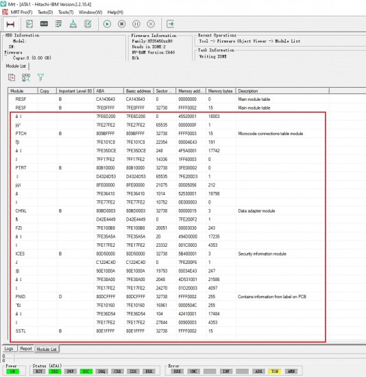

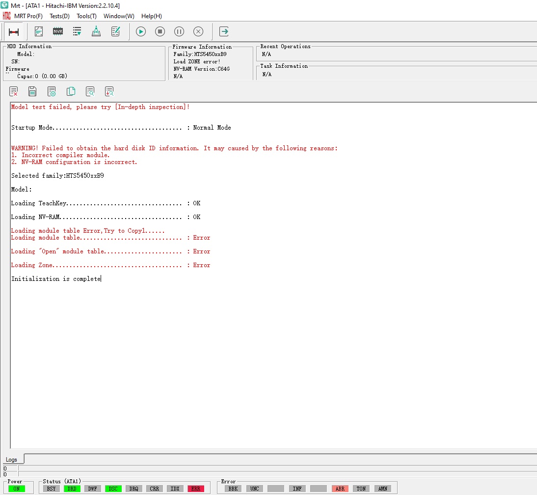

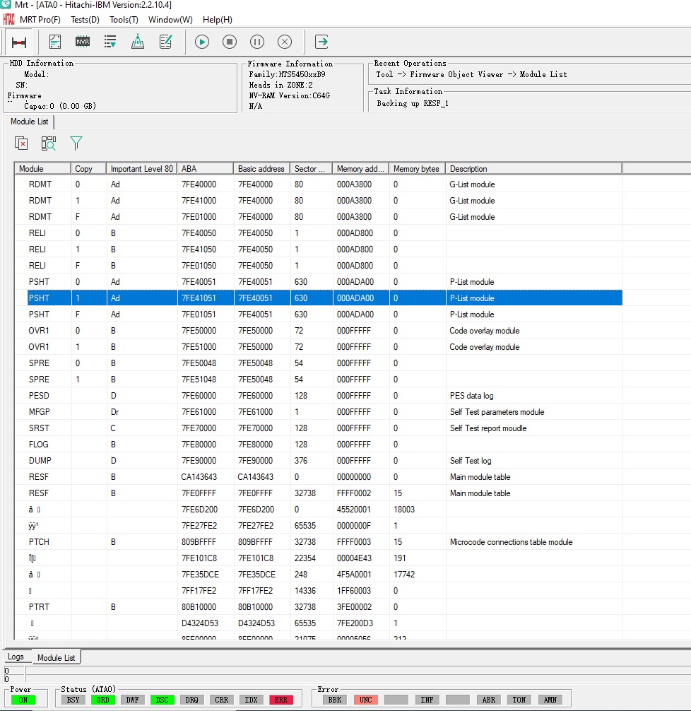

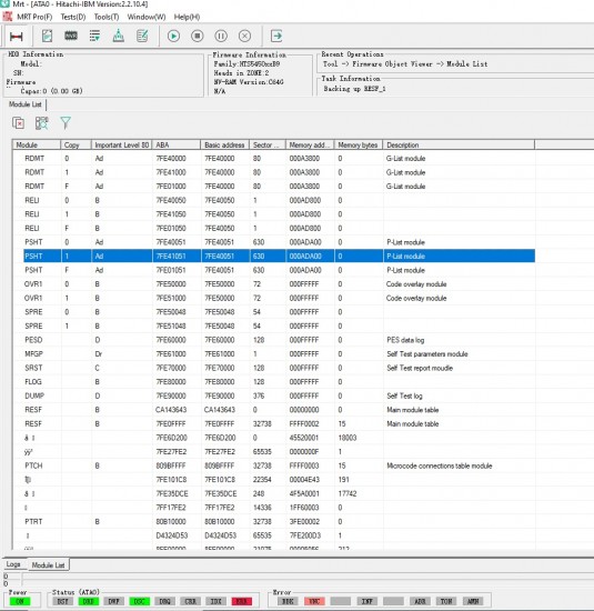

PostPosted: January 11th, 2026, 1:45
Joined: February 12th, 2021, 1:27
Posts: 76
pepe wrote:
HTS541010A7E630 is an arm based drive while the OP's drive is pre-arm, there are quite some differences. My 2 cents go to SA corruption due to non-native heads, if the heads prove to be OK back in the donor...
Thanks everyone for the replies.
Just to be sure it's not head issue related, I purchased another donor drive and performed another head swap, but the behavior is still the same.
I also tried rewriting the NV-RAM from backup, with no change.
Below is the report from the SA Structural Testing:

Candidate............................... :
Total hidden (cand.).................... : 238
Total hidden (grown).................... : 238
Information about factory copy
Module not loaded! ID = RSVD Copy F; SA marker
Error : Module is not loaded! (RSVD, SA marker)

 Post subject: Re: Hitachi imaged 60%, now no ID, heads OK, possible SA iss
PostPosted: January 11th, 2026, 23:56
Posts: 76
I checked the SA modules again and noticed that RDMT copy 0 and copy 1, as well as PSHT copy 0, are accessible and readable.
However, PSHT copy 1 cannot be accessed or read, which suggests that Head 1 cannot read PSHT copy 1.
I tried rewriting PSHT copy 1 from backup. MRT reports the write as successful, but after resetting the drive and attempting to read it again, it still returns a read error.
Could this unreadable PSHT copy 1 be the reason the drive cannot identify?
Is there any way to temporarily bypass or relocate this module to allow identification and recover the remaining data?
Any advice is appreciated.
PostPosted: January 12th, 2026, 0:37
Posts: 17342
Could you upload your RESF module? I have no idea what needs to be done, but I could at least analyse RESF and identify some free space in the SA for you.
PostPosted: January 12th, 2026, 0:47
Posts: 76
Here is the RESF copy 0. RESF Copy 1 is not accessible, reads error.
RESF.rar [639 Bytes]
Downloaded 169 times
PostPosted: January 12th, 2026, 12:13
Posts: 17342
It seems that your module list contains modules that aren't in the RESF module table. Therefore I am unable to reliably determine the free areas. Sorry.
Edit: The RSVD module may contain the extra modules. Could you upload that?
I wonder if your writing problem is related to microjogs. AIUI, a microjog is the distance between the read and write elements in the head. If you use the patient's microjogs to write with a donor head, then the data will be written slightly off-track. Could this disparity be sufficiently great to make the written data unreadable?
PostPosted: January 12th, 2026, 12:56
Posts: 17342
These are the modules sorted by ABA:
PostPosted: January 12th, 2026, 13:12
Posts: 17342
ID  : Copy :  Importn.:    ABA   :    ABA   :    Size :    Read :  Size : Address in : Read :   Hdr : Description
     :      :          :          :(original):   (sect):   (sect): (byte):     RAM    :      :       :
xxxx :      :          : 7FE27FE2 : 7FE27FE2 :    65535  :       0 :        1 :  0000000F  :   No :       :
xxxx :      :          : 7FE35A5A : 7FE35A5A :     20  :       0 :    17235 :  494D0000  :   No :       :
The extent of the first module is 0x7FE27FE2 + 65535 = 0x7FE37FE1.
The next module begins at ABA 0x7FE35A5A. This means that the first module overlaps the second, which suggests that something isn't right. However, these could be "junk" modules that don't really exist.
PostPosted: January 12th, 2026, 20:14
Posts: 76

Thanks for taking the time to look at it and the explanation, that makes sense.
Here is RSVD copy 1
Yes, I also noticed that there are several modules with strange characters / unreadable IDs in the module list (screenshot attached). These modules were not present when I originally backed up all resources while the drive was identifying. They seem to have appeared later at some stage during the recovery attempts.
RSVD.rar [143 Bytes]
Downloaded 177 times
PostPosted: January 12th, 2026, 20:56
Posts: 17342
I was hoping that RSVD might contain another table of modules, eg the Factory copy, but clearly that's not the case. I would need to examine a full resource dump, before and after, to learn something about this firmware architecture. There has to be another table somewhere, possibly even in the ROM.
PC3K's list of modules, when sorted, has numerous holes in the ABA areas. If you were to write your PSHT module to one of these holes, you would then need to edit every table so that they all point to the module's new location in the SA.
PostPosted: January 12th, 2026, 21:49
Posts: 17342
I'm extremely confused. Do Copy 0 and Copy 1 refer to modules on head #0 and #1, respectively? If so, then where is the Factory copy located?
If each head has Factory Copy, Copy 0 and Copy 1, then why bother with Copy 1 if Copy 0 is readable?
How can we tell if ABA 0x7FE210F2 is on head 0 or 1? Or is it on both?
I’ve backed up the full resources before and after the issue occurred. I noticed that now many modules from copy 1 are missing that were present before the failure I know analysing this is quite a lot of work, so I’m just uploading them here in case anyone would like to take a look.
Thanks for your help and insights — I really appreciate it.
SABackup After.rar [832.26 KiB]
Downloaded 202 times
SABackup Before.rar [497.87 KiB]
Downloaded 183 times
PostPosted: January 13th, 2026, 0:53
Posts: 17342
ABA(Factory) = ABA(original) - 0x20000 + 3
RESF :   F  :      B   : 7FE00003 : 7FE20000 :      2  :       2 :        0 :  000FFFFF  :  Yes :    Ok : Main module table
RAM0 :   F  :      B   : 7FE00005 : 7FE20002 :    165  :       0 :        0 :  00058800  :   No :       : Code module
OVR0 :   F  :      B   : 7FE000AA : 7FE200A7 :     18  :      18 :        0 :  0006D200  :  Yes :    Ok : Overlay module
RESF :   F  :      B   : 7FE000BC : 7FE200B9 :      2  :       2 :        0 :  000FFFFF  :  Yes :    Ok : Main module table
PTCH :   F  :      B   : 7FE000BE : 7FE200BB :      3  :       3 :        0 :  000FFFFF  :  Yes :    Ok : Microcode connections table module
CNS1 :   F  :      B   : 7FE000C1 : 7FE200BE :      1  :       1 :      456 :  00035BCE  :  Yes :    Ok : HDD logical configuration module
RWCN :   F  :      B   : 7FE000C2 : 7FE200BF :      1  :       1 :      248 :  00035DCE  :  Yes :    Ok :
ZONE :   F  :     Ad   : 7FE000C3 : 7FE200C0 :     17  :      17 :     8182 :  00033800  :  Yes :    Ok : Zone allocation table module
PTRT :   F  :      B   : 7FE000D4 : 7FE200D1 :      2  :       2 :     1568 :  00003FE0  :  Yes :    Ok :
SMRT :   F  :      B   : 7FE000D6 : 7FE200D3 :      1  :       1 :        0 :  000FFFFF  :  Yes :    Ok : S.M.A.R.T. module
SRVP :   F  :     Ad   : 7FE000D7 : 7FE200D4 :      2  :       2 :     1014 :  00036410  :  Yes :    Ok : Module contains cylinder defects table
ABA(Copy 0) = ABA(original)
RESF :   0  :      B   : 7FE20000 : 7FE20000 :      2  :       2 :        0 :  000FFFFF  :  Yes :    Ok : Main module table
RAM0 :   0  :      B   : 7FE20002 : 7FE20002 :    165  :     165 :        0 :  00058800  :  Yes :    Ok : Code module
OVR0 :   0  :      B   : 7FE200A7 : 7FE200A7 :     18  :      18 :        0 :  0006D200  :  Yes :    Ok : Overlay module
RESF :   0  :      B   : 7FE200B9 : 7FE200B9 :      2  :       2 :        0 :  000FFFFF  :  Yes :    Ok : Main module table
PTCH :   0  :      B   : 7FE200BB : 7FE200BB :      3  :       3 :        0 :  000FFFFF  :  Yes :    Ok : Microcode connections table module
CNS1 :   0  :      B   : 7FE200BE : 7FE200BE :      1  :       1 :      456 :  00035BCE  :  Yes :    Ok : HDD logical configuration module
RWCN :   0  :      B   : 7FE200BF : 7FE200BF :      1  :       0 :      248 :  00035DCE  :   No :       :      <--- BAD
ZONE :   0  :     Ad   : 7FE200C0 : 7FE200C0 :     17  :      17 :     8182 :  00033800  :  Yes :    Ok : Zone allocation table module
PTRT :   0  :      B   : 7FE200D1 : 7FE200D1 :      2  :       2 :     1568 :  00003FE0  :  Yes :    Ok :
SMRT :   0  :      B   : 7FE200D3 : 7FE200D3 :      1  :       1 :        0 :  000FFFFF  :  Yes :    Ok : S.M.A.R.T. module
SRVP :   0  :     Ad   : 7FE200D4 : 7FE200D4 :      2  :       2 :     1014 :  00036410  :  Yes :    Ok : Module contains cylinder defects table
ABA(Copy 1) = ABA(original) + 0x1000
RESF :   1  :      B   : 7FE21000 : 7FE20000 :      2  :       0 :        0 :  000FFFFF  :   No :       : Main module table     <--- BAD
RAM0 :   1  :      B   : 7FE21002 : 7FE20002 :    165  :       0 :        0 :  00058800  :   No :       : Code module     <--- BAD
OVR0 :   1  :      B   : 7FE210A7 : 7FE200A7 :     18  :       0 :        0 :  0006D200  :   No :       : Overlay module     <--- BAD
RESF :   1  :      B   : 7FE210B9 : 7FE200B9 :      2  :       0 :        0 :  000FFFFF  :   No :       : Main module table     <--- BAD
PTCH :   1  :      B   : 7FE210BB : 7FE200BB :      3  :       0 :        0 :  000FFFFF  :   No :       : Microcode connections table module     <--- BAD
CNS1 :   1  :      B   : 7FE210BE : 7FE200BE :      1  :       1 :      456 :  00035BCE  :  Yes :    Ok : HDD logical configuration module
RWCN :   1  :      B   : 7FE210BF : 7FE200BF :      1  :       0 :      248 :  00035DCE  :   No :       :      <--- BAD
ZONE :   1  :     Ad   : 7FE210C0 : 7FE200C0 :     17  :       0 :     8182 :  00033800  :   No :       : Zone allocation table module     <--- BAD
PTRT :   1  :      B   : 7FE210D1 : 7FE200D1 :      2  :       0 :     1568 :  00003FE0  :   No :       :      <--- BAD
SMRT :   1  :      B   : 7FE210D3 : 7FE200D3 :      1  :       0 :        0 :  000FFFFF  :   No :       : S.M.A.R.T. module     <--- BAD
SRVP :   1  :     Ad   : 7FE210D4 : 7FE200D4 :      2  :       0 :     1014 :  00036410  :   No :       : Module contains cylinder defects table     <--- BAD
All 4 copies of RESF in Copy 0 and Copy 1 are identical. The two copies in the Factory Copy are identical, but they differ slightly from Copy 0 and Copy 1. Also, the factory copy is a different version.
Do the results indicate that the SA is divided into areas of size 0x1000 (= 4096) sectors? It appears that we start with head 0, read 0x1000 sectors, then switch to head 1, read another 0x1000 sectors, then switch to head 0 and repeat.
PostPosted: January 13th, 2026, 3:06
Posts: 76
Yes. Based on comparing the ABA locations of the same modules across Copy 0 and Copy 1, there is a consistent +0x1000 (4096 sector) offset, which indicates that the SA is divided into 0x1000-sector areas
Thanks for your detailed analysis and help — much appreciated.
