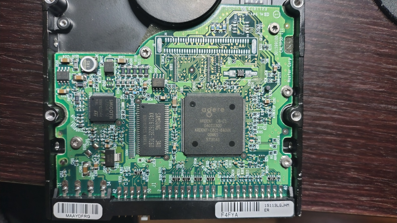

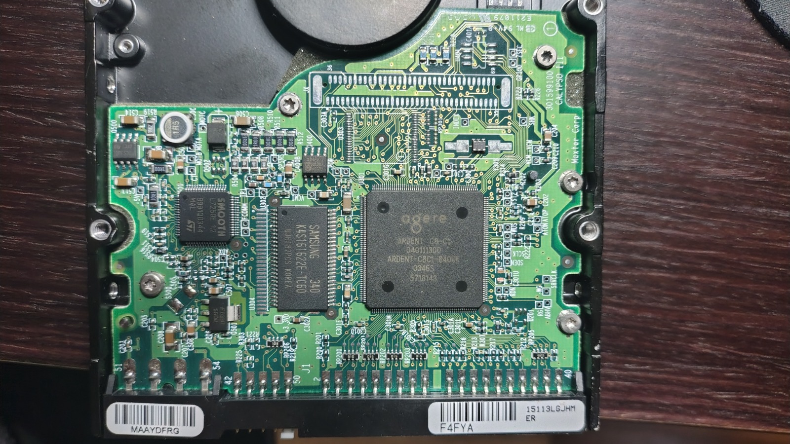

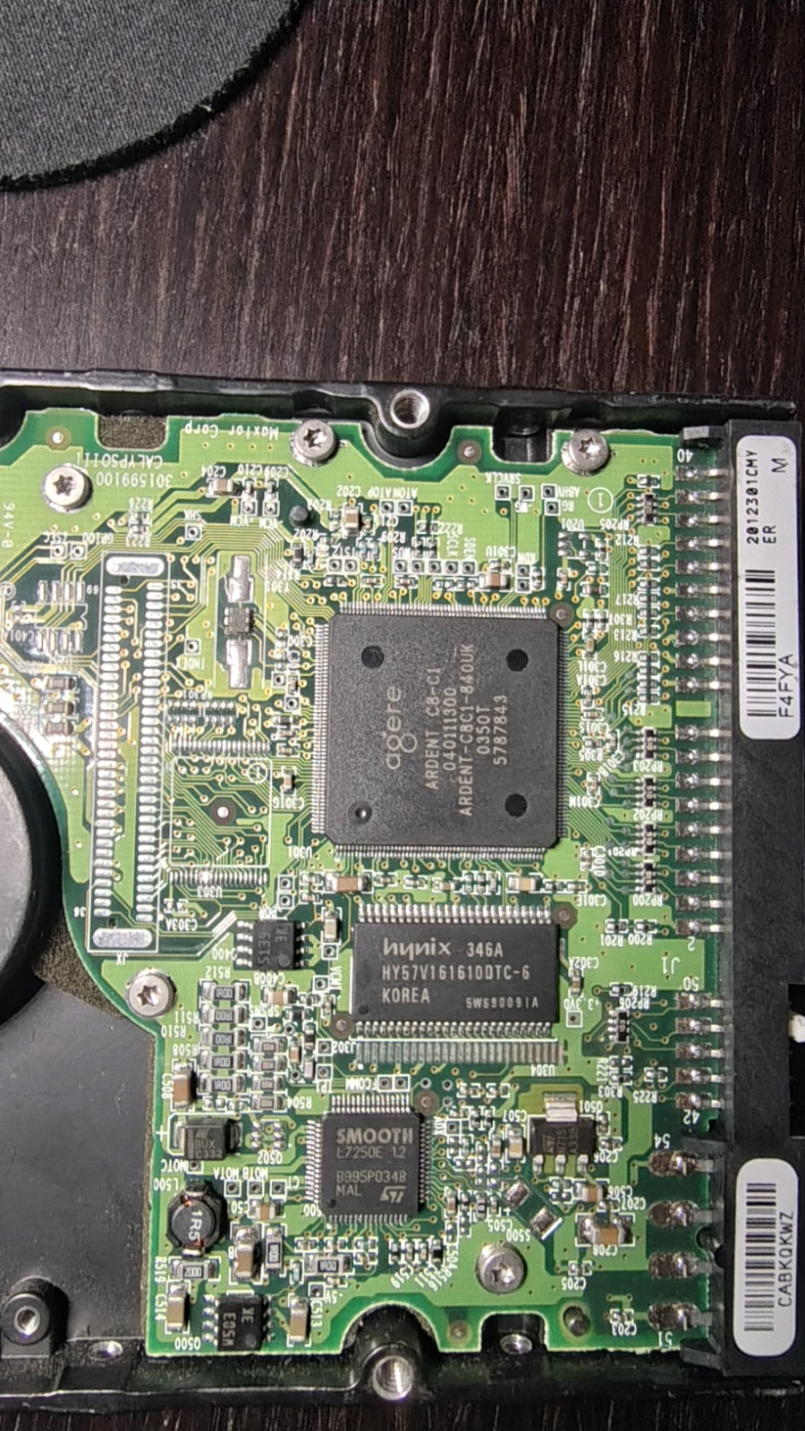

Hi fzabkar and pepe,

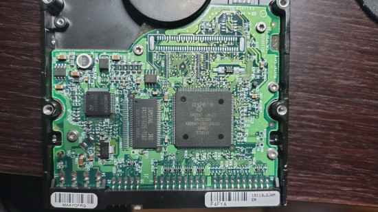

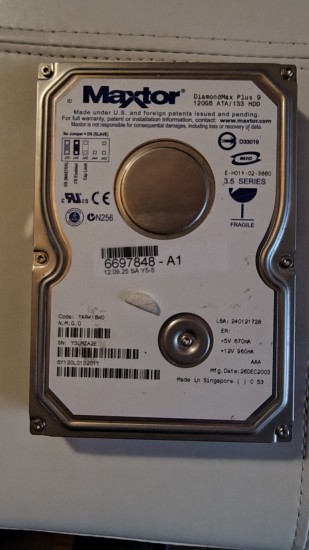

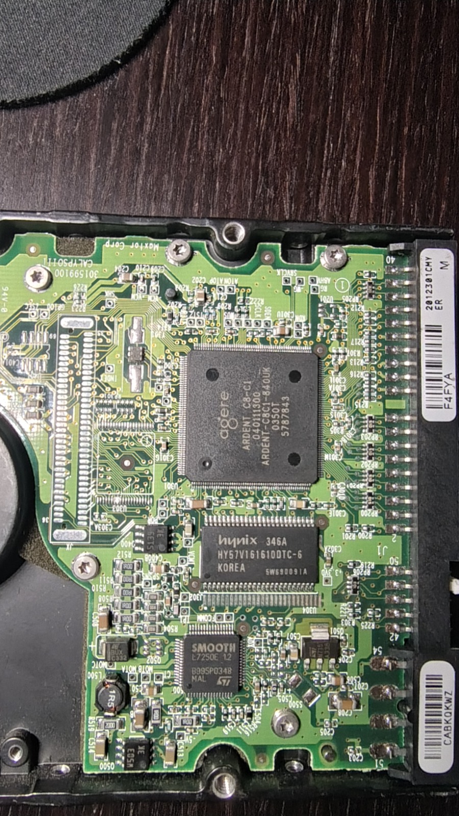

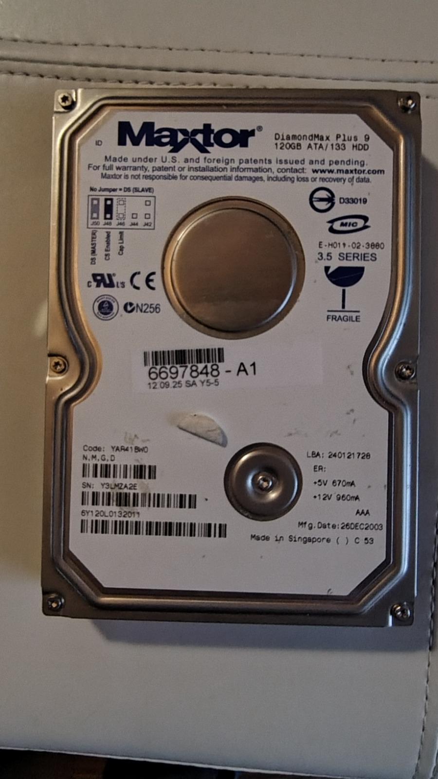

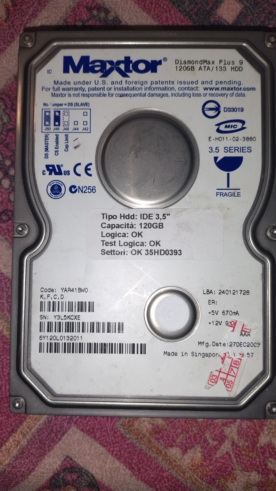

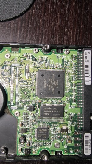

Thank you for the feedback. As requested, here are photos of both the donor PCB and the PCB currently on the patient drive.
I'm not sure if the patient's PBC is original or not.
fzabkar, looking at the ICs and the PCB date codes, do you see any major mismatch that could explain why the adaptives wouldn't initialize?
Thank you for your invaluable time.

 Post subject: Re: Firmware Reconstruction for Maxtor DiamondMax Plus 9
PostPosted: January 23rd, 2026, 13:56
Joined: January 20th, 2026, 10:24
Posts: 6
Location: Italy
Hi fzabkar, pepe, and everyone,
Thank you for your guidance. I have taken photos of both the donor PCB and the PCB currently attached to the patient drive.
I'm not sure if the PCB on the patient's hdd is the orginal or not.
Technical Details from the Chips:
Donor PCB - Mfg. Date 27 Dec 2003 - Code: YAR41BW0
Main Controller IC:
AGERE
ARDENT C8-C1
040111300
ARDENT-C8C1-840UK
0350T
5787843
Motor Controller:
hynix 346A
HY57V161610DTC-6
KOREA 5W69009IA
Other Chip (don't know name)
SMOOTH
L7250E 1.2
B995P0348
MAL
Patient Drive Info - Mfg. Date 26 Dec 2003 - Code: YAR41BW0
(maybe not the original one)
Main Controller IC:
AGERE
ARDENT C8-C1
040111300
ARDENT-C8C1-840UK
0346S
5718143
Motor Controller:
SAMSUNG 340
K4S161622E
UJH182PCS KOREA
SMOOTH
L7250E 1.2
B991Q0344
MAL
@fzabkar: Based on the date codes and the IC versions shown in the photos, do you believe this specific Calypso revision stores unique adaptive data in the MCU, or could a straight PCB swap (or simple firmware transfer) work if the components match closely enough?
I'm looking forward to your analysis of the board revisions. Thank you!
PostPosted: January 23rd, 2026, 15:27
Posts: 17342
            Donor          "Patient"
Manf date   27 Dec 2003    26 Dec 2003
MCU (YYWW)  0350           0346
SMOOTH      0348           0344
SDRAM        346            340
PCB         ????           4203 (WWYY)
The labels of the two HDDs indicate that they were manufactured one day apart in the same country. The PCBs appear functionally identical, except that several ICs are sourced from different manufacturers. However, the "patient" PCB appears to have been assembled around 4 to 6 weeks before the donor, if you compare the Year/Week date codes on the ICs.
That said, the two MCUs have the same code version, and both contain mask ROMs, ie no flash memory. Furthermore, there are no external flash memories at U401 or U303. This means that any adaptives are located in the "discware" on the platters, not on the PCB.
Since the patient PCB predates the donor PCB by one month, and since the two PCBs are functionally identical, I would expect that your donor PCB is a direct match for the original PCB. No modifications required.
As for the physical aspects of the two drives, the model number code, 6Y120L0132011, indicates that both drives have 3 heads, if I understand correctly. I don't know whether this means that there actually 3 physical heads, or it could be that there are 4 heads, with one being switched off. This might come into play if a head swap is required.
I'm not a data recovery pro, but it seems to me that either your drive has a head fault, or media damage, or firmware damage in the discware (as @pepe has suggested).

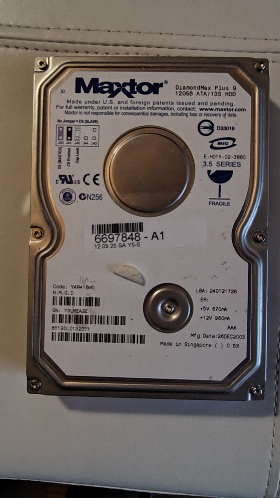

Hi fzabkar,
First of all, thank you very much for your time and for the invaluable information you provided.
I have an update: I tested the patient drive by connecting it directly to the native IDE port using the donor PCB. The drive spins up, but it emits rhythmic clicking sounds (about once per second). After a few sequences of clicks, the motor spins down and stops completely.
I have now reinstalled the donor PCB back into its original drive to keep everything in order. It seems like a mechanical failure or a serious System Area issue. What is your take on this behavior?
Thanks again for your help!

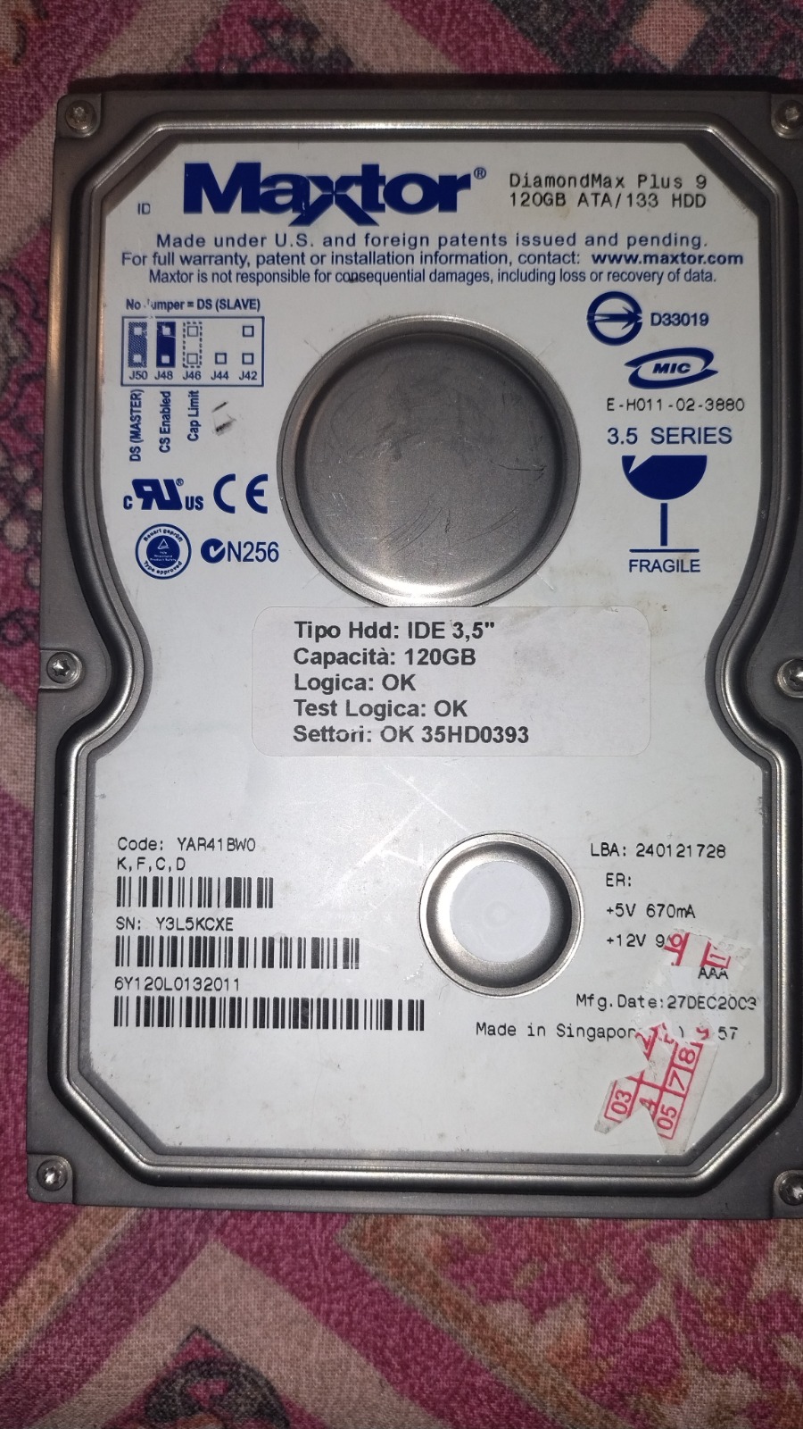

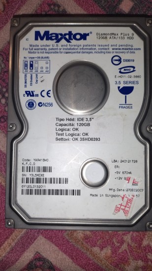

PostPosted: January 24th, 2026, 12:34
Posts: 17342
Do both PCBs produce the same symptom?
If I understand correctly, in cases of a head transplant, the Code on the label should match. Yours are NMGD and KFCD for patient and donor, respectively. Like I said, I'm not a pro.
https://www.donordrives.com/blog/matching-guide#maxtor
https://hddguru.com/articles/2006.02.17-Changing-headstack-Q-and-A/
I can't understand why two drives manufactured one day apart in the same country/factory should have differing headstack codes. Perhaps my assumption that the same PCB was used for all drives during that one month period is wrong?

Hi fzabkar,
Thank you for pointing out the difference in the headstack codes (NMGD vs KFCD). That is a very interesting observation.
However, I must share a crucial detail that I had overlooked: there is a strong possibility that the PCB I considered "original" until now was actually a replacement installed back in 2004 during a first, failed attempt to fix the drive. This would explain why Ontrack found it "non-original" and why they couldn't find the unique adaptive data on it.
If my memory serves, the drive might have been "mismatched" for over 20 years. This makes your find about the new donor (Dec 27, 2003) being a "direct match" even more significant—it might actually be closer to the real original than the one I’ve had for years.
Given that the symptom persists with a functionally identical PCB, do you think the next logical step is to assume the "discware" (Service Area) is corrupted, or is that clicking sound more likely a sign that the heads (NMGD) simply cannot calibrate using the donor's MCU parameters?
Thanks again for your incredible insight!
PostPosted: January 24th, 2026, 13:21
Posts: 17342
If the original symptoms, with the original PCB, match the current symptoms, then it's an internal fault, probably bad head(s).
