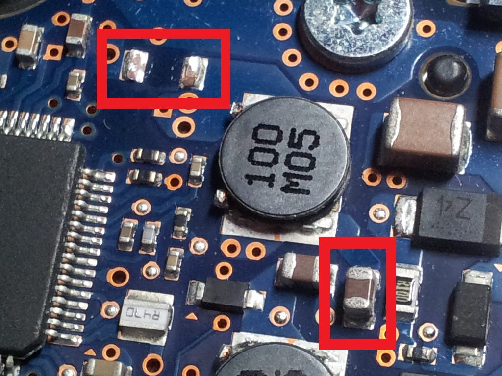

I bought this hard drive today for a little under $3 :D But it's not working because it won't spin up. While deciding whether to buy it or not, I noticed that some SMD components were missing from the board. When I received it, I looked closely and saw that one capacitor was missing and another had been torn off the board. This circuit looks like a voltage regulator, so it's no surprise the drive isn't working :lol:
I can replace them, but I have no idea what capacitance these capacitors should be. I hope some of you have an LCR meter :D
P.S. I already tried soldering the torn capacitor back and took a capacitor that I think is suitable, which was located between +5V and GND, right where the SATA power connector is located, and replaced the missing one, but the drive still won't spin up. The board appears to be receiving power and showing signs of life, as the computer's BIOS displays a faulty IDE device error when I connect a drive to it, and at least the ROM chip is receiving 2.5V on the VCC pin...
Of course, I could find another identical drive that's clicking and just replace the board, but I don't want to invest more money because I don't know if this drive was working before I bought it, and the seller doesn't know either :( I want to try fixing this board, but I can't figure out why it's still not working.
P.P.S. HDD model is Hitachi HUA722020ALA331, PCB P/N is 110 0A90201 01

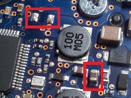

Visually there is no other damage on the board except what I found, but maybe I'm missing something.

Measure the resistances of the 12V and 5V TVS diodes (SUA and ZA) near the SATA power connector. Also measure the resistances of the two R100 resistors (0.1 ohm) in that same area.
Measure the voltage between ground (any screw hole) and the 1R1 inductor adjacent to the motor controller. That's Vcore. Then measure the voltage between ground and the nearest inductor (100) adjacent to the motor controller. That's Vio.
The two 100/M05 inductors near the SATA connector constitute a Cuk converter which produces the -5V supply for the preamp. You should find +5V and -5V on the capacitors in that area.

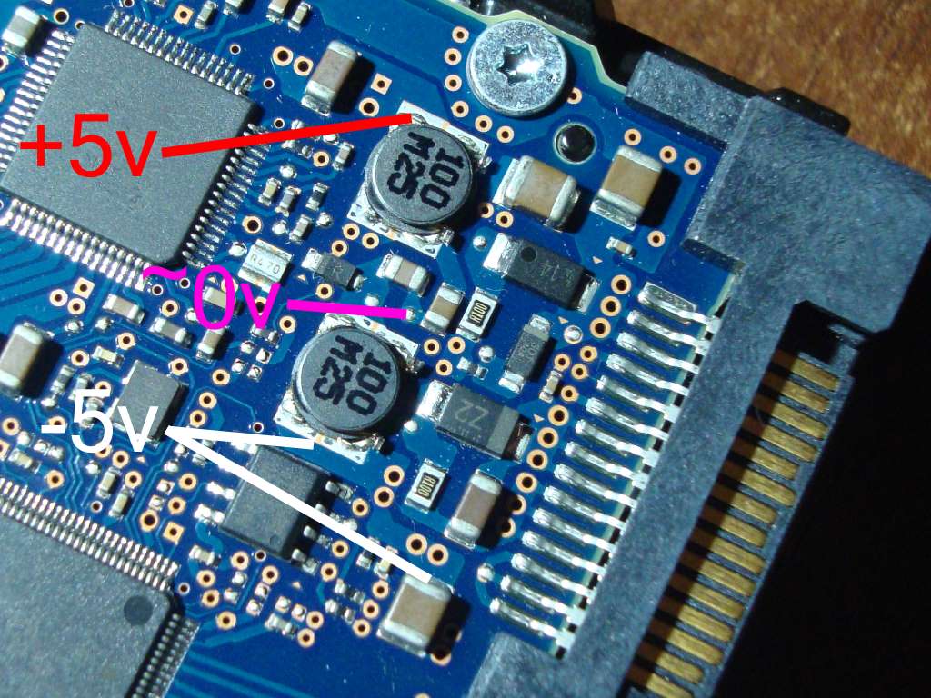

In short, there is no -5V.
The diode on the 5-volt line (SUA in the photo) has a resistance of 1.17K Ohms in both directions; a little later, for some reason, it began to measure 10K Ohms in both directions.
The diode on the 12-volt line (Z4 in the photo) has a resistance of approximately 32.7K Ohms.
Both of these resistors have a resistance of about 0.1-0.2 ohms. My multimeter is very bad at measuring resistances below 1 ohm.
The Vcore voltage is 1.26 V or 1.32 V, depending on which side of the inductor coil the measurement was taken from. The Vio voltage is 2.62 or 2.58 volts.

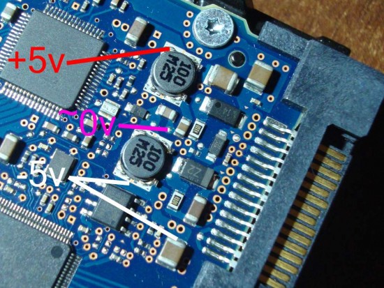

I found a positive 5V voltage where the capacitor was missing, but there doesn't seem to be a negative 5V voltage. I took a few working Hitachi 7K1000 hard drives I have, which have slightly different controller boards but the same VCM driver and surrounding components, and found that the negative 5V voltage should be on the inductive coil closest to the ROM chip, on the side facing the ROM chip, and on the large capacitor located next to the 3.3V power pins on the SATA power connector.
But on the damaged PCB the voltage is 0 volts where it should be -5 volts, and there is a strange decreasing voltage between the two capacitors where on good drives the voltage in that spot is around 0 volts.
