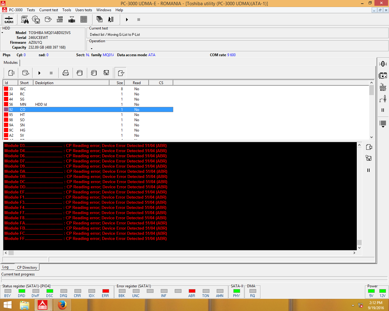

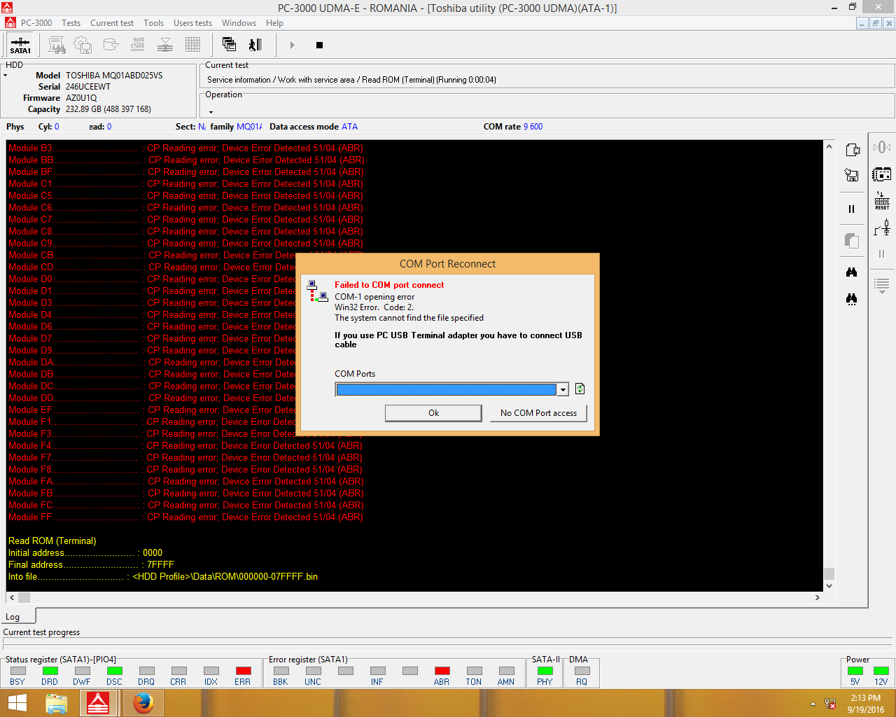

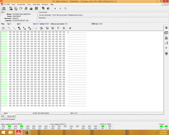

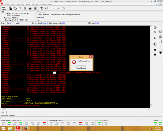

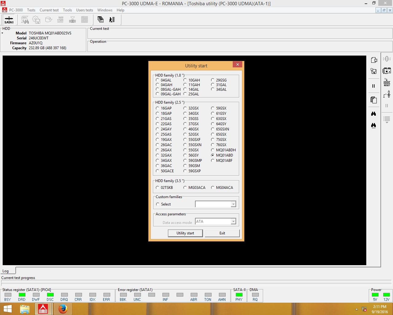

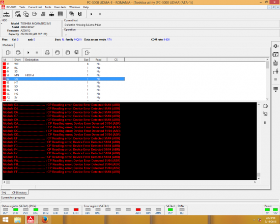

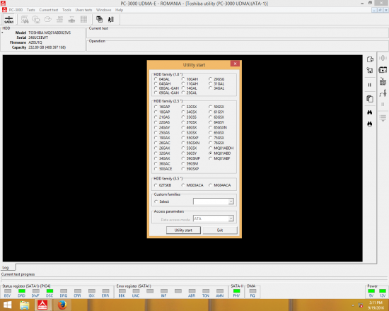

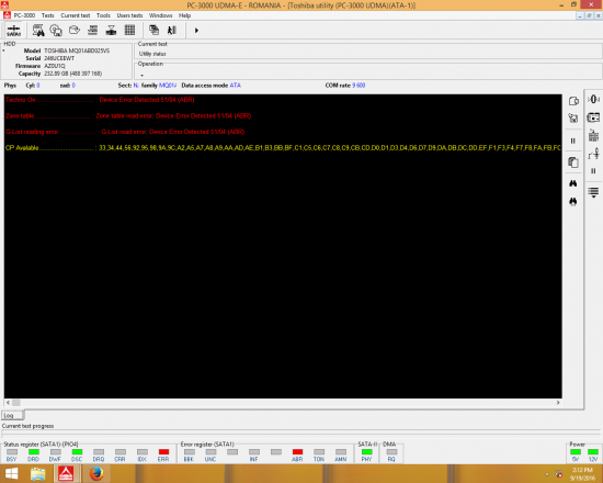

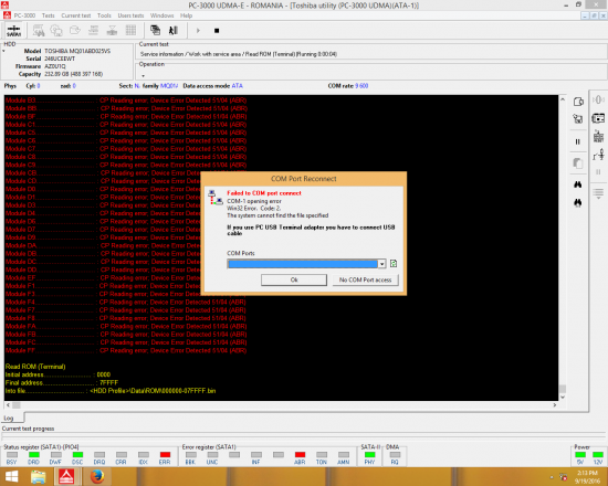

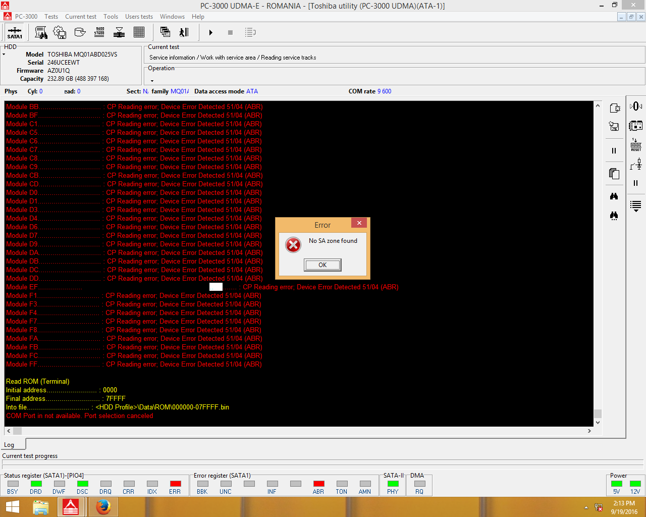

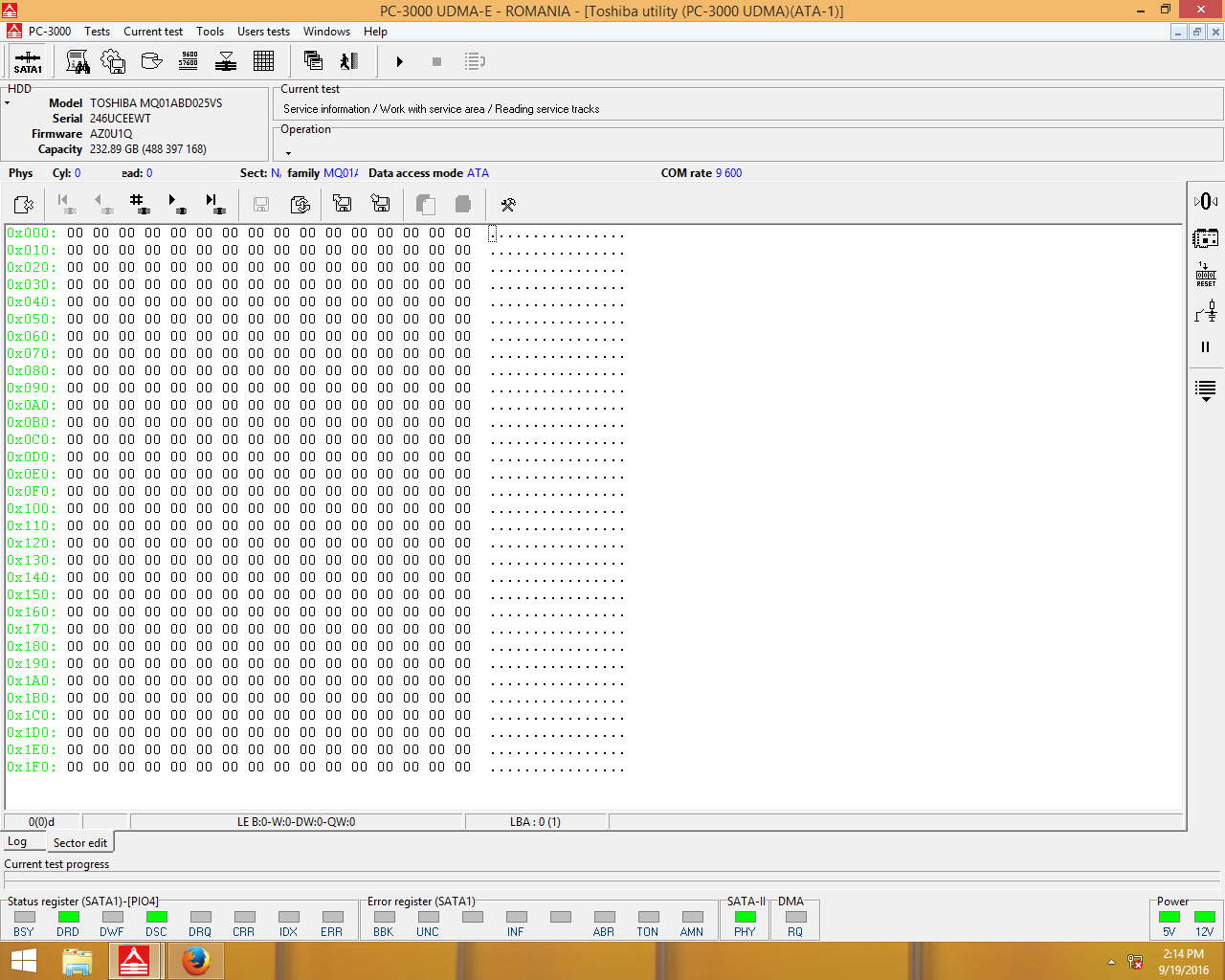

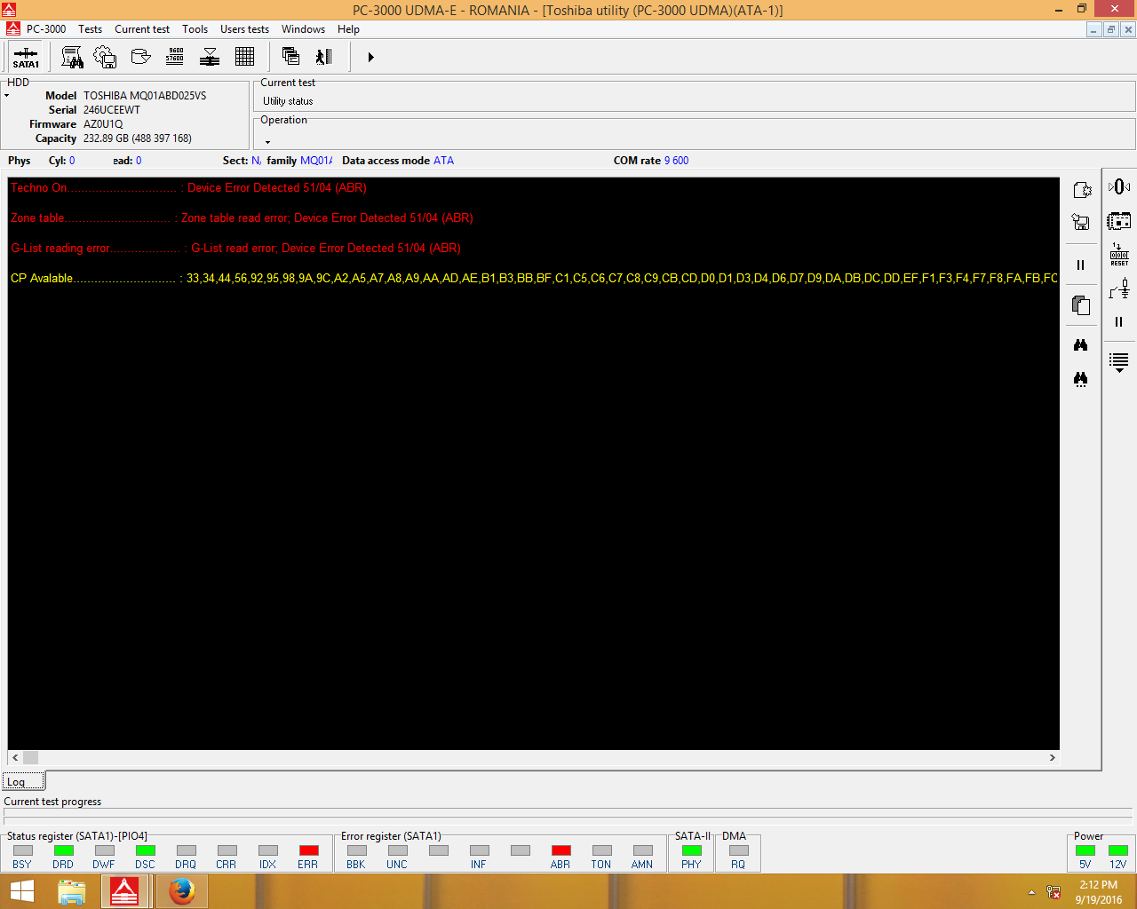

So here are the screenshots from the Toshiba.
Quite interestingly, I do actually have sector acces and can write/read the sectors in user LBA, but that is the only things which you can edit. Everything else goes in that ABR error.
The most important notice, however, is the fact that the drive is detected automatically and it's ID IS read together with it's serial and firmware version. Yet if you look down below, the no. of cylinders is 0 and head also 0 with SPA numbered to N ( wth ? ). This implies that during it's power up you do have acces to the CP's ( at least CP 56 which holds the ID/serial/fw version), and you do have acces to user LBA, meaning you can write/read off the drive. Somehow, it doesn't sucessfully read the drive parameters though ( it doesn't recognize the no. of cylinders, spa , heads blah blah), meaning that the ROM itself is modified, not the CP's.
