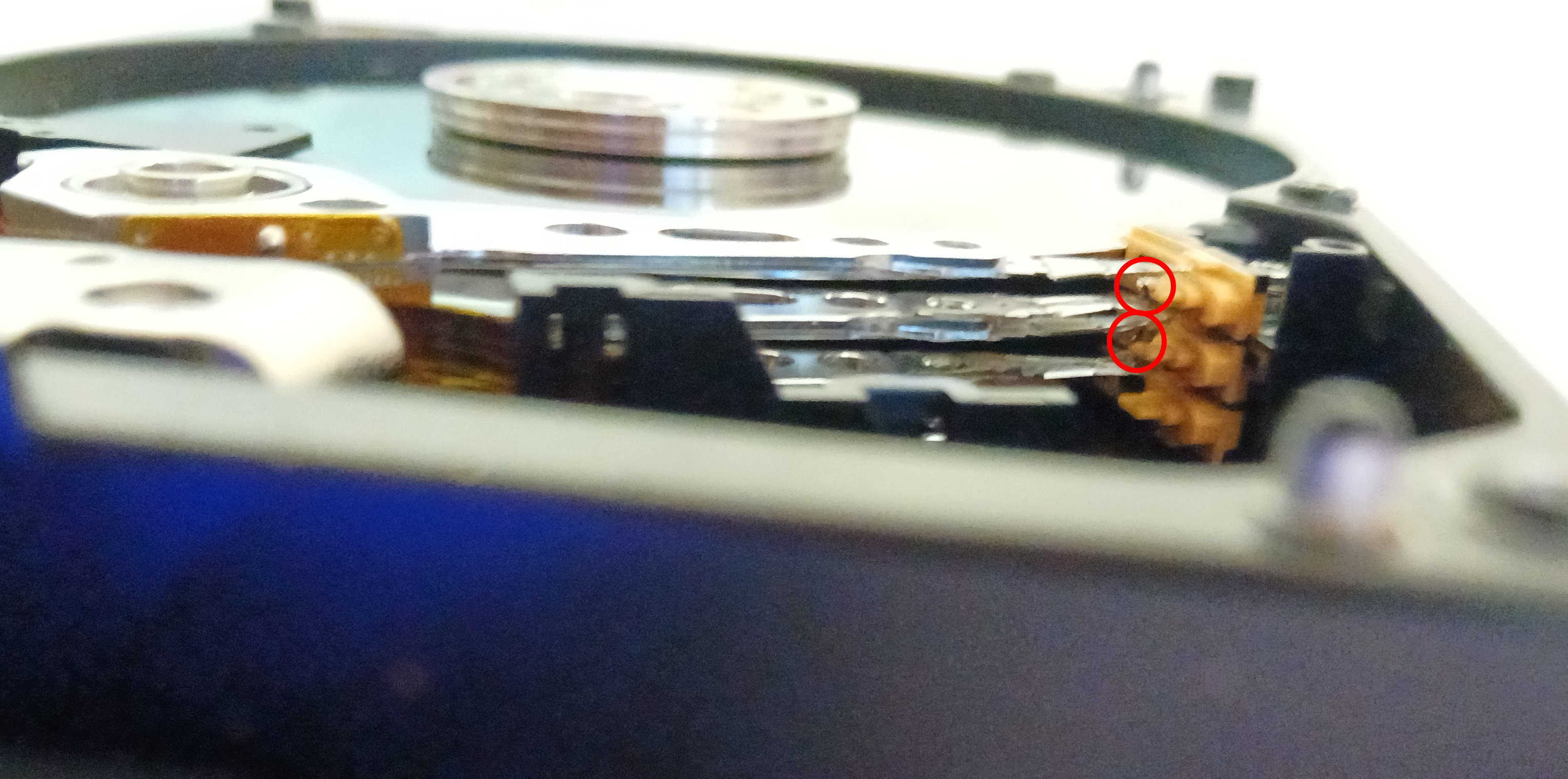

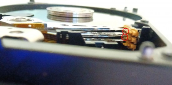

I looked through your thread - the reason the drive isn't booting is damaged sliders (I haven't seen anyone clearly point this out).
WD SMR drives won't boot with a damaged head block.
The nature of the damage suggests physical damage, not a glass of water...
Unless the head damage occurred AFTER you interfered.
You write that the MCU (1) is heating up - to what temperature?
@chrispitt76: "2. What do you think of OnTrack's quote?"
No company will give you an accurate quote over the phone, especially after what you did to the drive.
