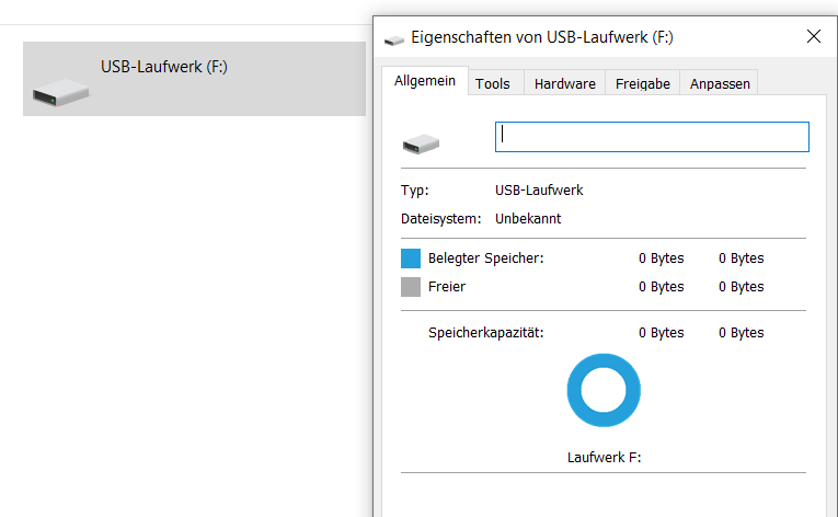

I tested the patched ROM and now I have access to the terminal after pressing Ctrl + Z. :D :D
I tried to init the NAND with "/O and I" but after reconnecting the SSHD Windows still says "No media".
This is the terminal output:
Request spin / disc table recovery
ASCII Diag mode
F3 T>/O
F3 O>I
ALF Parametric Tables Preserved
Flash was erased and ALF Tables have successfully been initialized
F3 O>

Is the drive seen in the bios and is it shown as the correct size.

No, I don't see it in the BIOS and Windows shows the drive only with 0 bytes.

after initialization NAND, you need to write the native ROM

But the drive is ID'd correctly? I thought it would have given the full drive metrics and just blocked UA access. As Tomset say rewrite the original patient ROM back and give it a power cycle.

The drive is also not properly identified.
This is a screenshot from the windows explorer (in German).
I'll change the ROM again right now.

Lardman and Tomset,
Yes, wow it worked. :D :D
I changed the ROM again to the original patient ROM and after reconnecting the SSHD, I have all data back.
Thank you soooooooooo much.
I've been busy with this hard drive for an extremely long time and now it worked.
You really helped me alot.
Many Thanks. :D :D :mrgreen: :mrgreen: :D :D
