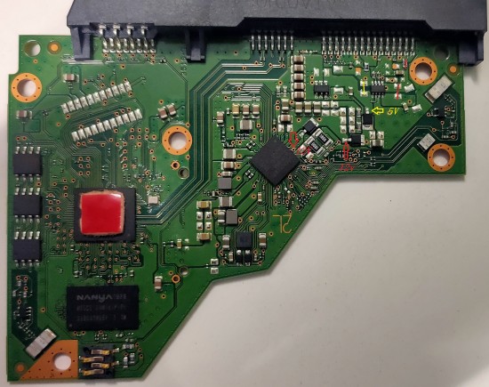

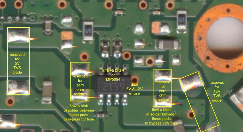

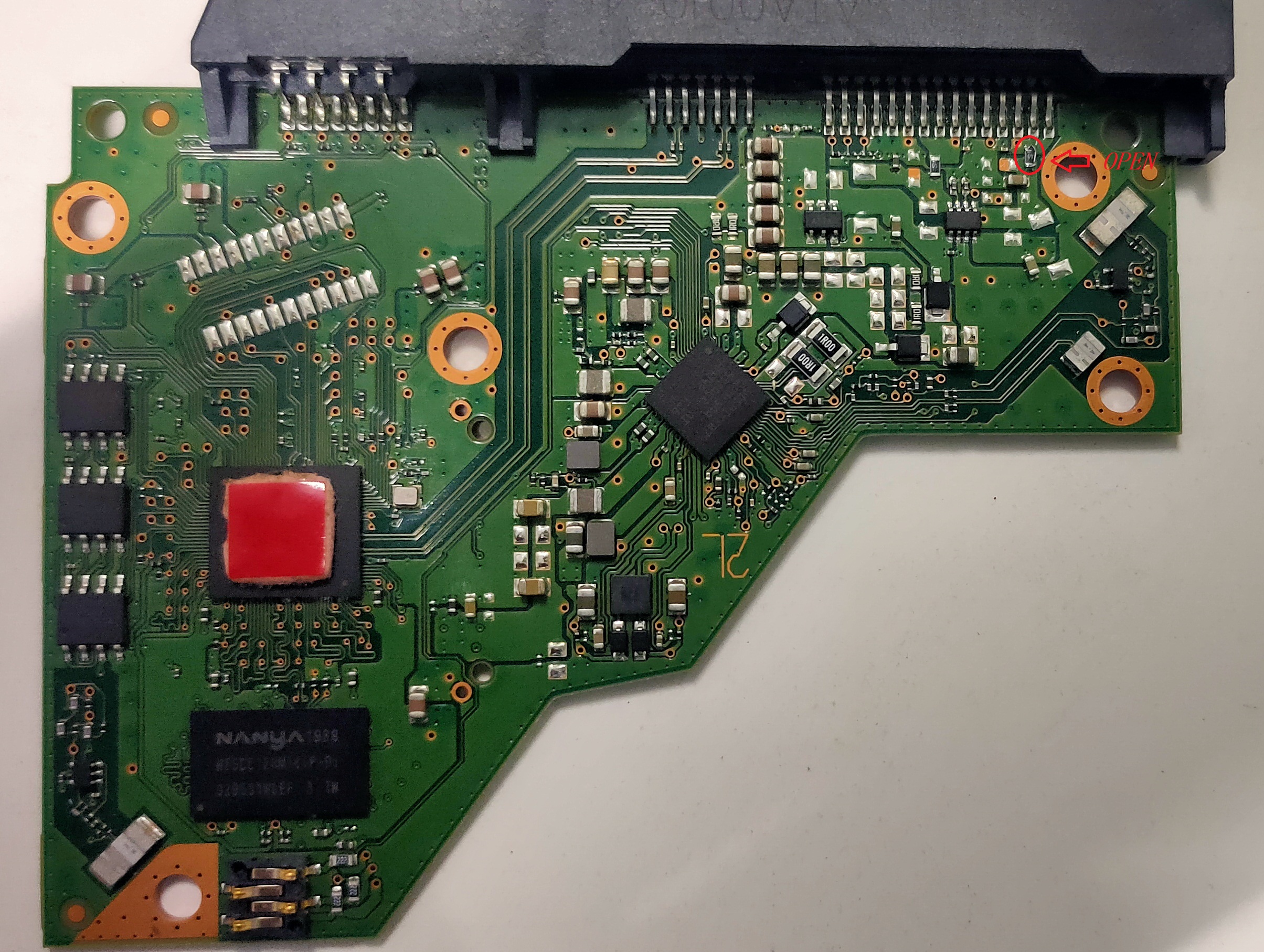

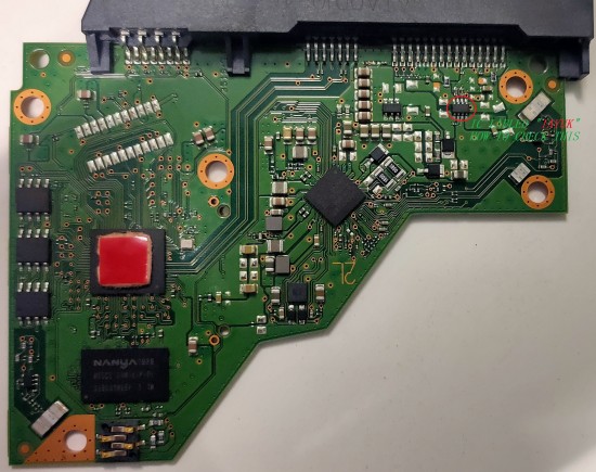

Due to Wrong Power Supply external WDC not working. In this
HDD: WD40EDAZ With PCB 2060-810011-001 P1
12V Fuse opened.
I can not find TVS Diode in this PCB. After Jumper HDD is not Power up.
I have no other PCB So trying to fix this PCB.
How to Trace Further? Pls HELP

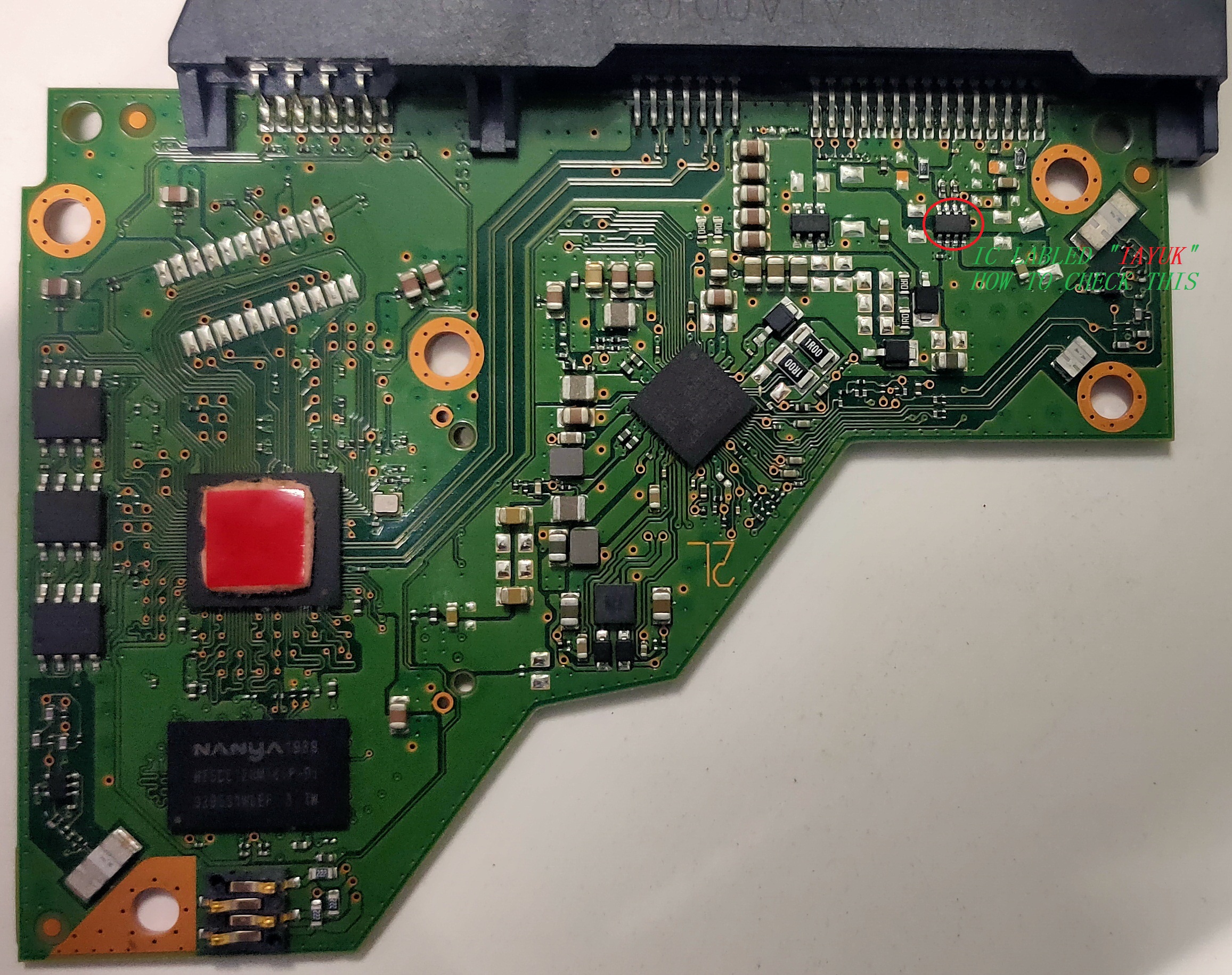

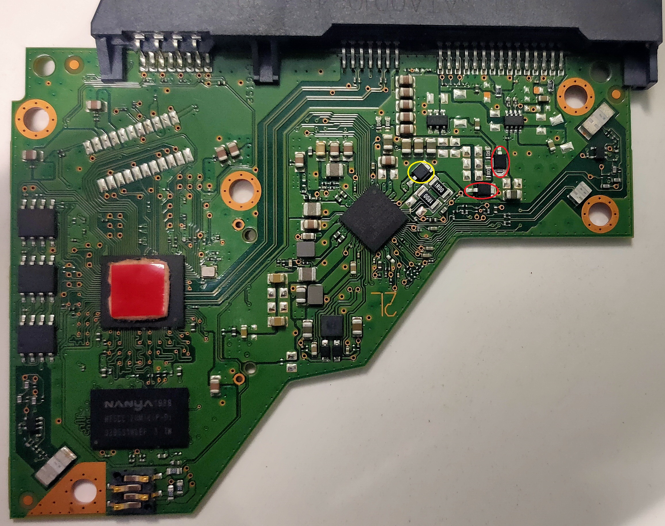

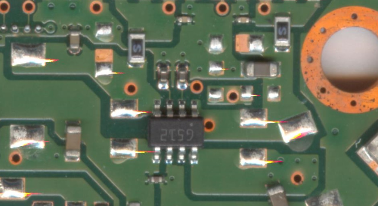

The marked IC Named "iayuk" what is this IC and its Function?

The G512 is electronic fuse.
https://www.st.com/resource/en/datasheet/stef512gr.pdf

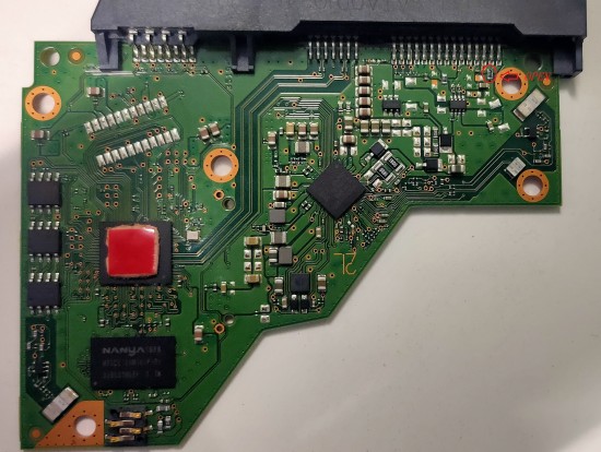

 Post subject: Re: WRONG VOLTAGE - WDC 2060-810011-001 P1
PostPosted: July 17th, 2021, 13:45
Posts: 17314

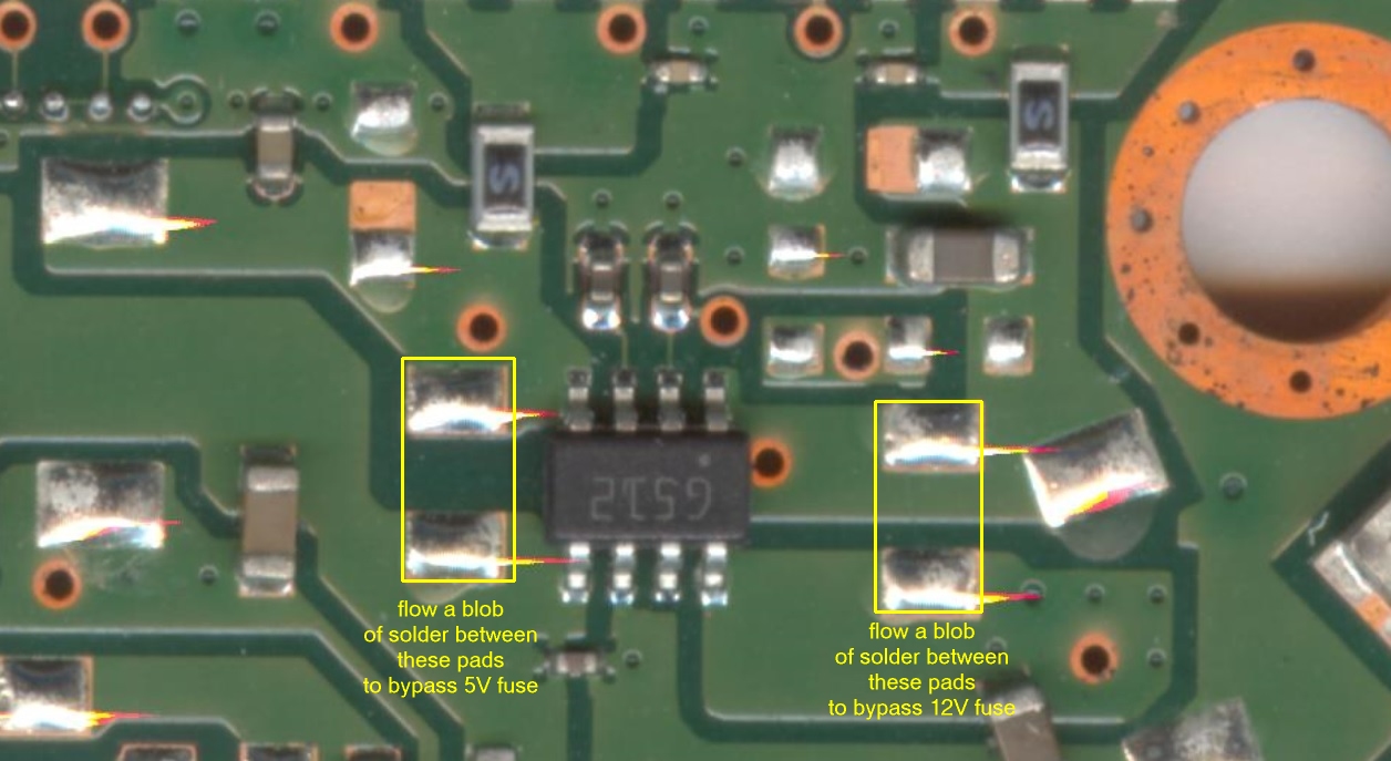

Si3456DDV, Vishay Siliconix, N-Ch MOSFET, 30V, 6.3A, 6-TSOP, marking AYxxx:
https://www.vishay.com/docs/69075/si3456dd.pdf

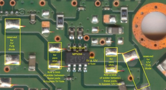

You can bypass the e-fuse (G512) if there are no other faults. I can help you test for shorts, if you want.

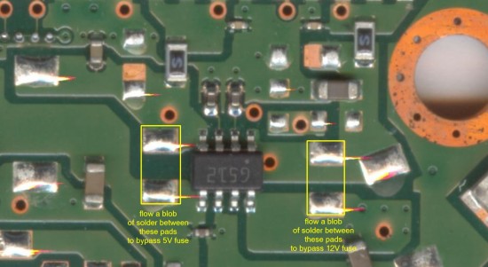

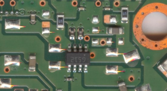

These are the bypass points.

Tried this bypass but NO SPIN UP

Did you measure the input and output voltages? Was the e-fuse bad?
Did you also bridge the open fuse on the 12V input?

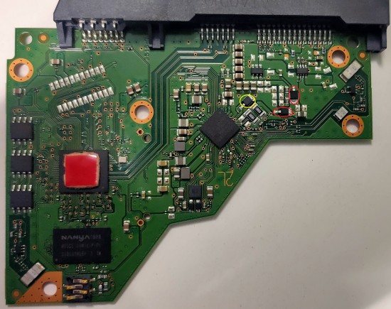

Red Colored - NO Continuity
Yellow " - Shows Continuity
All these Three IC marked as "936 IL2"
PostPosted: July 18th, 2021, 12:57
Posts: 17314
I don't understand why you are focussing on 3 diodes. I would think that the first obvious thing to do would be to tests for shorts to ground at the 12V input and output pins of the e-fuse. See pins 1 and 8 on page 3 of the datasheet.

no short in 12v rail.

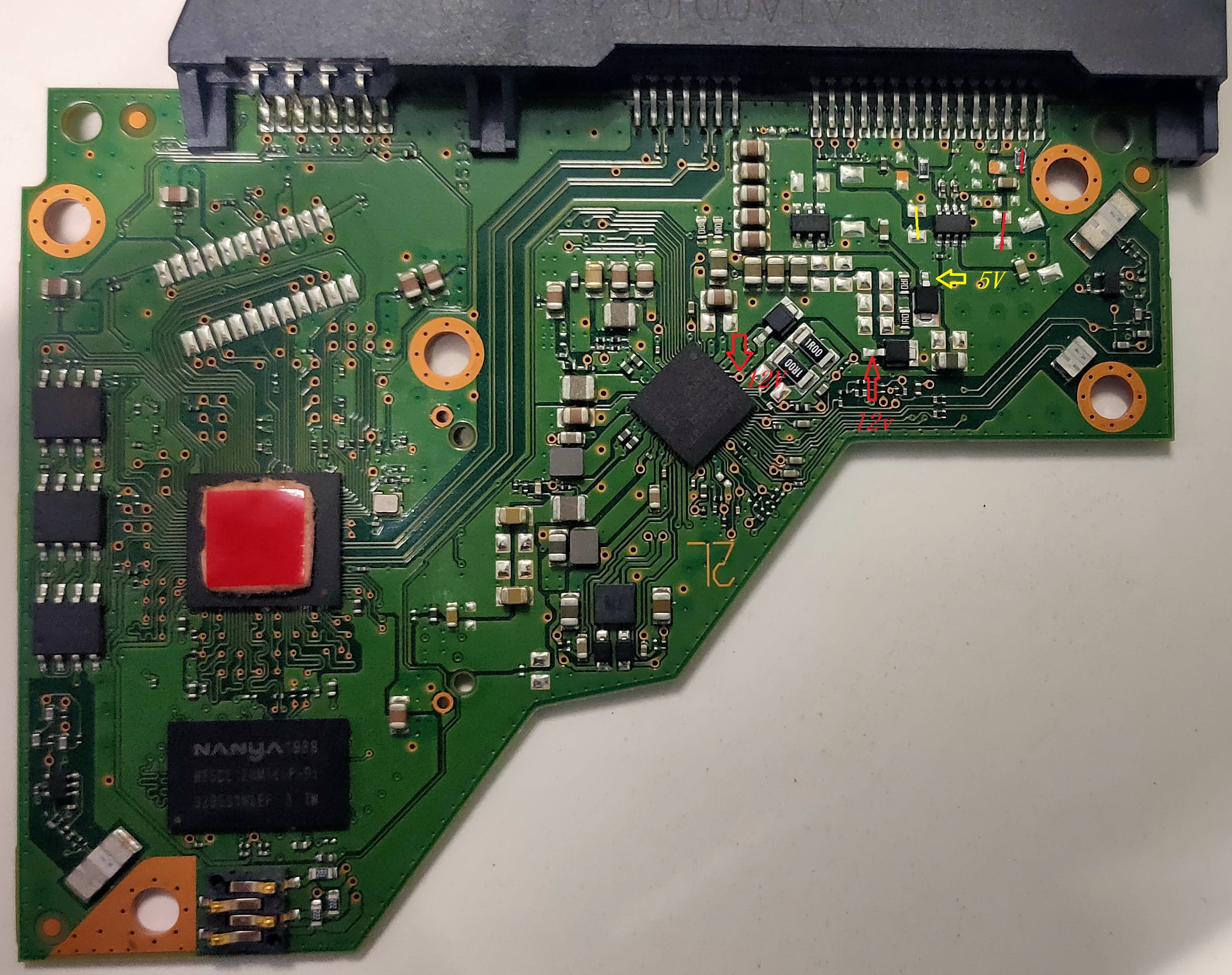

Bypassed e-fuse and jumpered 12v fuse. HDD is not spinning

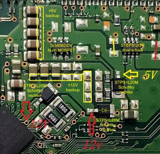

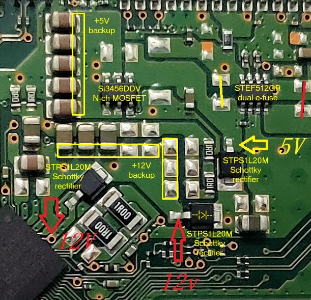

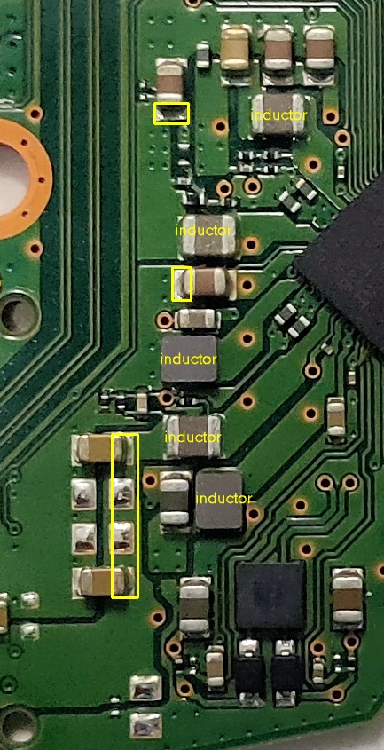

Those diodes appear to be part of a power loss data protection circuit.
STPS1L20M, STMicroelectronics, low power drop Schottky rectifier, 1A, 20V, 0.37 Vf, marking 1L2, DO216-AA:
https://www.st.com/resource/en/datasheet/stps1l20m.pdf

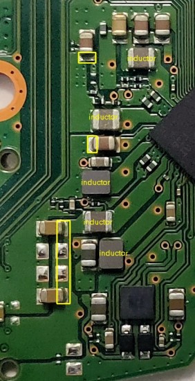

You should see a +5V backup voltage on the bank of capacitors to the left of the Si3456DDV MOSFET.

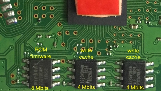

There are several inductors in the vicinity of the motor controller. These will be the low voltage supplies for the controller, SDRAM and ROMs. I would measure the voltages at these inductors. That would tell you if the motor controller is working, at least partially.
I suspect that two of the "ROMs" would contain cached write data while the third would be the actual firmware ROM. The drive would save the SDRAM data to the two ROM caches in the event of power loss. This seems to be common practice in SMR drives.
IS25WD040, ISSI, Serial Flash Memory, 80 MHz Dual-Output SPI Bus, 512K x 8 (4 Mbit), 1.65V – 1.95V, 8-pin:
http://www.issi.com/WW/pdf/25WD020-040.pdf
Please note that much of this is just conjecture, so you may find that I've misinterpreted some aspects of this PCB.

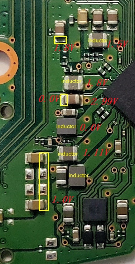

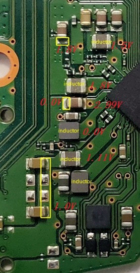

The motor controller appears to be producing all the correct voltages -- +1.5V, +1.8V, -3V, +1.11V, +1.0V.
The negative supply for the preamp now appears to be -3V rather than -5V as in earlier designs. Also, the freewheeling diode is now inside the motor controller, so this regulator is now harder to visually distinguish from the other buck converters.
Sorry, but I can't see what is wrong with this PCB. Could it be configured to power up in standby (PUIS)? Is the PCB detected by your tool or your software?

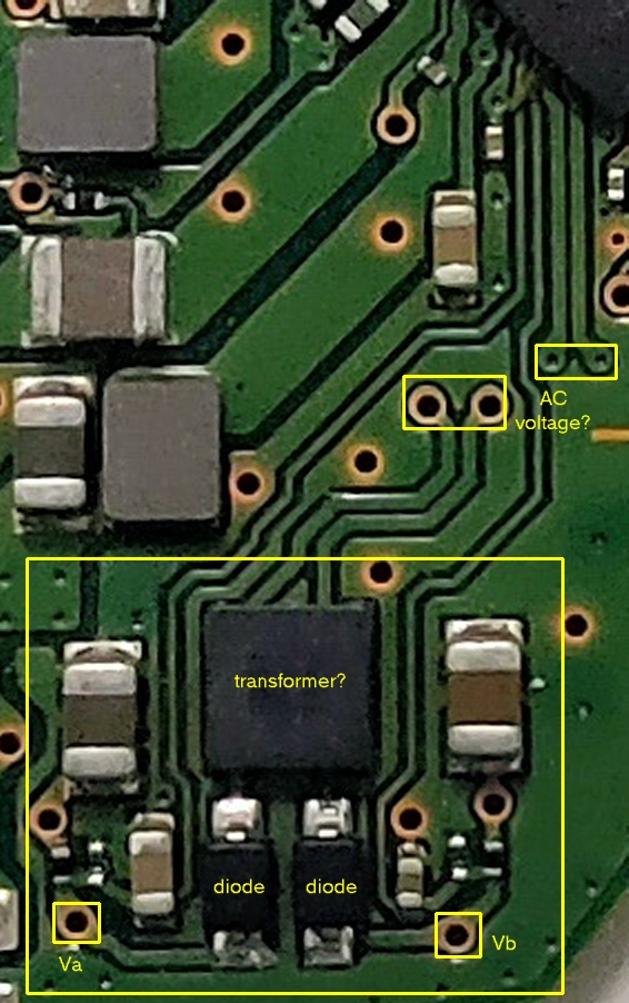

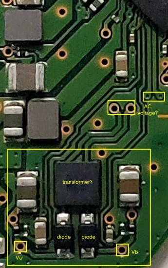

This is a wild guess, but I'm wondering whether this is the supply for the piezoactuator on the headstack.
Va and Vb would be the positive and negative voltages for the piezotransducer. Would it be worth checking?
I don't think the 2 other EEPROMS are for caching data.

Could we see a ROM dump?
