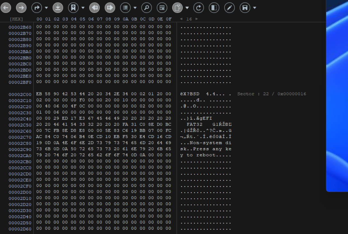

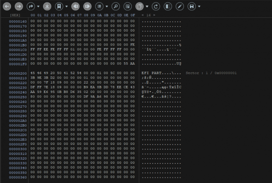

Hi, i have the LaCie 20TB with 2x Seagate 10TB drive, whose history is taken into account by the video hardware (MacOS), and the current version is normal, but it can't be done. Attempting to RAID 0 it in UFS gives results such as light ExFAT partitions, light structured files, and instead of video files recovered from the drive, unfortunately, they don't play safely. I've tried multiple stripe size applications, but the result is the same. I conclude that I'm doing something wrong. First, I need to check if this is really RAID 0. Below is the first data returned on both drives.

The partition info would be in sectors 2 - 33. It would be best to provide binary data, not a screenshot.

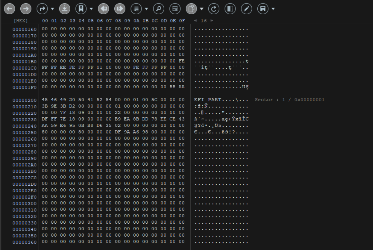

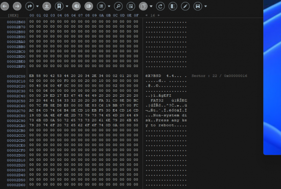

You are 100 percent right, these are the first sectors from 0 to 32 of both disks

I think the stripe size is 24 sectors.

Pi0tr is our colleague from Poland, we connected remotely and checked the array.
The root folder of the exFAT partition was corrupted, but 7 TB of data and its structure are working after scanning the index.
The LaCie configuration is custom, stripe size is 4KB, grid pattern D1, D3, D2, D4.
RDL configuration for UFS:
stripes(8,2) {
1,2;
1,2;
Configuration for R-Studio:
RAID 0
Number of rows: 2
Block size: 4KB
