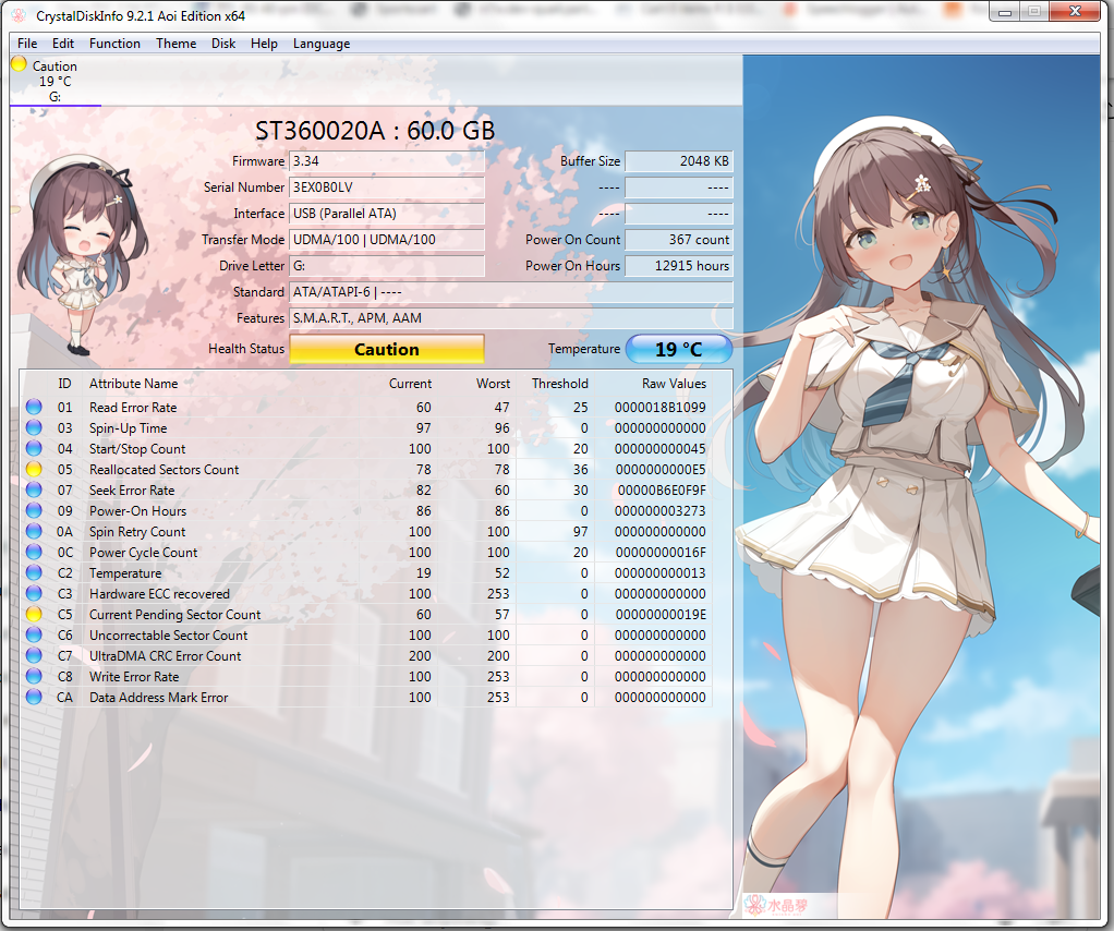

Sounds like the disk is rather old and probably well past its useful service life.
If you can post a screenshot of CrystalDiskInfo it might shed some light on the disk condition
Sure, here it is:
