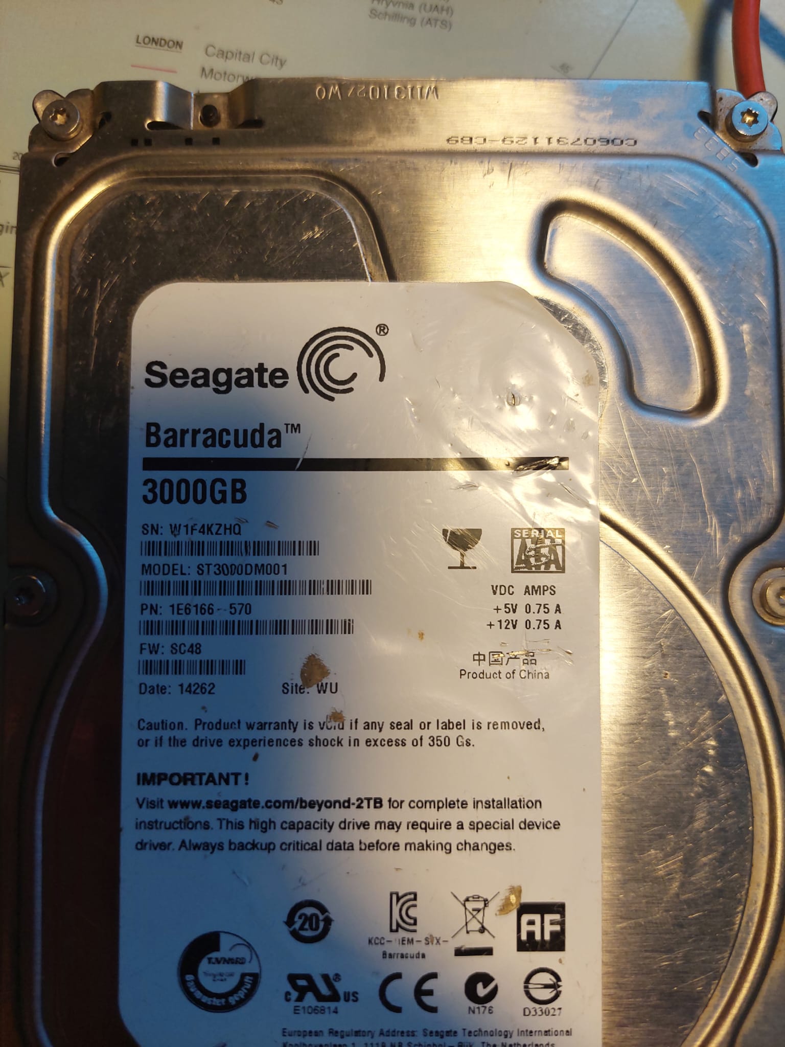

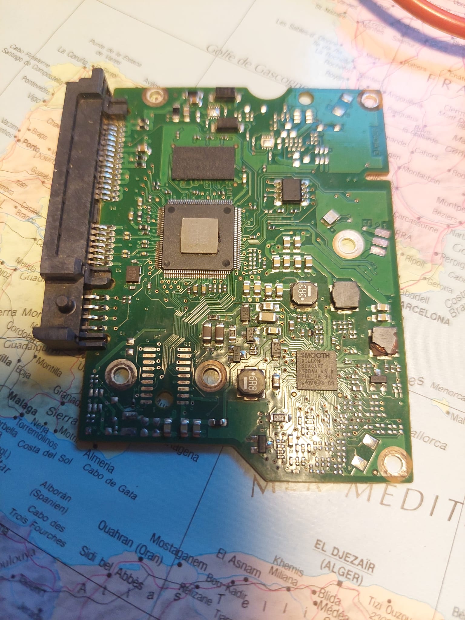

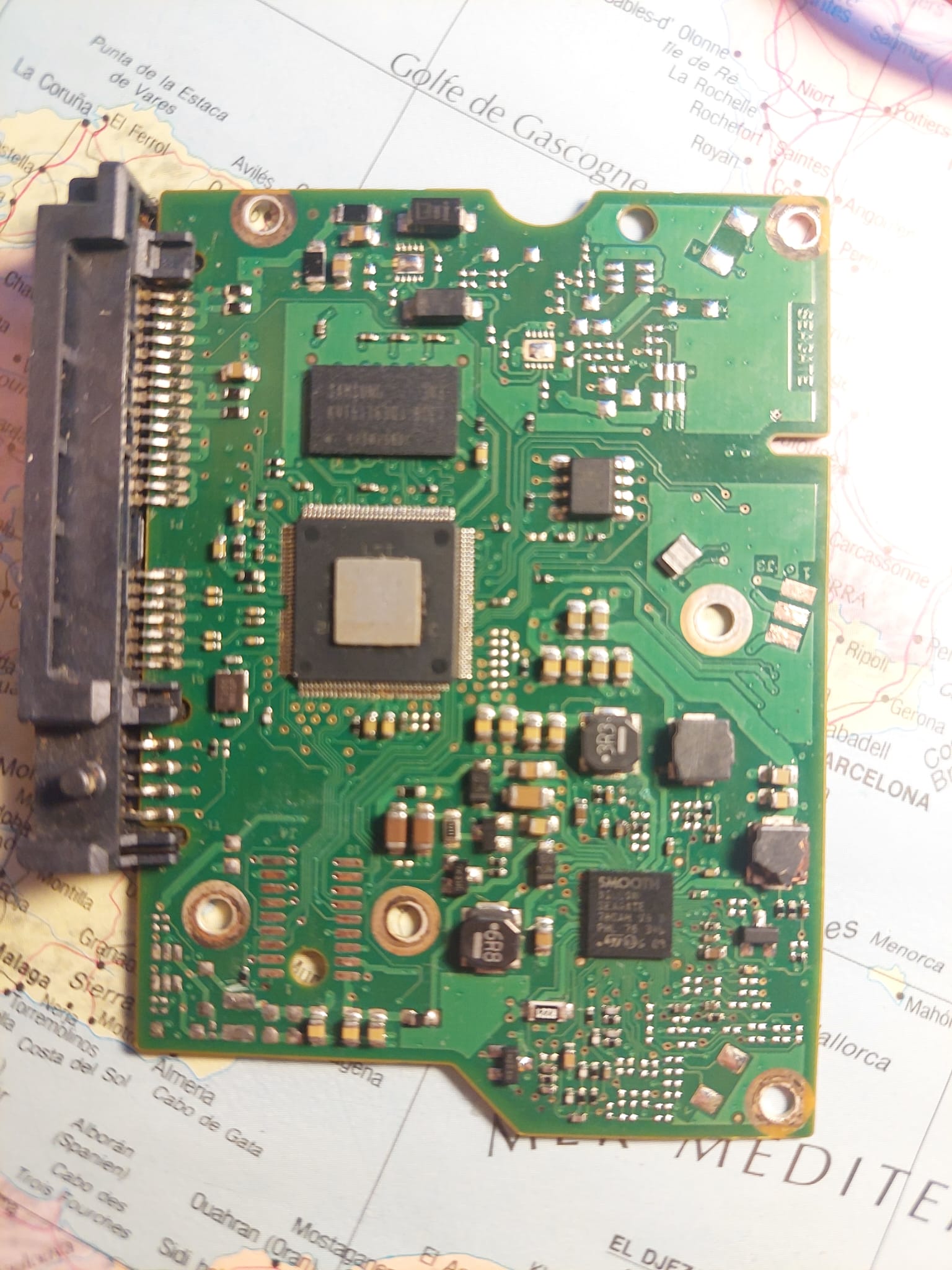

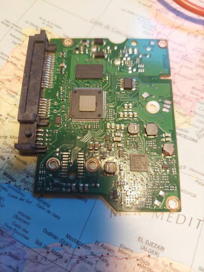

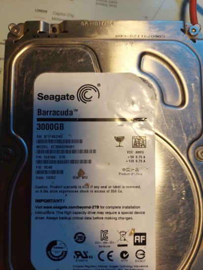

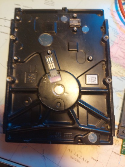

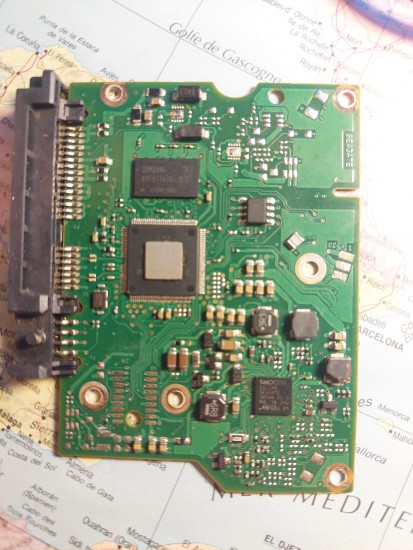

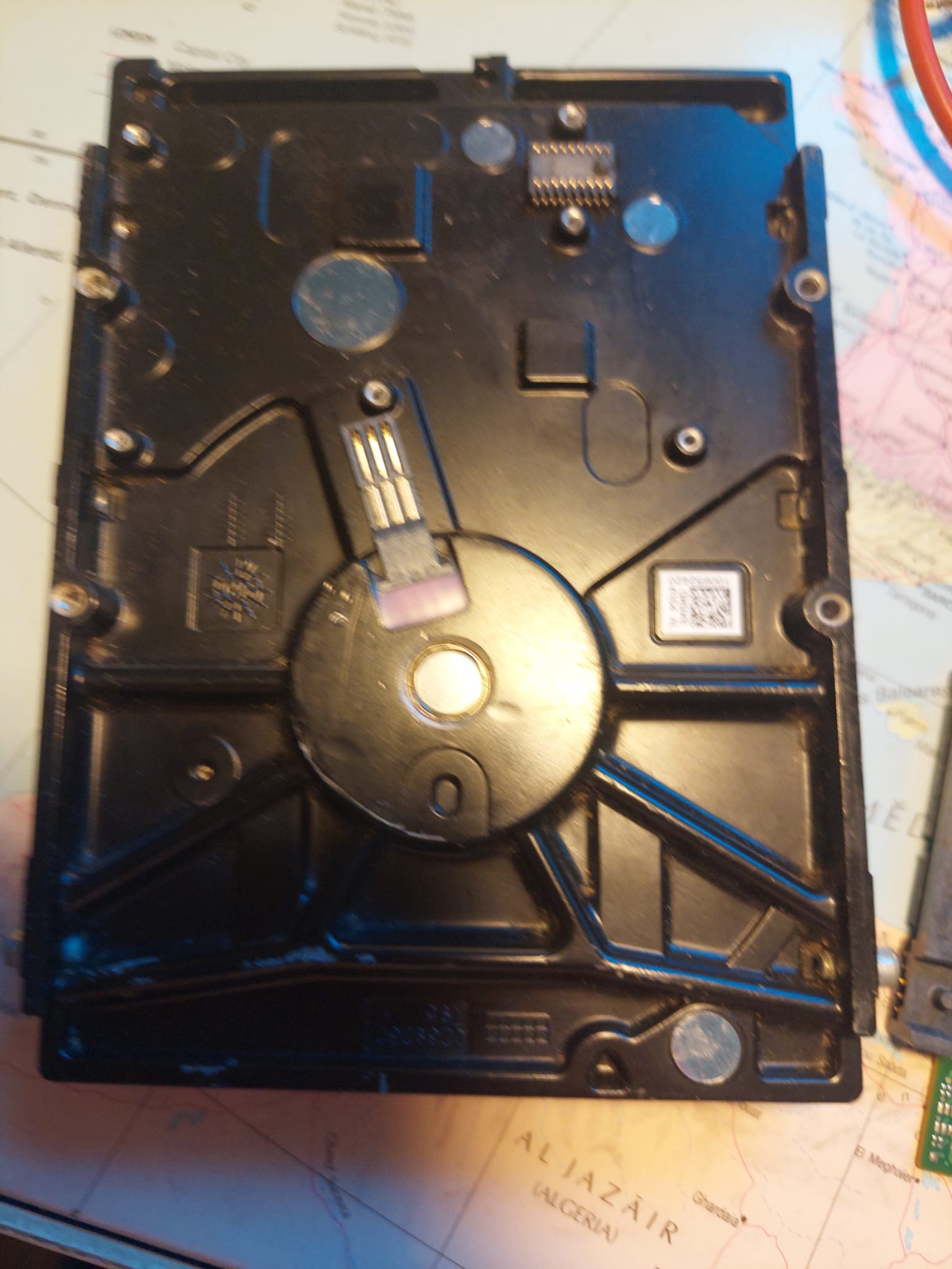

Hi everyone,
I am a student currently working on a personal project for educational purposes. I've recovered an old Seagate Barracuda ST3000DM001 (P/N: 1E6166-570) that is not working, and I am using this as an opportunity to learn basic electronic diagnostics.
To be completely transparent, I have no formal electronics training. I am working with an old multimeter and an old oscilloscope, and I am trying to learn how to troubleshoot a PCB. I have attached a few photos of the board.
Here is what I have observed so far:
Power: 12V and 5V are correctly reaching the PCB via the SATA connector.
Motor: The motor does not spin at all (no sound). When I probe the 3 motor pins (downstream from the SMOOTH chip) with my oscilloscope, the signal remains flat while the PCB is powered.
Components: I tried checking the 12V and 5V TVS diodes with my multimeter. They appear "OK" based on my basic readings, but I am not entirely confident in my methodology. Is there a better way to test them, perhaps using an oscilloscope?
What are the "must-check" points on this specific model?
Are there any common failure points known for this board that I should inspect with my multimeter?
Should I be actively hunting for shorts?
Any guidance or tips to help me progress in this diagnostic would be greatly appreciated. Thank you in advance for your help and for your indulgence with a complete beginner.

What voltages do you measure across each of the two TVS diodes?

Next to the SMOOTH chip, there are large gray coils with two terminals. They should show something, about a volt or more. If all coils show 0 volts, it's worth checking whether the voltage is reaching the TVS diodes. Repairing such boards usually ends with removing the diodes shorted by voltage surges and replacing the burnt-out resistors near the power connector with jumper wires. If the drive still refuses to spin up, the board is usually thrown in the trash and replaced with a working one from a donor drive. No one thoroughly examines these boards, so you'll have to be the first.
There's also an 8-pin chip on the board; this is a ROM. One of its contacts should show 2.5 or 1.8 volts. If the contents of this chip are erased or damaged, the drive also won't spin up.
Judging by the obvious mechanical damage to the board (one of the inductors is broken), this board will never work again - perhaps the contacts under the smooch chip were broken by impact.
I'd also like to point out that these boards have very few components. You can check the capacitors for shorts and measure the resistors (ideally, using another similar, working board as a reference). However, they rarely fail. If the SMOOTH chip had accessible pins, you could measure their resistance relative to a similar chip on another, working board. But that's not the case.
I beg to differ. The board will still work if the coil is not open circuit.
The group of 3 coils are associated with buck converters for Vcore and Vio. The 6R8 coil and the associated diode (E0/U4) constitute the negative supply (-5v) for the preamp.

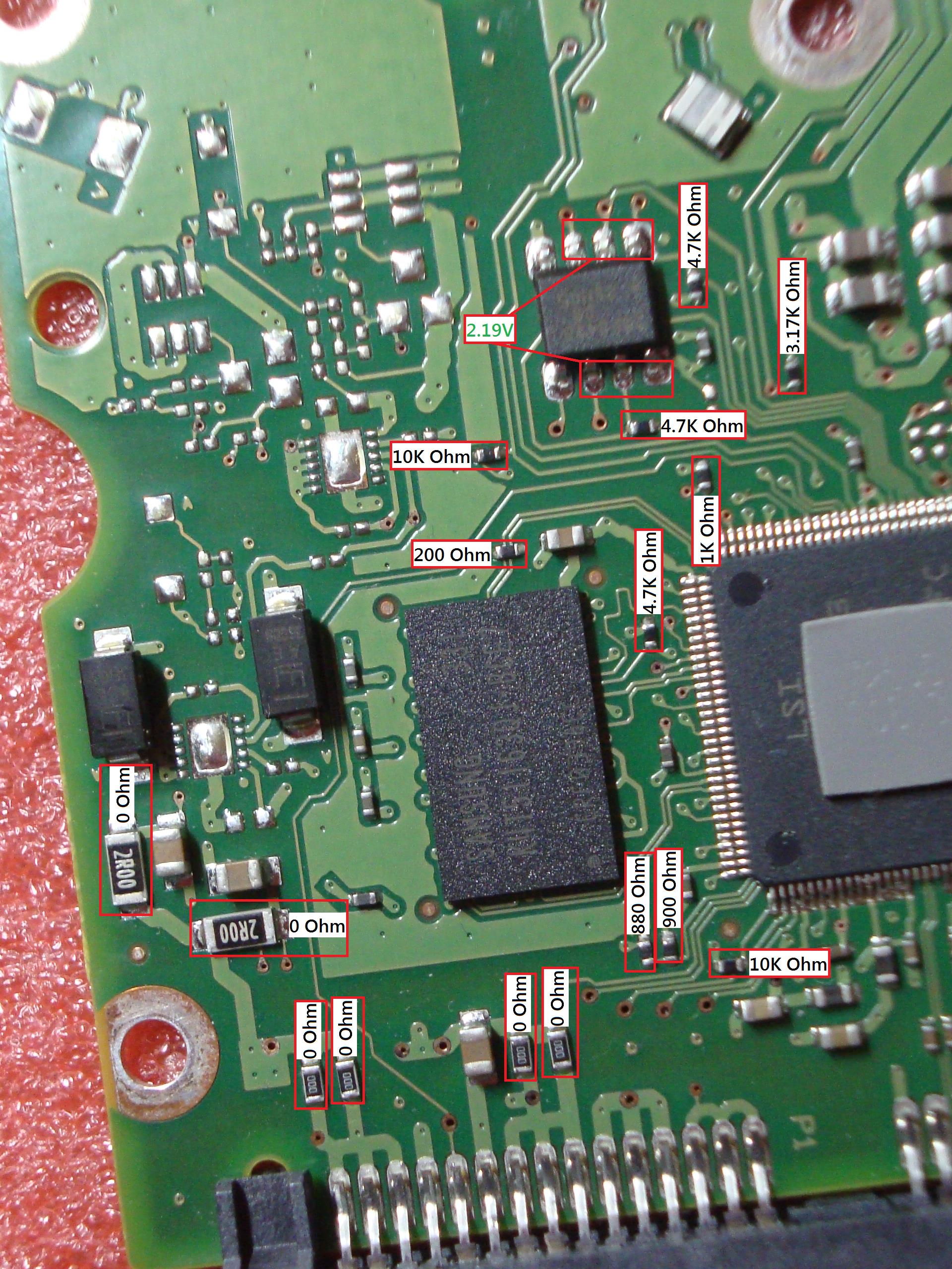

Thank you for the guidance — here is my full set of measurements. I am using an old Metrix MX1 multimeter and a 2000s-era oscilloscope, so please treat these values as approximate.
Coils continuity (unpowered, diode/ohm mode): All 4 black coils beep, indicating continuity on all of them, including the visibly damaged one. Electrically, the windings appear intact (not open).
Coils voltage (powered): 0V on the two unmarked coils and on the "6R8" coil; only ~300mV on the "3R3" coil.
TVS diodes (unpowered): OL in one direction, ~200Ω in the other, identical for both TVS (see attached TVS_1 / TVS_2). When powered, I measure approximately 5.02V and 12.4V across them respectively.
ROM (8-pin, powered): Two pins around 600mV, one at approximately 400mV, the rest at 0V (with noise). None show the expected 1.8V or 2.5V.
Short circuits: No continuity beep between ground and 12V, or ground and 5V.
E0/U4 diodes (unpowered): Open circuit in one direction, ~50Ω in the other (see attached E0_U4_1 / E0_U4_2).
Note: My multimeter beeps in diode mode for these E0/U4 diodes, but does not beep for the TVS diodes. Is this difference normal or does it indicate a specific issue?
What do you think of these results? I hope it's not the SMOOTH chip that's malfunctioning. I've attached a close-up photo of the SMOOTH chip and coils.

It does look like a SMOOTH failure. The most expedient solution would be to move the 8-pin ROM IC to a donor PCB. However, be aware that if you damage this IC, data recovery will become extremely expensive, if it is possible at all. PCB vendors such as hdd-parts.com include a free firmware transfer in the price.

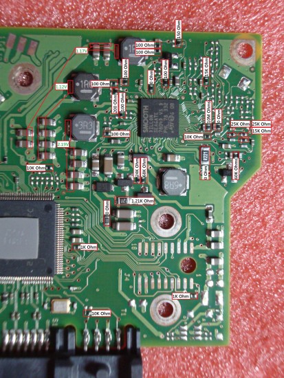

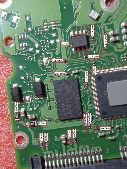

Thanks for your replies. I was hopeful after cleaning that via—which was indeed full of oxidation—but unfortunately, it didn't change anything.

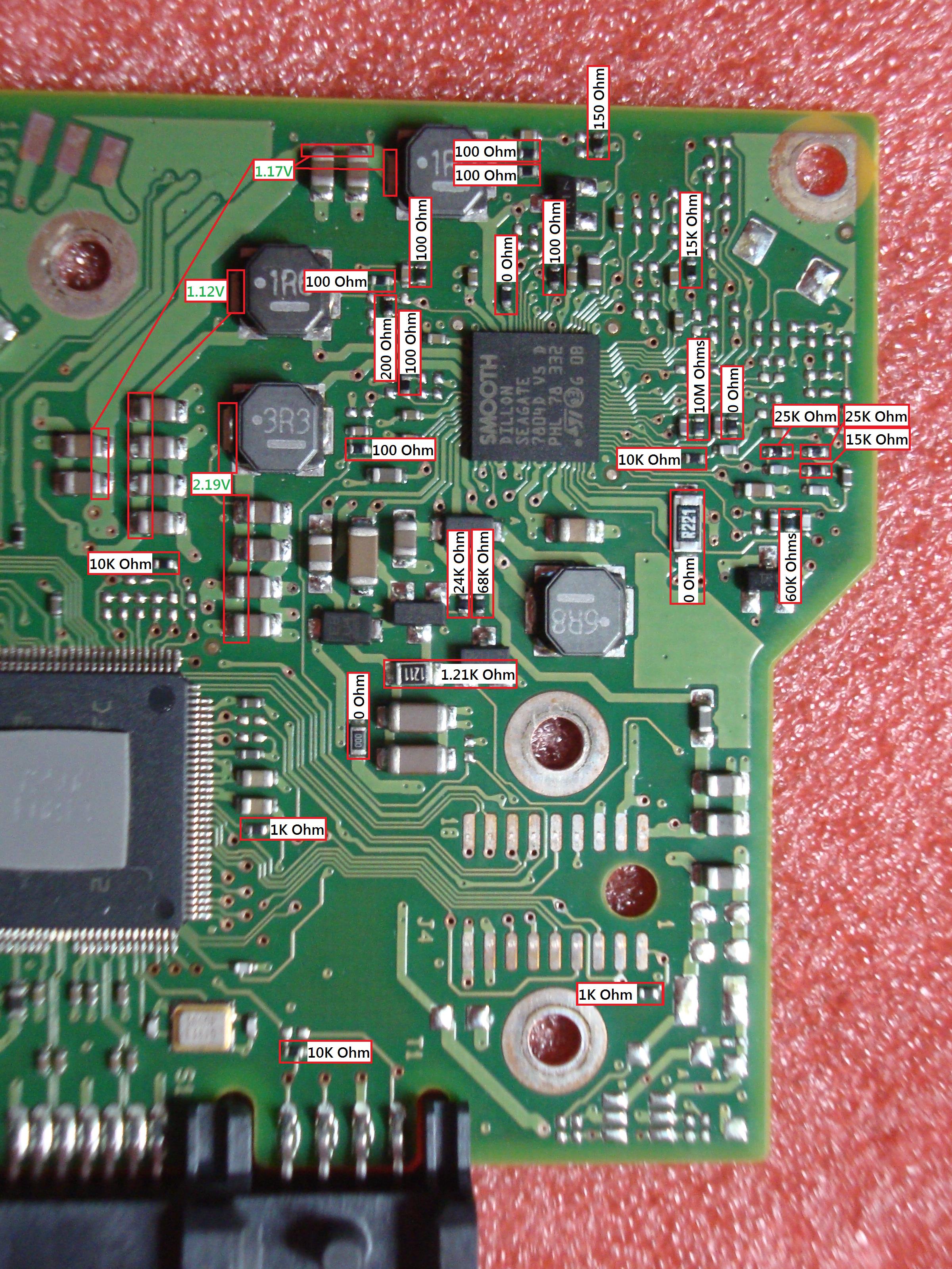

I'm attaching a screenshot of the measurements I retook a little while ago, though I'm not sure they provide much extra information.
Incidentally, the broken coil is starting to come loose. I initially didn't think it was the root cause of the problem since it still passes the continuity test (it beeps). Still, could a damaged coil be the source of the whole issue despite the continuity?
I'm not really sure how to clean the board any further. That via was the only visibly oxidized spot, and the rest seems minor. At this point, it must indeed be a deeper issue with the SMOOTH board, and I think I've reached the limit of what I can test on my end...
Not really. The SMOOTH chip has the necessary voltages near it, but it doesn't output anything. You could also try using an oscilloscope to measure the coils on the contacts facing the chip. If pulses appear briefly there immediately after power is applied to the board, it's still trying to function.
You can try household chemicals, such as a rust and water stain remover (the best solution available for rotted circuit boards), and then wash it with dishwashing liquid. Shake out any remaining water (it will be hidden under the chips) and let the board dry. Considering the board is already completely destroyed, you can freely experiment with it.
Maybe yes, maybe no. Considering the board was rotted and damaged, it was clear without any diagnostics that it was all over. As a bonus, I found an identical working board and measured all the resistances and voltages on it. Keep in mind that my multimeter had a dead battery and the probes were broken, so the readings may be slightly different, especially the voltages. Where the image shows 2.19 volts, it's actually 1.8 volts. And where it's slightly more than a volt, it's actually a volt or slightly lower. You can compare it with your board if you're willing and have the time.

I accidentally missed the answer to this in my post. Yes, it could be the source of the problem, because it's not just a component with copper wire wound into a coil for aesthetic purposes. However, when the gray plastic simply falls off the inductor, the hard drive can usually function in this condition. To rule it out as a possible culprit, it simply needs to be replaced. You can, of course, also check that the coil hasn't fallen off the board by measuring the connection from the capacitors on one side to the three-pin component on the other, but that's definitely not the cause.

The pulses coming to coil 3 afterward turn into those strange 0.3 volts on the ROM chip. Unfortunately, this is also nothing new. I don't have a good understanding of how these converters work, but I do know that the pulses should be much higher in amplitude, since this is a step-down converter, not a boost converter. Fzabkar understands this much better than I do and can tell you what you should see on an oscilloscope. Unfortunately, I don't have one, so I can't help with measurements on a working board.
Since this problem is observed in the circuit where the via has rotted, I would simply resolder it using highly active soldering flux. The oxidation was previously copper plating, and it's possible that a feedback signal is connected from that location somewhere in the inner layer of the board. Or perhaps it's just a via for convenient testing of newly assembled boards at the factory, and it's not connected anywhere.
The only things you can check in this circuit are the capacitors and resistors nearby, which may be part of the voltage monitoring circuit. Other than these, the only other possible source of the fault could be the SMOOTH chip.
It's highly likely that the drive not spinning wasn't the initial cause of its malfunction; this model almost always fails due to damaged heads. The problem that it's no longer spinning is due to it being thrown away and left lying around somewhere. I've encountered a similar problem, but with a very old Western Digital hard drive. In 2024, one of its heads failed, and the drive was put in storage in a shed. This year, it was retrieved and connected to a computer again, but it no longer spinned, and the board showed signs of oxidation. The main damage was near the motor control chip, and the drive had been copied using a board from a similar one.
This problem becomes very difficult to diagnose because this SMOOTH chip isn't a simple voltage converter that starts working immediately after power is applied. It's controlled via a digital bus by the hard drive's microcontroller. Furthermore, there's no documentation for such chips; they're proprietary and, in our case, custom-made for Seagate. Therefore, it is difficult to say which voltages should appear, in what sequence, and under what conditions, without having a similar board and a large amount of professional diagnostic equipment.
 Post subject: Re: [Diagnosis Help] Seagate ST3000DM001 - PCB Power issue
PostPosted: July 22nd, 2026, 21:41
Posts: 17297
Tutorial - Linear and Switchmode Regulators used in HDDs:
https://www.hddoracle.com/viewtopic.php?f=59&t=231
Coils 1,2,3 appear to be associated with buck converters (step-down topology). These provide Vcore and Vio for the MCU, SDRAM and ROM.
Coil 4 appears to be part of an inverting buck-boost topology. This provides -5V for the preamp.
I'm thinking that the PMIC section in the motor controller needs to provide Vcore and Vio supplies for the other ICs. After the MCU unpacks the ROM into SDRAM, it then commands the motor controller to switch on the negative supply.
