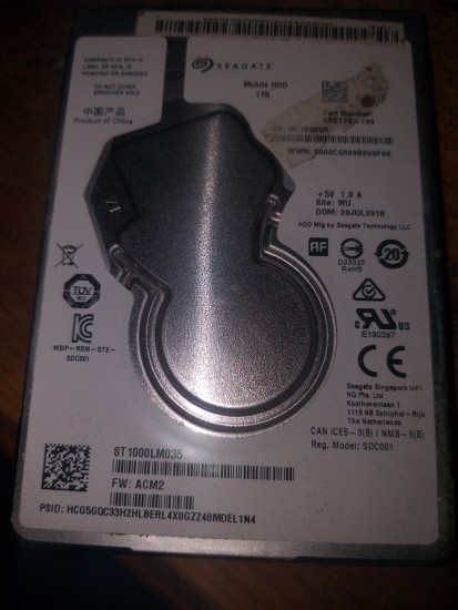

hi my pcb have burnt smooth chip now drive not spin at all my question do pcb rom swap solve the issue or i need remove the controller chip too

You got your answer in the previous topic:
https://forum.hddguru.com/viewtopic.php?f=1&t=46157
The ROM itself is enough.
