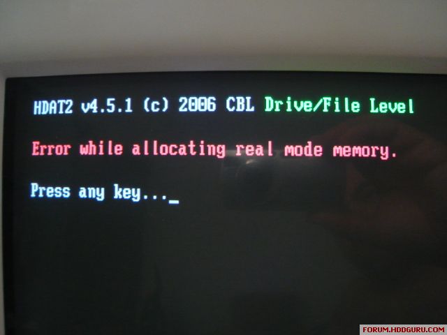

Thnx a lot for trying to help me here.I downloaded HDAT2. But i can run it only in Demo mode. It don't wonna load properly.Will try to post pic with message.
 Post subject:
PostPosted: September 3rd, 2006, 15:37
Joined: September 2nd, 2006, 20:13
Posts: 11
. Here what it does. BIOS Detecting HD.If i reboot and use MHDD or MAXTOR's diagnostic programm, they both work. But not HDAT2. What do i do wrong? Thanx again.
 Post subject:
PostPosted: September 3rd, 2006, 16:18
Try To Download Hiren Boot Cd Ver 8.X ,this Has HDAT And Lots of Other HDD Repairing Software ,Search Google And Yahoo for that ,I Use That Often
