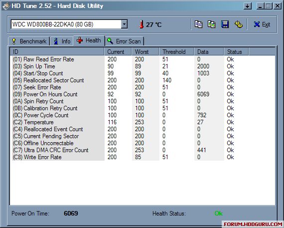

the funny thing is the drive came back to being _WD800BB-22DKA0 I dunno how though, some pix:
is everything normal in the pictures gurus?

Your hard drive has changed its name because the service area is damaged and some information stored there cannot be read. For this reason the drive report the default name stored in a Flash chip on the PCB.

Or may be some modules are damaged ...
But to solve that u need pc3000 no other tool can do that

FIRST you must change ide cable because too many errors .
