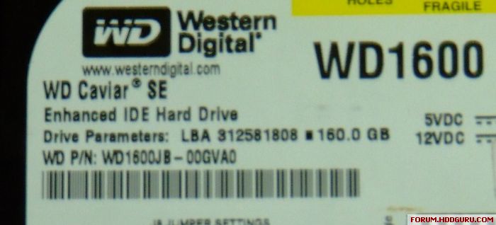

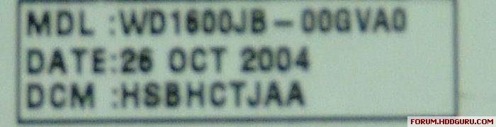

WD1600JB
The user managed somehow to plug the power upside down :shock:
So this mean 12 v in the place of 5 v. Am I right?
The result is in the picture

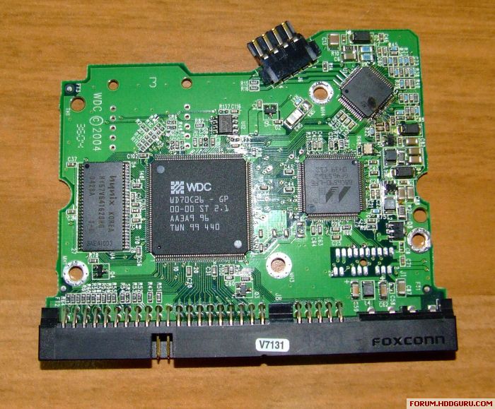

Basicaly I know what I have to do but unfortunately I dont have a good board for this serries. I know this a common serries but ...I dont have...
I have only a board from WD2500JD.
Do you think that is possible to swap the boards and the firmware chip?
Did someone succeded to swap a ATA board with SATA for WD?
I know that this works for some Maxtor.

You also need new heads stack assembly

you can swap a ATA board with SATA for WD.
and you must swap the rom chip too.
i thing the 2060-001267-001 board can fix you HDD

OK . Meanwhile I found one WD1200JB.I will try to swap on Monday.

1st...check that both boards have the same code:
2060-001265-003
2nd...you must swap U12 - serial prom chip !!!!!
without this step no chances that hdd will start to work....

:evil: The Board from WD1200 is

hello if u whant to repair WD hdd u need first Repair PCB
when Replace PCB it is hard to fix

Ok. I found identical board, resolder ROM , but I think something is wrong with preamp or heads becouse the drive is still clicking. I give up with this one. Thank you everyone!
2060-701265-001
What number of board from WD1600?
Exactly same ( 2060-701265-001 )
or not?
