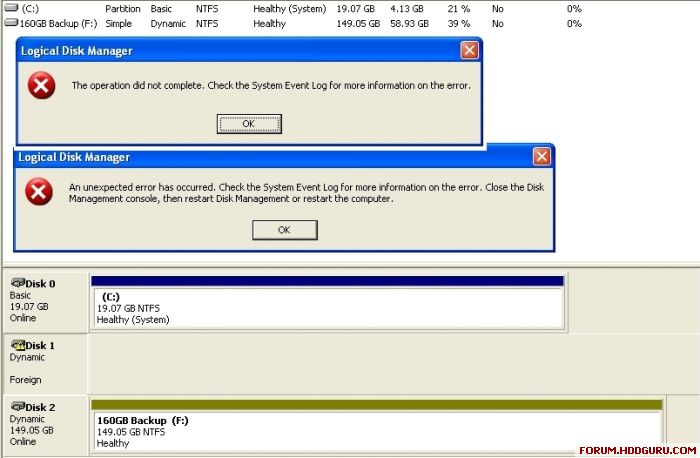

Hello To all of you in the forum,
I am here to discuss with you, about my weird situation. I am having 2 computers at home. Computer A, is an intel-based computer, whereas computer B is an AMD-based computer. In my Computer A, I am having 3 hard disk drives.
The first HDD (Maxtor 2B020H1) is a primary master HDD, which contains a Windows XP professional SP2 inside.
The second 160GB HDD (WDC WD1600JB), is a primary slave HDD, which does not contains system file inside. It is being used as a storage HDD, for keeping my important files such as movies, pictures, songs, company’s data, private data, and etc.
My third 320GB HDD (WDC WD3200JB), is an external HDD, its function is to backup all my important data in it. It connects to my computer using a normal USB2.0 3.5” HD external box.
Both of my Western Digital Caviar HDD were being set as a Dynamic Disk.
Several days ago, I tried to plug out my third 320GB external HDD from computer A, and plug it in to computer B. After copying some files, I clicked on the ‘safely remove hardware’, and intended to safely remove my external HDD from computer B. Unfortunately the external HDD can’t be removed. It said : “The device ‘Generic volume’ cannot be stopped right now. Try stopping the device again” .
I was in a hurry and I didn’t wait for it, and I just plug it out with out clicking the ‘safely remove hardware’ icon. Right after I have done that, when I tried to plug my third HDD into my computer A, it could not be detected.
Usually, when people meet with this kind of situation, they will have to go to the Computer Management area > Disk Management area (Right Click on My Computer icon > Manage > Disk Management ) , to either reactivate the external drive or to import the foreign disk drive into their computer. I always do that without any problem. But this time, it cannot be reactivated neither to be imported into my computer A. I tried that too, in my computer B, still, no hope. I get some error messages which sound like this : “The operation did not complete. Check the System Event Log for more information on the error” & “An unexpected error has occurred. Check the System Event Log for more information on the error. Close the Disk Management console, then restart Disk Management or restart the computer.” (Refer to the image shown below if you don't know what am I talking about)

I am very sorry to miss all of your replies. Thanks for all the contributions and replies posted. I have fixed the problem just several days after my original thread posted above, using the program named : Testdisk-6.6 ...
Since I am having some other hard disk and since I didn't over write the corrupted 320GB HDD with other files, what I did was, first of all, recover my files in the corrupted HDD using some other file-recovering softwares. I backed up all those files in another hard disk.
2nd thing that I did was : Since I have backep up all the stuffs that I wanted, I played around with the 320GB corrupted hard disk. I tried so many 3rd party NTFS/partition table fixing programs, but all of them failed to recover the partition table of my hard disk.
Eventually I came to a program called : Testdisk-6.6 (just GOOGLE it if you want to download the file, and it could have newer version) ... It is a freeware program, and it was being written in DOS mode, a file which is quite small in size, and the most interesting part is, you don't even have to install the program to use it !
In my case, that I have describe in the original post above, what I did was just click on the [testdisk_win] > [Create] > [Select a media and PROCEED] > [Select partition table type & press ENTER] >[ADVANCE] > [select type & Press enter (I forgot what type that I've chosen,sicne I was using Dynamic but not the BASIC type of disk)] ...
To my surprise, it has recovered my hard drive after rebooting my computer, and the whole process only took about 3 to 5 minutes.
To play safe, if you really want to do it like what I did, you can try to download "File Scavenger 3.0", for recovering all of your files and have them backup in another hard drive which is sufficient to backup all those datas (I got all my data , yes i meant 100% of my data being copied to another HDD using this program).
After having your data being backed up, you can then try to play around to fix your corrupted HDD using the program : Testdisk-6.6, if anything happens to the corrupted HDD, you will at least have your data saved on another HDD. If everything goes well, you will then get your data back in a few minutes, on the corrupted HDD.
After fixing my corrupted HDD, I have decided not to convert my HDD type from BASIC to DYNAMIC anymore. I have had this kind of problem for several times previously, whenever I am using a DYNAMIC mode. I know that the transfer rate is so fast when you are using a DYNAMIC mode HDD, but it is so unstable in case of any emergency situation happen, such as power shortage OR sudden rebooting your computer OR improper shut down of your computer etc. The MFT or the partition table or the MBR etc could be easily damaged, when you are in the DYNAMIC mode. I backed up all my files in another HDD, and I formatted and set my HDD as BASIC mode, and I recopy those files back into my newly formatted HDD, and I have tried all kind of improper shut down of my pc, but it still runs smoothly for the Basic mode HDD. But of course on the other hand, the HDD transfer rate is so slow in Basic mode, comparing to the Dynamic Mode.

I followed the same steps above and it worked like a charm! If you are having this trouble, start here. no data was lost and everything is back to normal. I'm also able to swap the HDD between my 2 computers again!

I found your tip worth for a try, kingofkk. Thanks so much. However I'm having some problems to get it right... After [Advance] I select the type and press Enter but then I'm not given any other choices! I'm stucked in this menu "Type select"... Already tried to quit the "Tetsdisk" and reboot the computer but no HDD recover took place... Any ideas?

My problem is solved guys. Not really the way I wanted but at the end the important is I could recover all my 200GB music files. I just bought a new HDD and used "File Scavenger 3.0" to recover into there (thanks so much for the tip kingofkk. It looks a very good tool!). Now I will just reformat the s* old HDD and definitely set it as "basic". Don't want to hear about "dynamic" disks anymore as long as I don't use RAID!!

Poligunus. I am sorry for the late reply. For your case, it might be the same with my 1st time's case. Perhaps The MBR is corrupt, not the partition table. In that case, I used another NTFS/MBR recovery program named : "Active@ Partition Recovery" to fix the problem, and it fixed my HDD in the matter of "SECONDS", not "minute" , LOL !!! Anyway, I am glad that you have recovered your files using the "File Scavenger 3.0" .... I feel happy of being able to help you all out in here.
