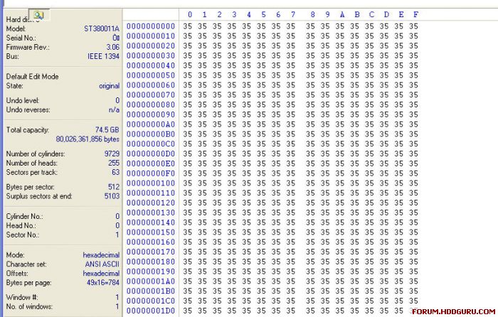

Hi guys, i have a very strange hdds, Lightning strikes Maxtor and Seagate
Blew majority chips and managed to get it up and running again but all data is GONE, when check using mhdd just like a brand new hard drives.
Both hdd detected as usual no errors.
Anyone have any similar event?
:cry:

Here's the winhex shot of the contents. All the way 35h....

Since it is highly unlikely that a lightning strike would actually write to the entire drive , Could the Encode/Decode chip be damaged?
Or possibly the heads aren't actually reading anything , and sending a false signal? Just a thought

It looks like the serial number is displayed wrong also. How does the fw look?

hddguy: Yes fw checked...all good.

Even if lightning could erase all the data it would erase the SA as well. But in your case it's not.
So, there are 2 options:
- corruption to translator which is not likely to happen because you have 2 absolutely different drives with the same problem.
- data was initially rewritten before it was "stricken".

Hi agree with Starling, though it looks like SA was affected as serial # doesn't show either.
Jose winhex shows nothing for entire drive, on both drives?
Really strange as customer sent in drives for recovery, you would think that they would know if drives were empty. DR makes for expensive repair method!

winhex shows nothing for the entire both drives....
 Post subject:
PostPosted: April 25th, 2007, 2:51
Joined: August 31st, 2006, 17:53
Posts: 354
Location: Birmingham, Al
do they both show 35's all the way through?
according to the picture you are connected to firewire .. have you
tried connecting straight to ide interface?

Also , while not normally recommended in data recovery situation ,
you might try writing a single sector of maybe all 1' or 0's and then
reboot and re-read that sector to see if it writes correctly
( I would suggest close to the end or the drive)
