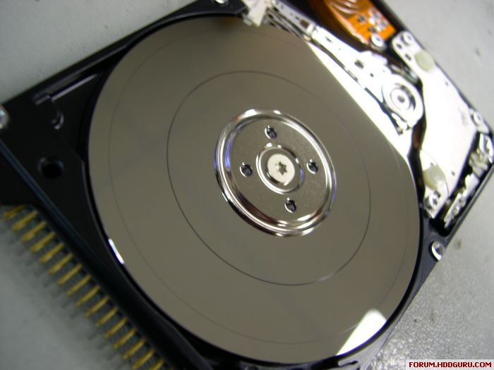

 Post subject: Is it possible to get data from scratch platter? see photos
PostPosted: April 26th, 2007, 23:02
Joined: October 1st, 2006, 6:29
Posts: 107
Just wondering is it possible to get data from this condition, platter scratch
Thank's

nope.. no chances at all ( this is I know so far ).
Hopefully future technology in platter cleaning can solve this problem.

 Post subject: Head Crash
PostPosted: April 27th, 2007, 10:17
Posts: 1517
Location: Mexico
No i heard and have information about MFM Microscope Force Magnetic or STM Scanning Microscope, but this is an idea i dont know any people who work´s on Data Recovery who have more than 1 millon of dollar´s for paid a machine, used on Factory, for Check Surface on test´s
Your head crash, its near the SA zone and user data zone , so if u try perhaps u donnor heads will be damaged again. when the Head crash its on the land zone on 3.5" for example u have a hope to be able to recalibrate and get some of data

Unfortunately, MFM/STM/whateverM won't help here since it will take an eternity to copy several tracks...
 Post subject:
PostPosted: April 27th, 2007, 17:34
Joined: November 15th, 2005, 11:05
Posts: 189
Location: Canada
your right no laser can read magnetic bias that I've heard of. I'd say these platters are toast as you'd likely kill the new heads as soon as they hit the scratches. Even if you could guess well and edit tracks to ignore the scratches you'd still have to go across them with the heads.
It is possible to read magnetic data with laser (for example Seagate Recovery Services can do this)
The problem is - nobody can get data from this magnetic copy (may be in future but not now)
Hi Doomer spent some time searching, I think they use laser to help with positioning, GMR heads are still used for the actual reading.
No you are wrong
Only laser is using for getting magnetic copy
"We often use in house designed and built servo writers with -> laser positioning <- for extreme data recovery situations where conventional techniques fall short."
It is completely different technology
Why I am so sure ? Because I work in SRS and we have device for laser reading, it is possible to get magnetic copy of paltter only with laser but it is still impossible to get data from this copy
